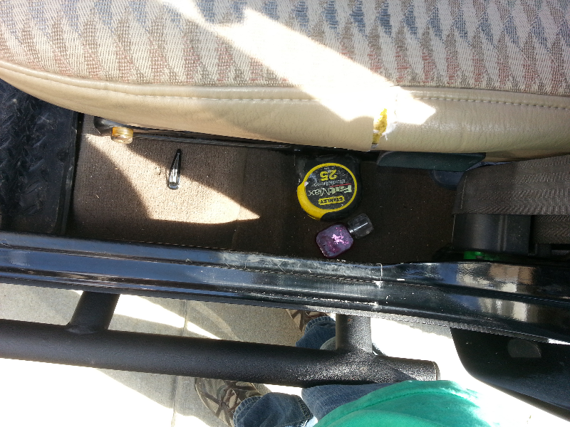

After replacing my seats a couple of weeks ago I noticed they creaked and squeaked whenever I turned, took off from a stop or hit the brakes. I noticed the little bushings were missing on the new seat brackets.
I pulled them off my old seats and put them on the new, problem solved...

In the third pic there is a bolt under the bushing you replaced. That bolt has another bushing that allows the seat to glide forward. When it goes, the seat doesn't glide so easy and the seat will rock back and forth. I could not find a replacement so, I stacked up 4-5 Teflon washers to replace . It lasted a few years and need to be replaced.
Where did you get the bushing you used?
The bushings on the bolts were in good shape I didn't replace them. I pulled the bushing that went over the pin from my original seats...
Sent from my Galaxy Tab
So where did you get them from?
I didn't buy new bushings.
I bought a set of Sahara seats off eBay that had the bases still attached to replace my worn out stockers
After driving around for a week or so the seats made too much noise so I pulled the brushings off my original seats. They were still in good shape so I pried them off to put on the "replacement" seats

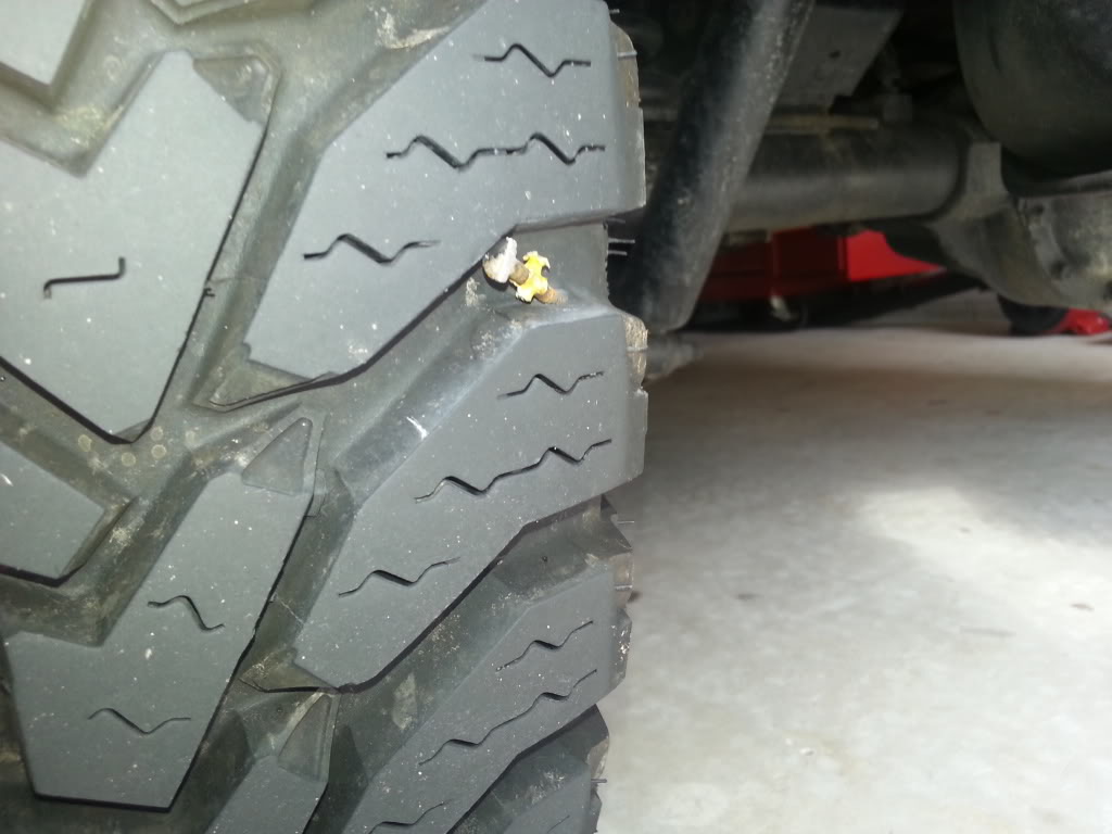

Found a nail in my tire, luckily it only went in the tread and didn't puncture...

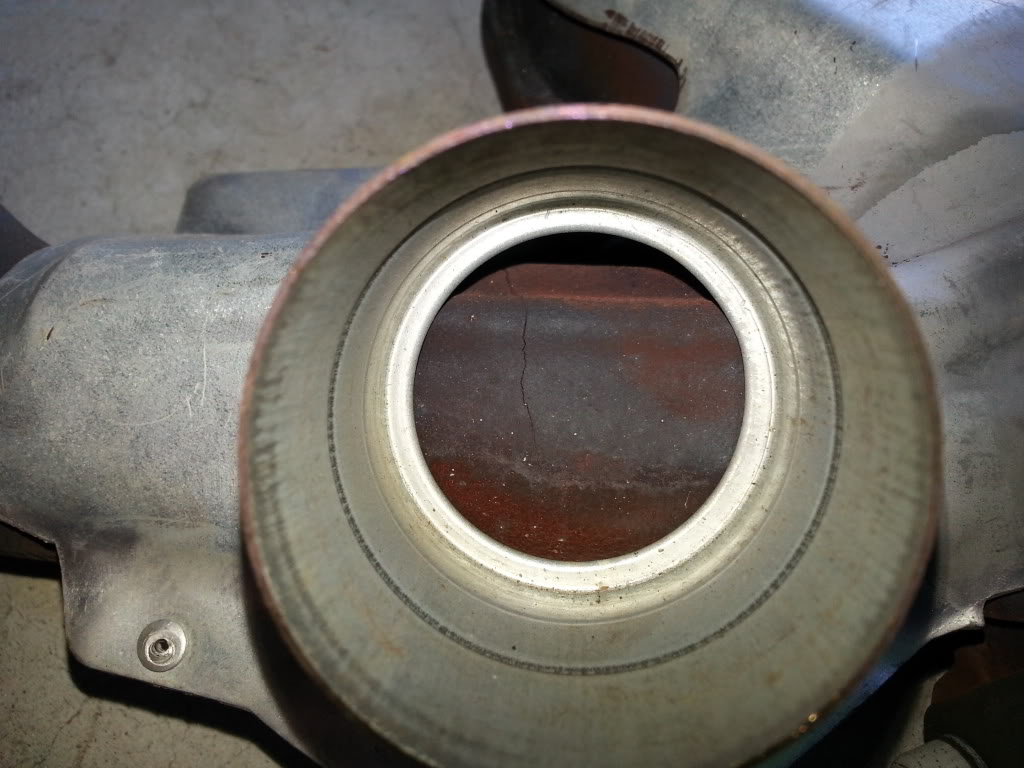

And noticed that my second dorman exhaust manifold in less than 3 months is cracked again. WTF? There has to be something causing it.

Removed my manifold again..!?
It's cracked again in the same spot the last one did, the front tube half way between cyl 1 and 2...

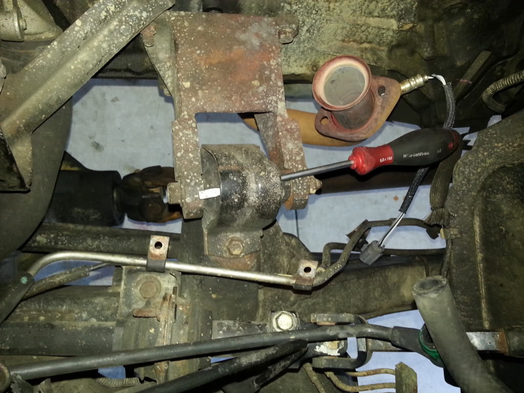

I noticed my engine mount had a gap between the "cage" and the rubber.
Anyone know if this is normal?
