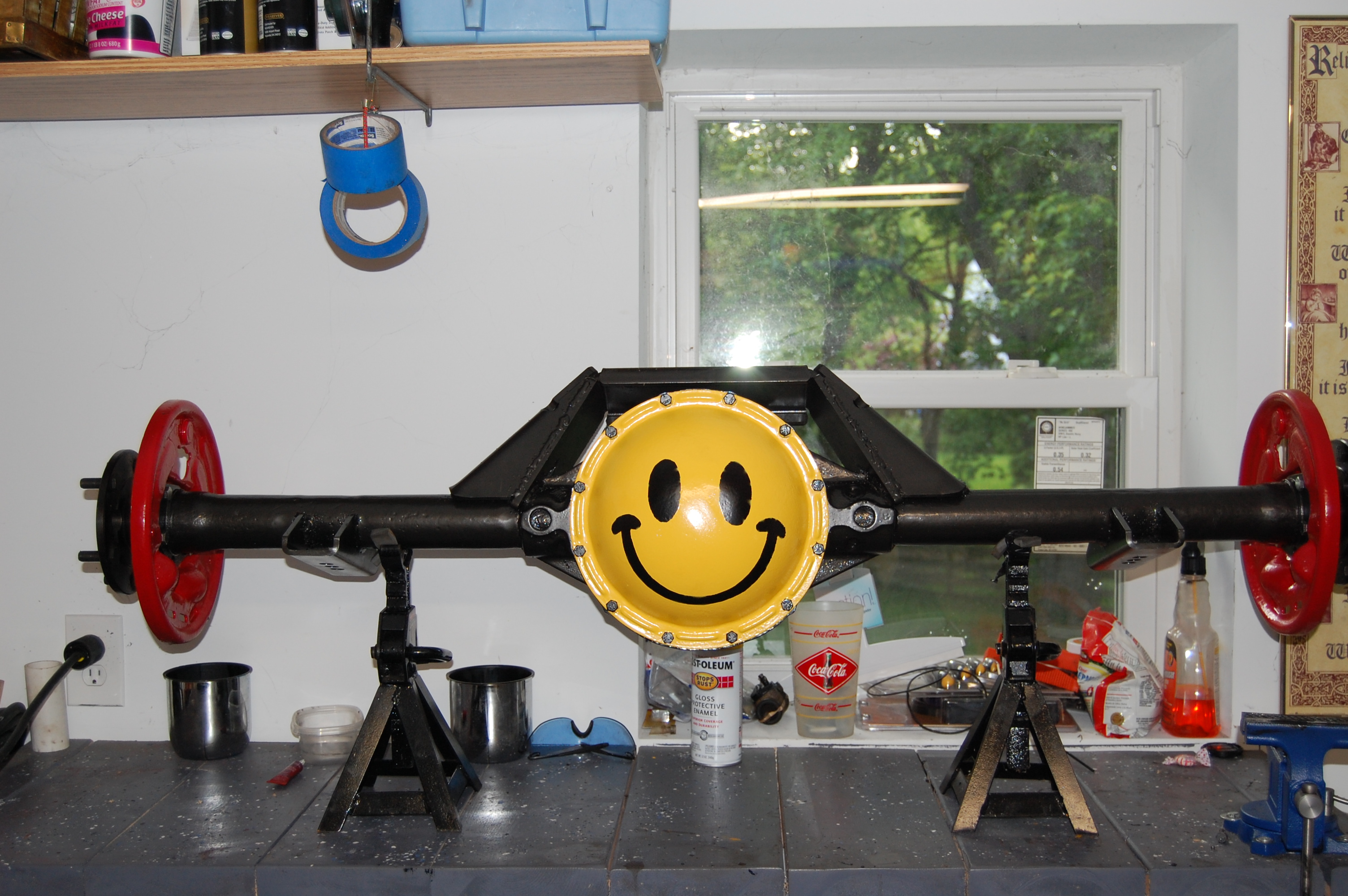

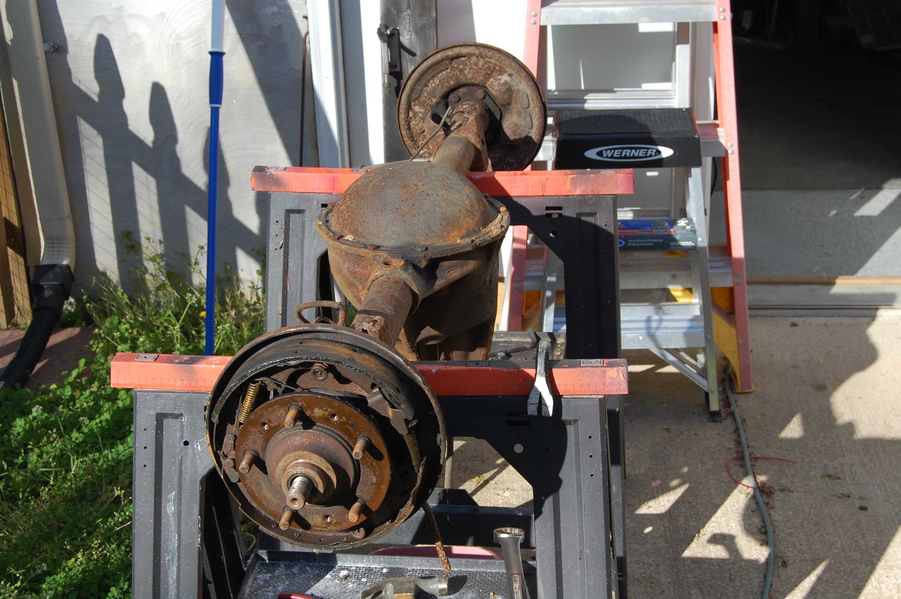

Well....Last I wrote, I needed a new rearend. So today I finished my project, well I still need to install the brake system and install on my CJ7. Here are the photos. I'm thinking of writing a tech article about building axles....It was fun and I learned alot. I took a lot photos along the way, but these are the before and after....Hope you like!
From this: various 014.JPG
To this:various 068.JPG
From this: View attachment 12896
To this:View attachment 12897
what rear end is that?
If you install some one piece axles in that AMC 20, You'll never have to worry about it again.
What's up Steady.foot........ Got it covered, reused my Superior Axles from my orginial rearend! It should hold up to just about anything after the stitch welding and truss job :bomb:...... FYI to everyone, this project was very low cost using materials readly available.

those amc20 rear ends look like they are a decent set up. was that the stock normal set up on a cj?
Yes, the AMC 20 was standard on most CJ 7's. Late in 1986 AMC ran low on them, so the last few CJ's had Dana44's. They are super rare and highly sought after.
The one I built in the photo has a truss for added strength and the tubes have been stitch welded.
The AMC model 20 rear axle was the standard axle on cjs from 76-86 and were on some waganeers and maybe some 70,s cherekees (not sure about the cherekees tho). As stated above in 86 dana 44,s went in some of the cj,s. The 20 is considered stronger than the 44 by some because it has a larger ring gear. The axle tube are weak, (hense the truss) and it has a two peice axle design that is weak, but can be cured with one peice shafts. I had a one peice axle model 20 with a locker and ran it HARD for about 10 years with no issues. The yj axles are about 3" wider total I believe.
