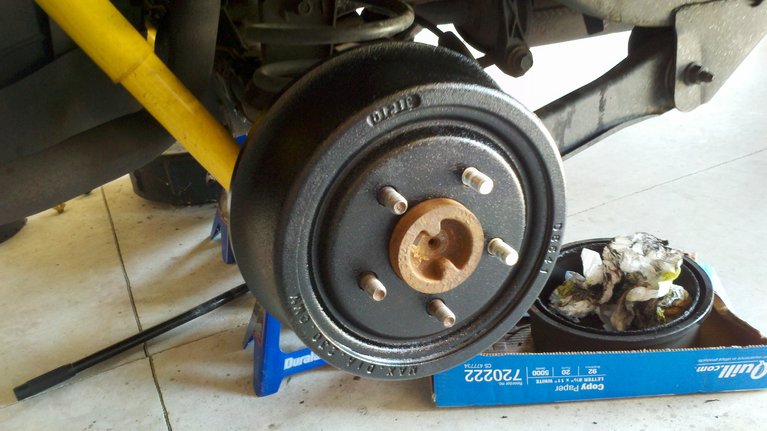

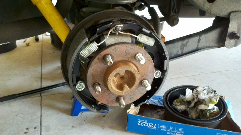

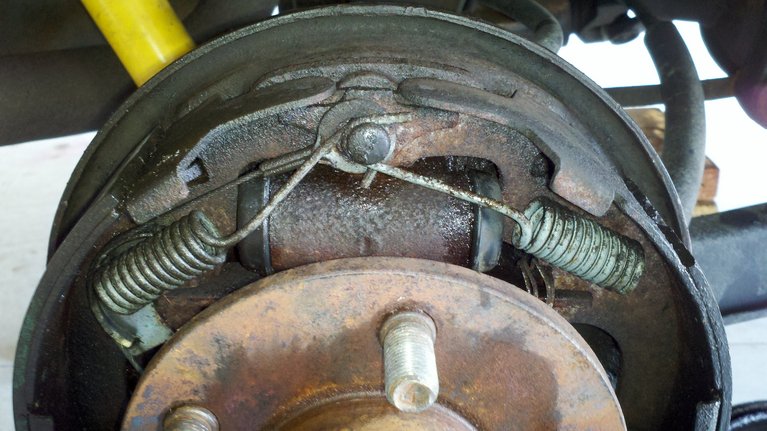

I replaced the rear brake shoes, hardware, wheel cylinders and drums. The hardest part was getting the brake line off the wheel cylinder, all in all it took me about an hour and a half.... not bad for my first time :p
old leaking cyl
new brakes
even painted the drums black

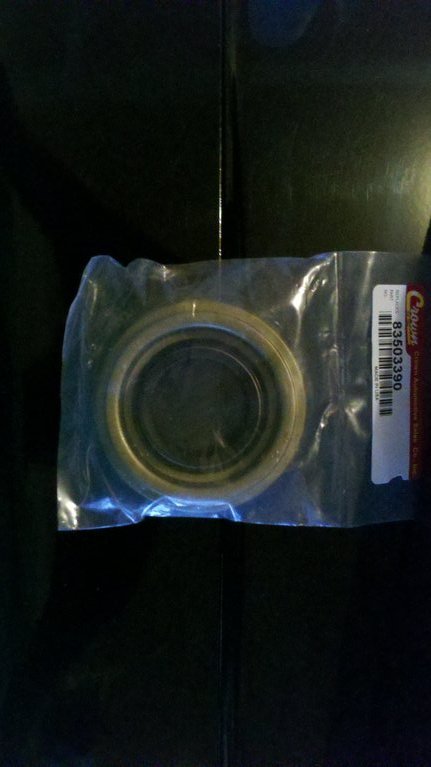

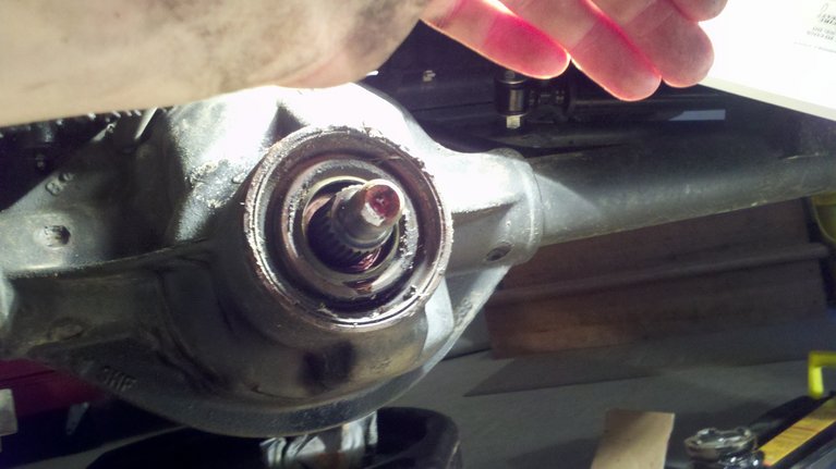

Replaced my front pinion seal
Old and leaky

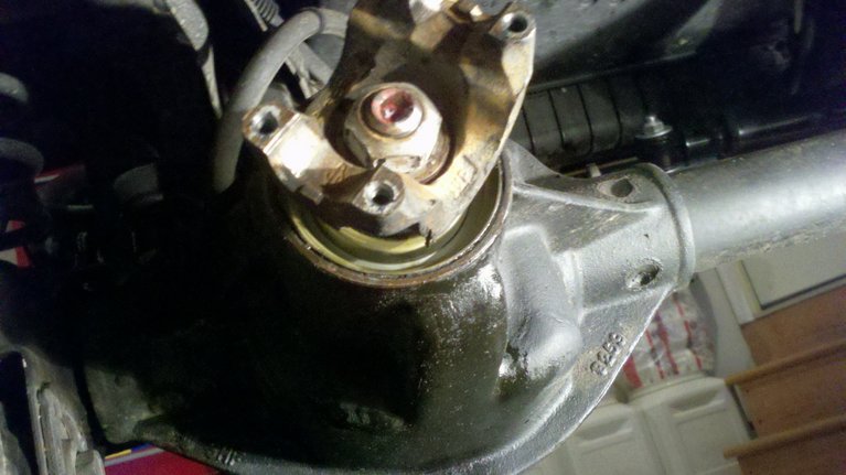

New

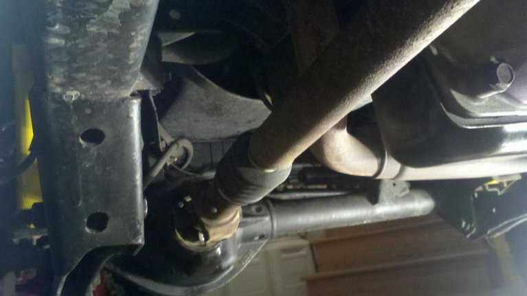

Even reinstalled the drive shaft since it wasn't the cause of my squeak
Sent from my DROID 2 Global
Discovered that my front pinion seal seems to be leaking worse now than it did before... Guess I've got other problems

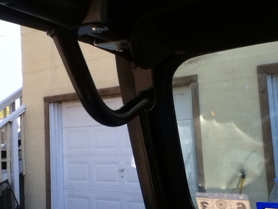

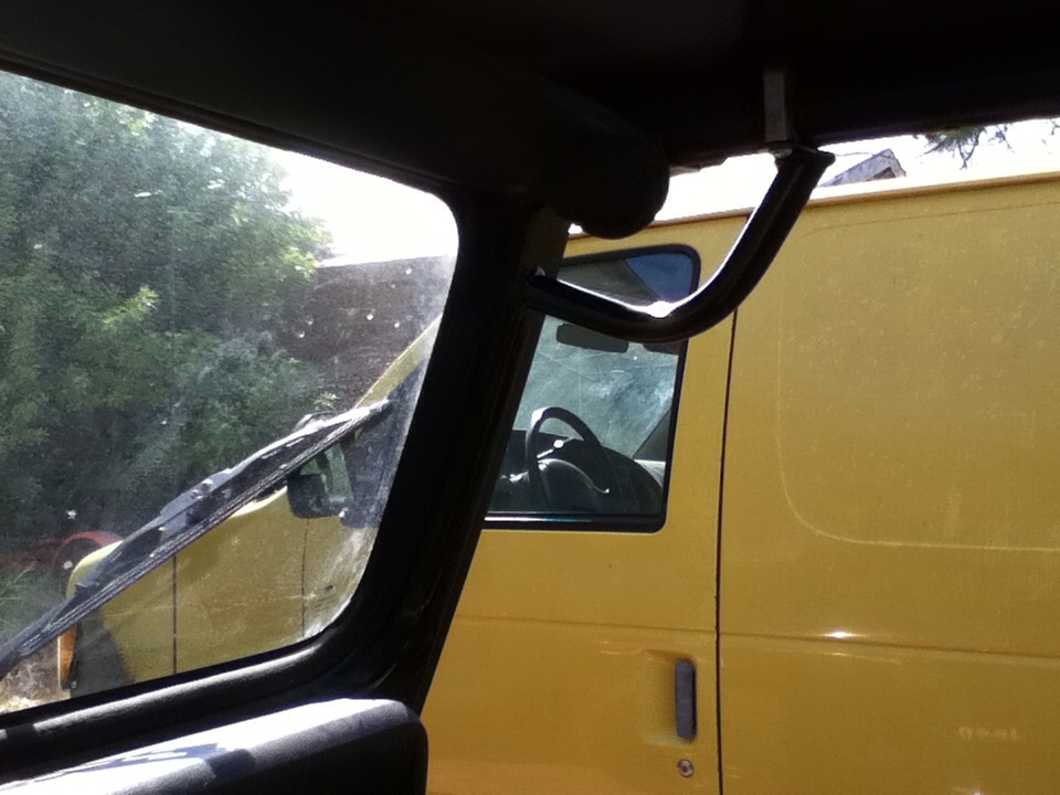

got my new grab handles in and installed
no velcro or string ones for me. i wanted something solid and these were only a little more expensive then buying paracord or the other styles.
Gutted out my whole front axle to find out what was wrong with my 4wd, finally found the problem and was just driving it two hours ago:)
Those are neat looking handles superj. Seems like you might hit your head a bit til you get used to them, yes?
Went and bought another new pinion seal... hopefully this one won't leak.
I'll install sometime this weekend.

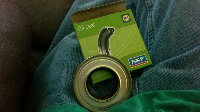

Went ahead and replaced the pinion seal again tonight. I hope this one doesn't leak!
I had the same problem with my Dana 44. Changed the seal and a few weeks later it started to leak again. Wound up replacing the seal and the pinion yoke.
If it leaks this time that's what I'll do.
The yolk looked fine no grooves or anything. This new seal felt tighter on the yolk so I'm hoping for the best.
The first seal was crown automotive from Quadratec.
This new one is a SKF seal from napa
