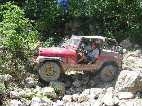

Thanks, S. I've got the diffs welded in the stock D30 and D35 in my '95 YJ and I love it. Great alternative for the best traction, especially since no spools or mini-spools are made for these axles. Search this forum and you'll find some good threads, try searching 'welded diff' or 'lincoln locker'.
I've seen many auto lockers snap the axle shafts on the same trails I wheel on, and I loan them my spare shafts. Luckily (knocking on wood) I've yet to break a shaft. I think the auto lockers are more prone to break shafts.
It's very livable on the street, but you have to have a way to disconnect one or both front axle shafts to run on the street. I have a manual vacuum disconnect.
I thought about doing this after my friends who had trail rigs told me that it was just fine. A little more research and some advice from daily drivers, and I was led to not do it. Great if ur going in a straight line, but horrible turning corners, especially in the wet, and it just seems to me like something could be really messed up if some welded material decided to let loose in ur carrier....
Depends on who welds it, they must be competent. Done properly it will be the strongest type diff available.
It's really well mannered on the street, you'd be surprised. I was. It wants to track straight, so straight line driving is even more effortless. You don't notice anything in sweeping turns. Tight turns will squeel the inside tire on dry pavement, harder compound tires will chirp the loudest. My BFG MT's chirp a lot louder than my Swampers.
Drives fine on wet pavement, just don't accelerate hard if you have any power (which my 2.5L doesn't). You don't accelerate hard in the snow either, but sane driving is fine and safe. You have to run the front unlocked in the snow, or you can't turn. Need a manual disconnect for this.
This thing climbs like a mountain goat, for me the offroad improvement was well worth the small quircks on the road, and the strange look from bystanders when turning. It may not be worth it for everybody.
I've heard a lot of bad stories about auto lockers in the rear causing sudden lane changes when locking and unlocking, none of that with a Lincoln Locker. Very predictable.
I'd put spools in if they offered them, but they don't, so these are homemade spools of sorts. When I install waggy D44's front and rear, you can bet they'll both be spooled. Mini-spools are less than $75 and replace the spider gears.
