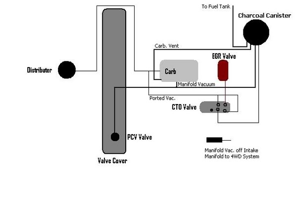

I found this on line and it's a good start:
i did mine even more basic then the drawing above.
distributor is run off ported vacuum (but can be run off manifold, your choice) on the carb, 4x4 is run off the manifold vacuum port on the carb. brake booster is run from the normal spot.
thats all i have and it worked great.
