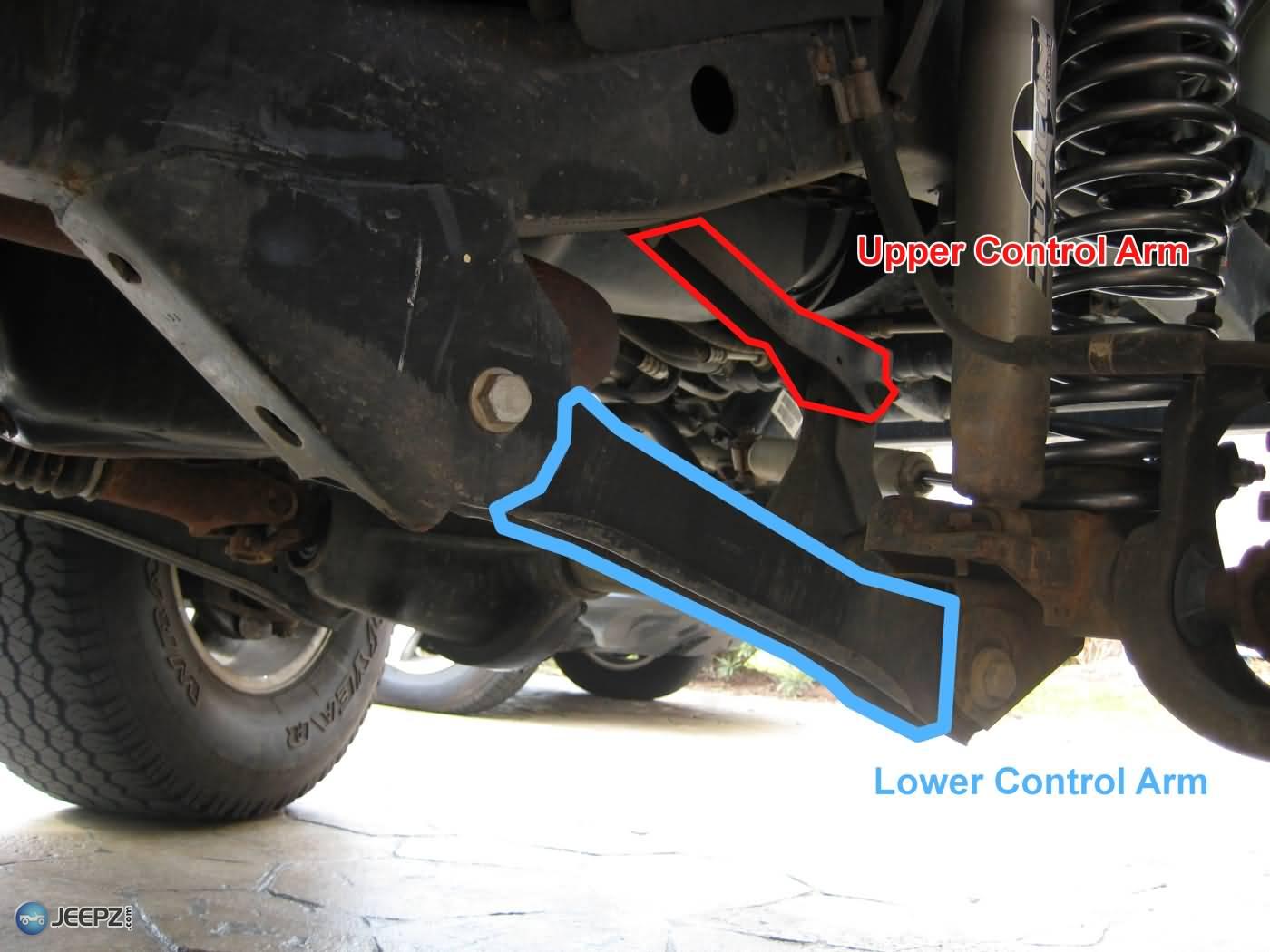

Thank you I appreciate the ideas and help. That is a great article. I am off to Kramer tire today to get this done. Are control arm bushings something you can visually inspect without taking anything apart? I ask this because I can see the bushings on mine and the look fine to me.... I compared them to photos of new and worn online and mine look new...
You can tell if they are bad by just looking at them, however you have to remove the control arms in order to see them. Here are your control arms

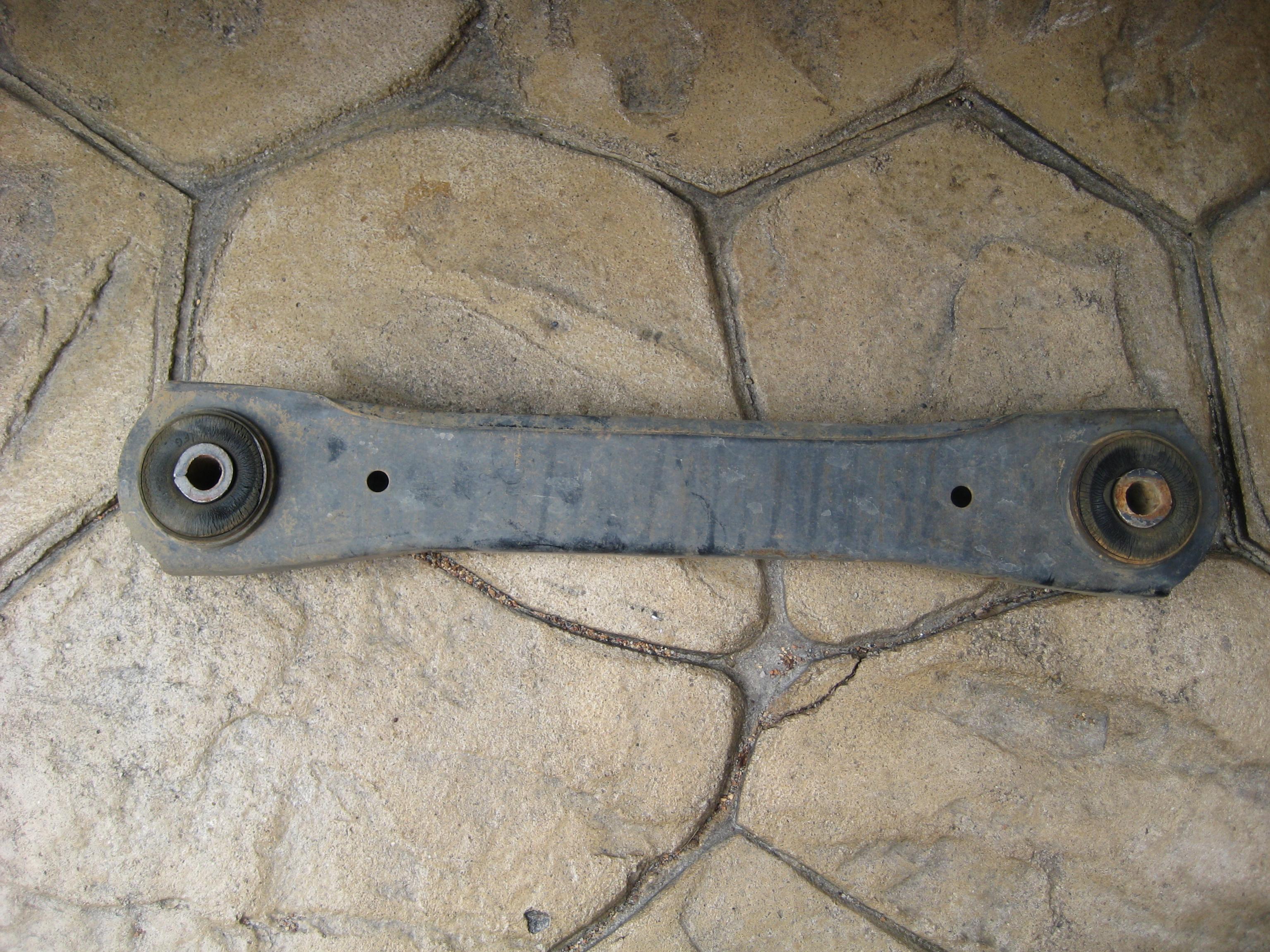

And here's what the control arm looks like off the Jeep. The rubber bushings on each end pop out. and can be replaced. I bought the bushings from the local parts shop for $40 a side.
I actually have a brand new set of those lower arms in a box, someone ordered them and didnt need them and gave them to me we had the same jeep. Do those basically just unbolt? I could change those just be cause I have the parts if its not a hard job.

I don't want to make any un-needed work for you, if your problem isn't the control arms, but if you have them laying around then it shouldn't hurt. You're right that it is just a unbolt the old ones and bolt up the new ones job, however you'll probably have to wrestle the axle forward or back some to get everything to line up. Once you get the new ones on then you'll have to get an alignment again (so there's another $80).

I would replace the control arms with the new ones, they are very easy to replace if you do them one at a time. You don't even have to jack up the vehicle if you do one at a time.
You can inspect the control arm bushings without removing them, use a flashlight and a screwdriver to inspect the bushings for tears.
