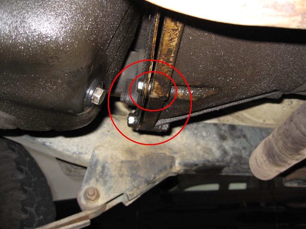

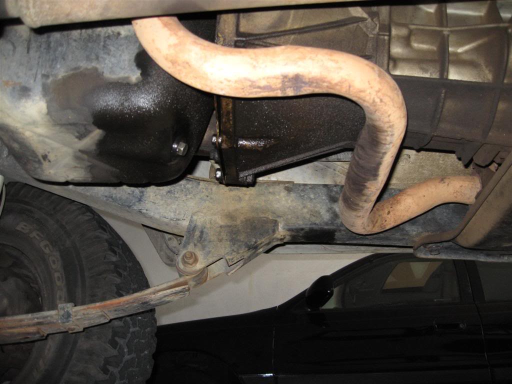

here are some pics i just snapped away

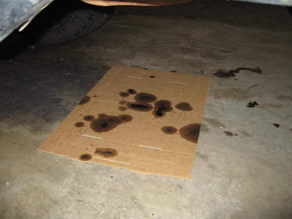

After 4 Weeks of having the car this is what the Cardboard looks like.
If you're sure it's the transmission, it is probably coming from the input seal. You have to drop the transmission to fix.
If you're not sure it's the transmission, it could be the valve cover, leak around the oil pressure sensor, leak around the oil filter, or possibly even rear main seal. I would check everything else before dropping the transmission. I'm guessing valve cover. Remember that it's blowing back as you drive it.

Looks like the rear main seal. Good chance your CCV system is clogged and you're building too much crankcase pressure, not properly venting it to the intake.
Gotta agree with Bounty. From the oil build-up on the oil pan (way up above the drain), looks like it's been seeping from above, then as you drive, blowing over everything else. I would suggest a good cleaning of all that residue, then a prudent check after driving a little while............might shed a little more light on the problem. Good luck!
Yeah - I'm with the other guys here. Clean off the gunk until you get to the highest point of the leak... my guess is it's leaking back from the valve cover, or it's the rear main. Should be easy to see which when you scrub it down (or, should I say up... work from the lowest point upwards).
