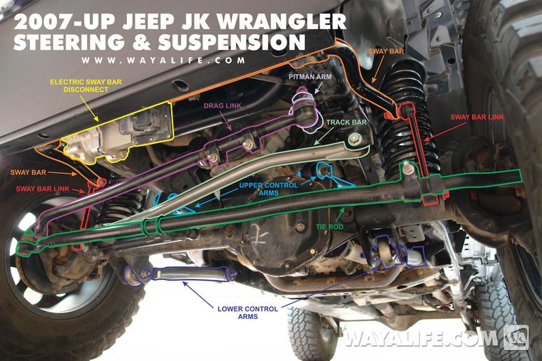

The lift came with a drop pitman arm and a track bar relocation bracket. The important item here is the track bar is parallel with the drag link. If they are not parallel they follow two different arcs. When the vehicle suspension articulates when hitting a bump the axel moves down and away at a faster rate than the drag link. This causes the steering to change course. As the weight comes back down the change in direction snaps back. This is called bump steer. Small bumps throw the vehicle around. In most cases if you drop the drag link with the pitman arm you must change the angle of the track bar. Being you changed to a high steer the pics will help determine what is off.

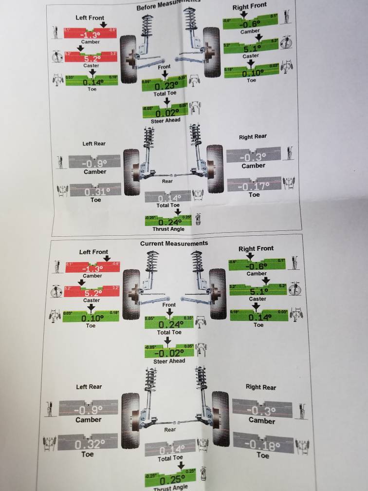

The alignment you got, did they give you a printout of the alignment values? Post them up.
In the mean time post pics

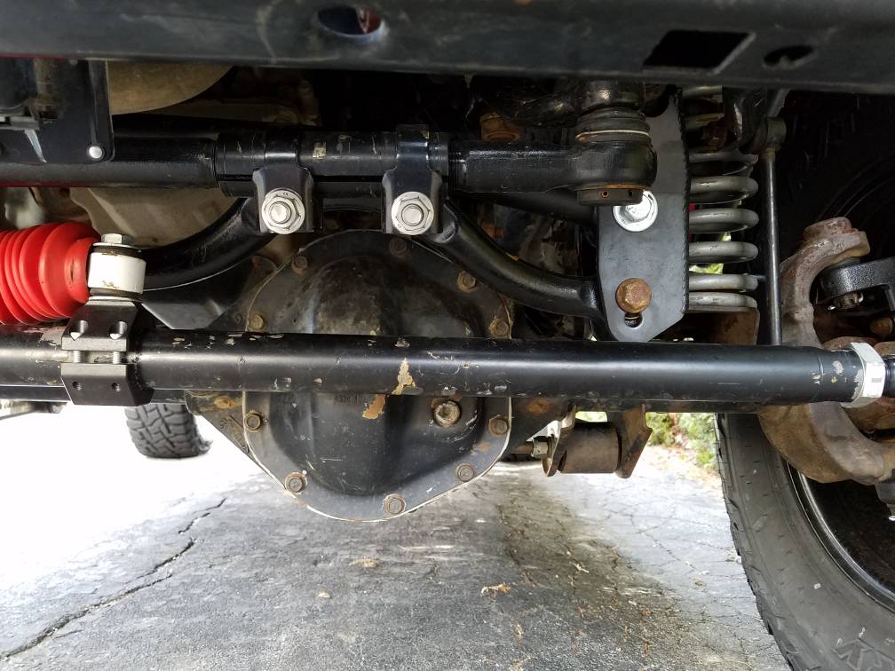

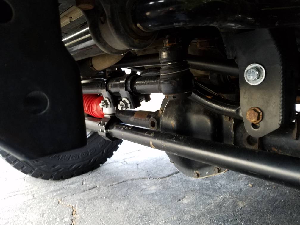

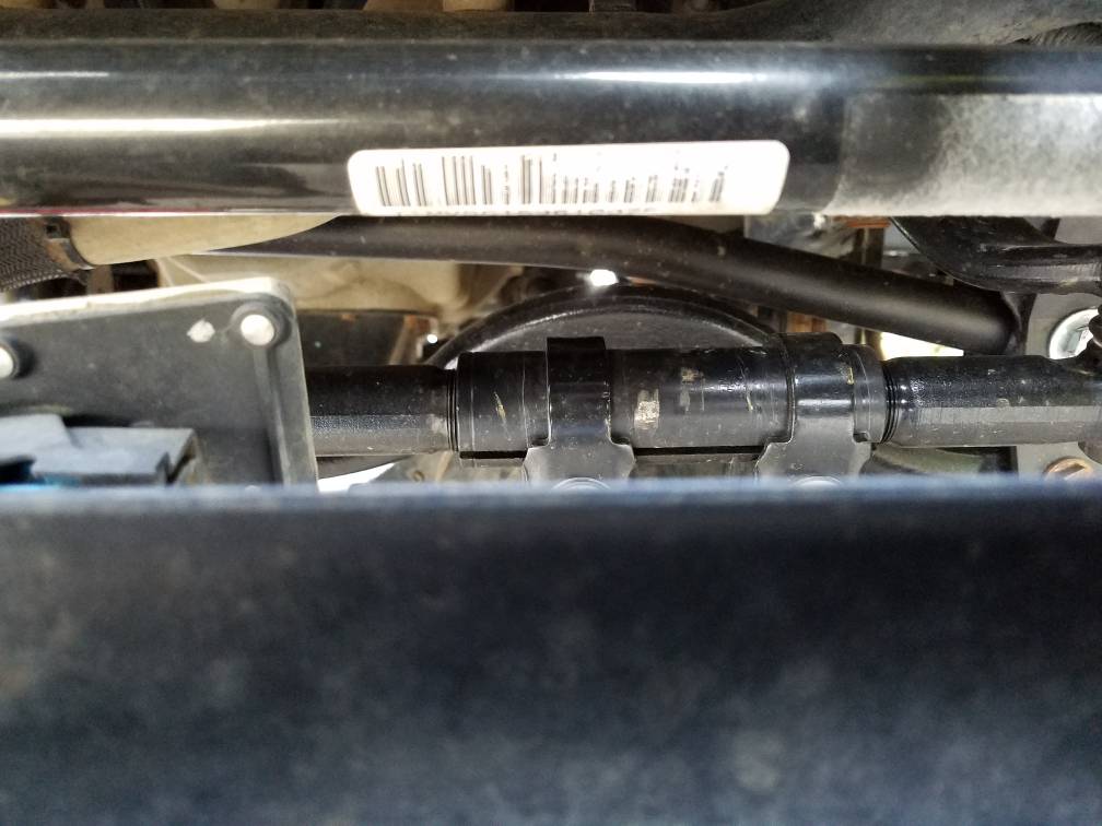

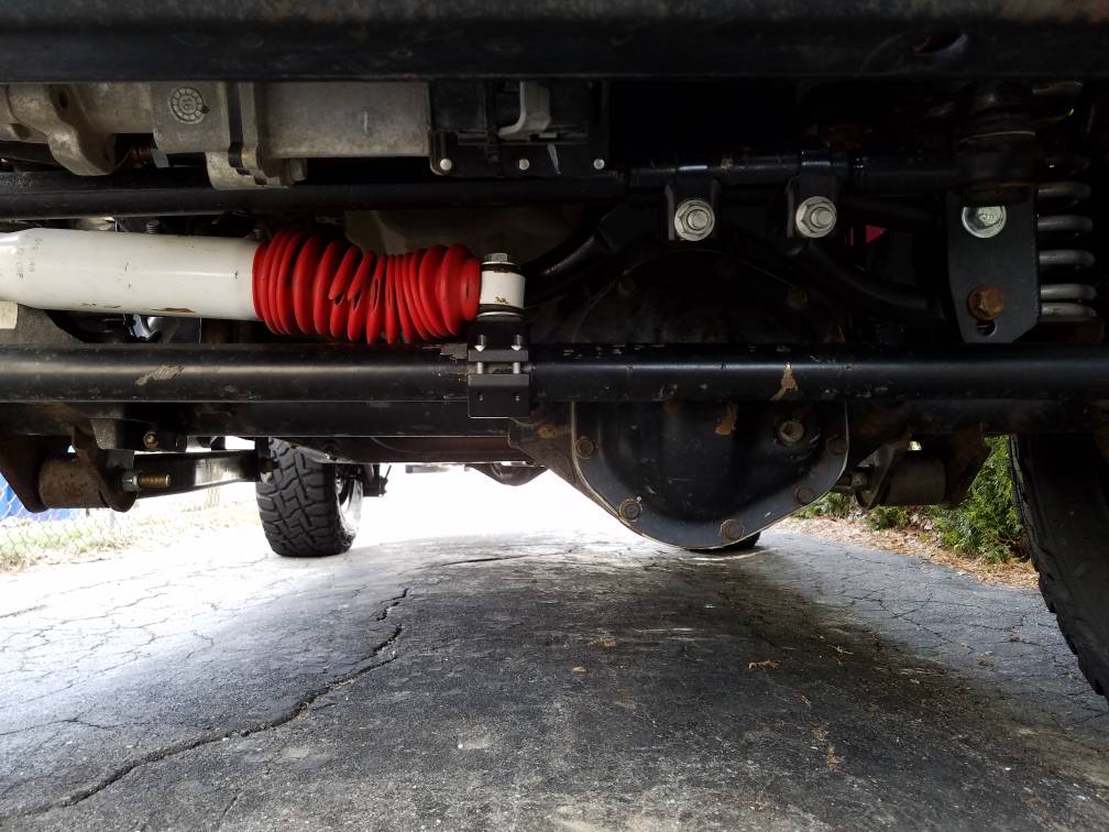

Best pics I could get. Sorry I took so long I had to look at my dad's brakes and put a cb in my gf's jeep.

Figured out why there was so much movement is my steering. 😑 the last place that aligned me left the damper and tie loose. I just went under the jeep to take pictures the damper was slid all the way shut and the tie rod nuts weren't even touching the shaft.

I'll be honest it doesn't look like you got 4 in of lift.. Maybe cause the pics are so close. Here is one I found with 4 in lift ant terra high steer.
Note the drag link and Track bar alignment.
