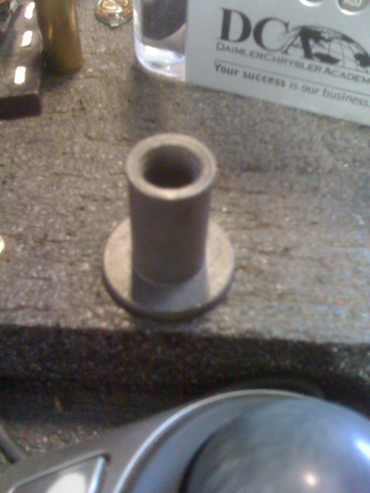

You can grind the head off the one on the frame and replace it. It's available from a dealership. You will need an extra bolt and nut prefferably a hardened one to crush the new nut into the frame. they look like this before it's crushed into the frame.

There's a few other ways to fix it without running a bolt all the way through the frame. You can weld the nut to a washer and slip the nut up into the hold in the bottom of the frame, welding the washer to the bottom of the frame. Or you can cut an access hole on the outside of the frame to weld inside the frame rail, if you don't mind closing and welding shut the access hole.
