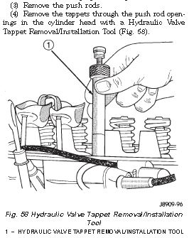

Why did you have to remove head - jeep manual instructions attached - maybe some pictures?
