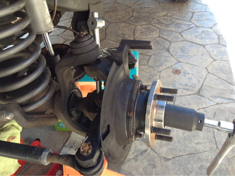

Tried to do my hubs today & couldn't get the axle nut loose to save my life :-(
I took mine off yesterday. I put a bar in between the axle ujoint then used a big breaker bar.
I put the biggest screwdriver I had in there & bent it pretty good :-( I borrowed an electric impact gun from a co worker... something is gonna happen
I broke mine loose before taking the wheels off while it was still on the ground.
