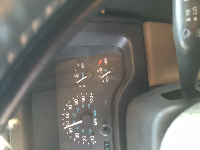

Okay guys and gals I have an issue that I need help with. I need to figure out what is going on with my Jeep heat. This is the first winter that I have had this jeep and as the temps are dropping I noticed that it is not heating like it should. I have flushed out the heater core and it did not help. The issue I have is that it will not heat. It only gets luke warm. I am leaning toward that it is my thermostat. The reason I say this is because my running temp only gets to 210 if the Jeep is sitting still at an idol. The moment I start driving the temp drops (see pic). Any help would be greatly appreciated.

I believe your thermostat is stuck open !
2x on the thermostat.

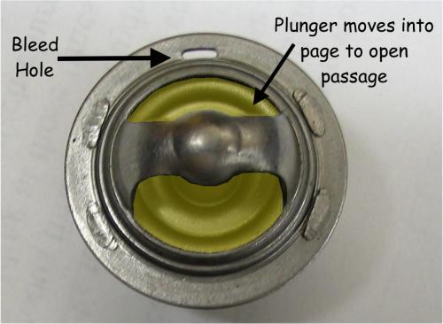

OEM has a bleeder hole above the valve. You could drill a hole in other mfg just be sure to align the hole toward the top to help bleed air out.

I've never heard of an air bleed hole in the thermostat, but it makes perfect sense though.

OEM thermo above. Also 49 sec in video.

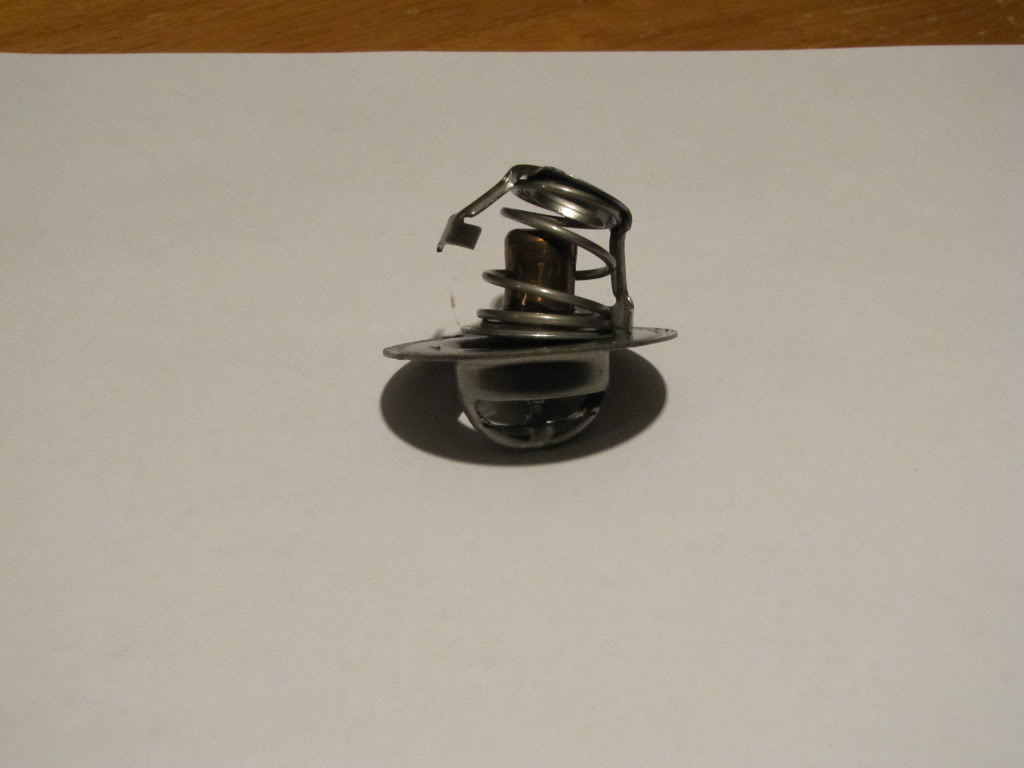

Home drilled below (good enough) though the lower thermo has a smaller valve. Bigger is better as well as wider opening.
Wasn't the top video but basic and not 20 min long. I think my tips and the other link are sufficient.
Gloves and a camera stand.
Cause they fail. This was after 1 month.
