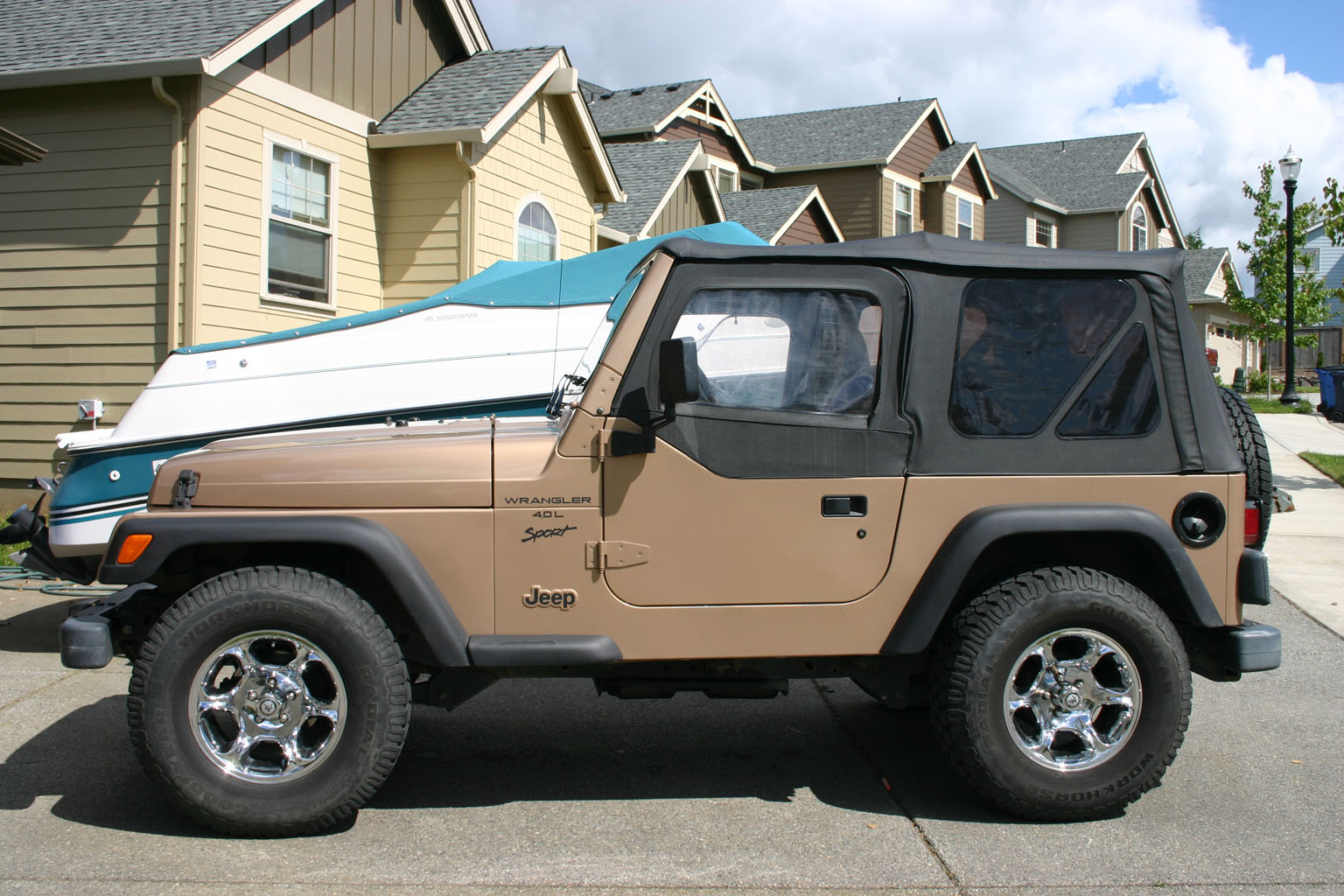

Here is a picture of my new-to-me toy I just picked up. 1999, 4.0, auto, 112K. I also picked up full hard doors (not shown) but need to do some adjustments to get them to close. (sagging to low at the strike) I tried to loosen the hinge screws but not much luck; stripped one, loosened one, and the rest aren’t moving. I’m not a body guy. Any ideas?

Put your socket in the hinge screw and give it a few taps to try and break free anything that might hold it tight. Then give it a twist to see what happens that might help. If its stripped to the point of no meat to bite on, drill it out and replace it.
I removed the door panel from the door and sprayed the screws from the inside and on the head as well. Let it soak then i used a manual impact driver with a medium size hammer and worked on all the torx bolts loose after a while.

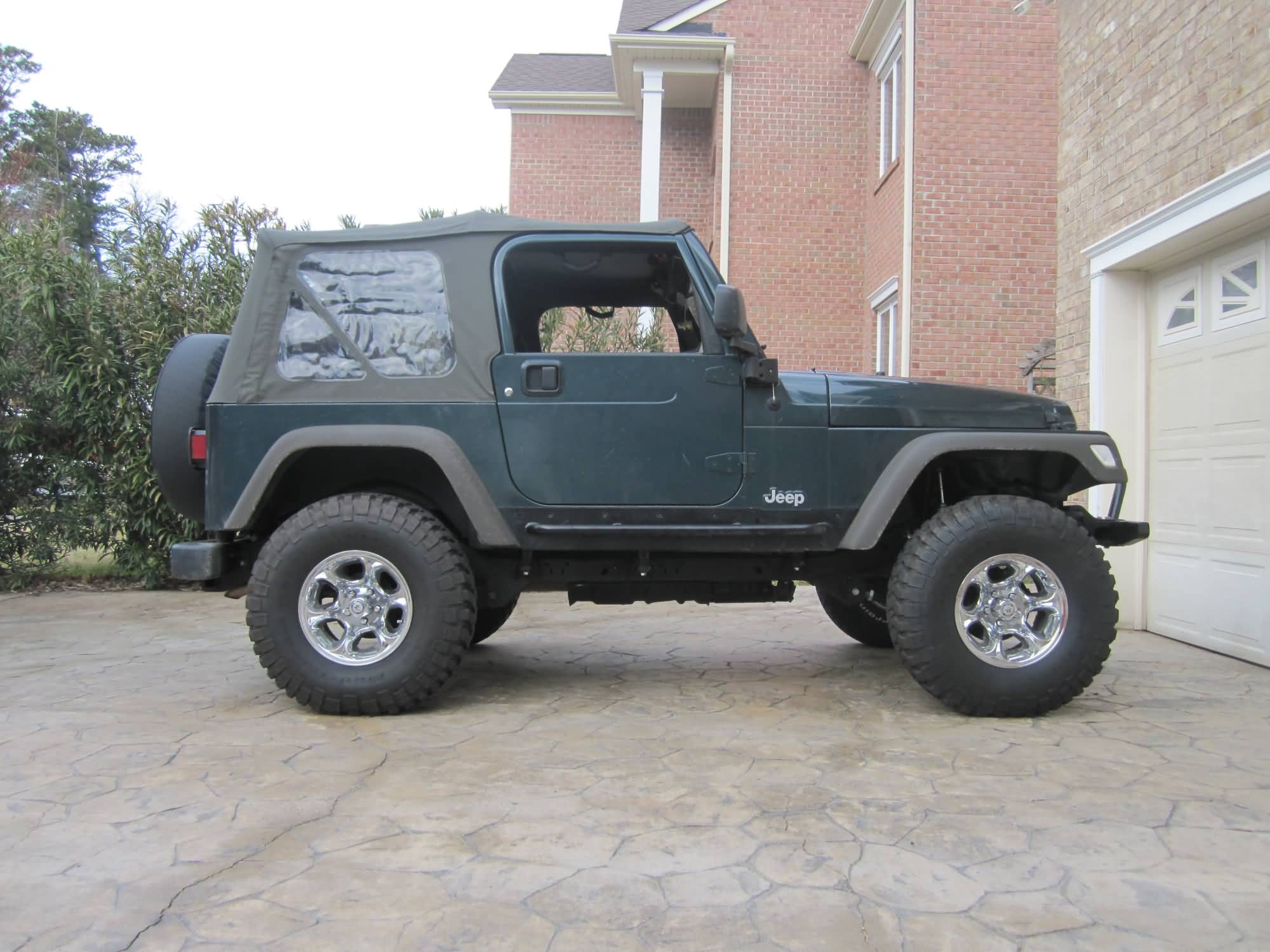

Hey, I've got those same rims! You don't happen to know what make / model they are do you? I've been trying to get a spare rim for 2 years now but no one can ID them.

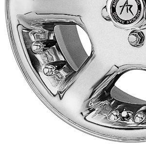

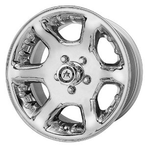

Thanks Kriss, but I don't think those are the ones I have. I've searched about everywhere I can and asked two different tire chains, but can't seem to find them...
This is the Atlas AR-160
It looks almost perfect except for the bumps along the rim - mine doesn't have that. It's close enough that I may buy it for my spare though...
