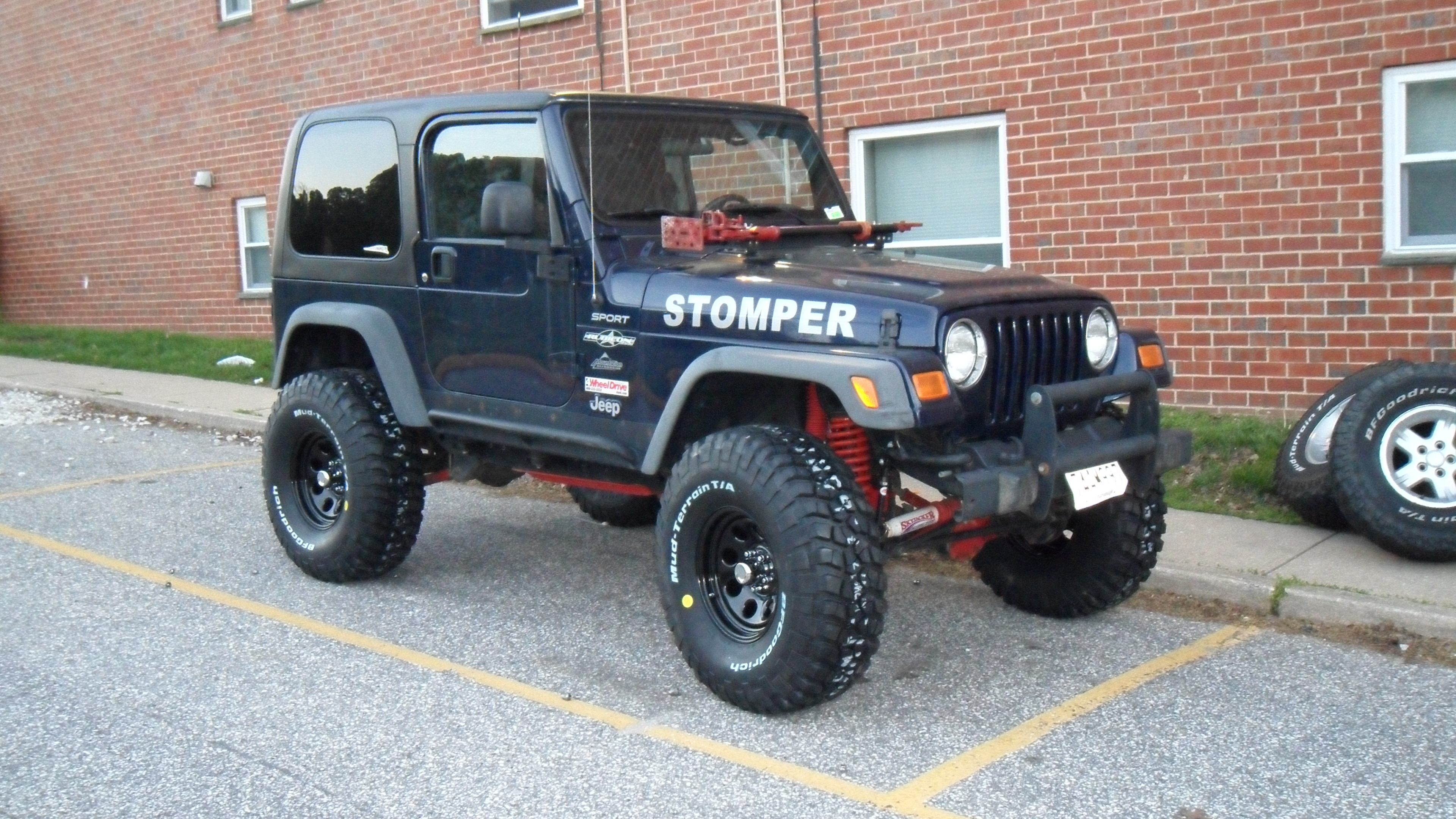

Posted more pictures in my build thread, but to bring closure to this thread, here is the finished product:
