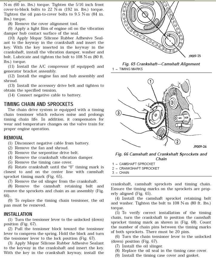

its a 4.2, the new gears do have timing marks in them but they arent lining up like the hayes manual says they should be. it said that there should be 15 chain link pins between the 2 marks, and when i had em lined up, the distributor is way off, to the point i cant even set it, i tried giving the cam another full turn but it didnt seem to do anything. this is the first time ive replaced a timing chain and im lost.
hmmf. i double checked with the '00 FSM and it says it needs 20 instead of 15. screenshot is attached... best of luck! let me know if you need anything else.

'00 model might be different. He's working a 4.2.
