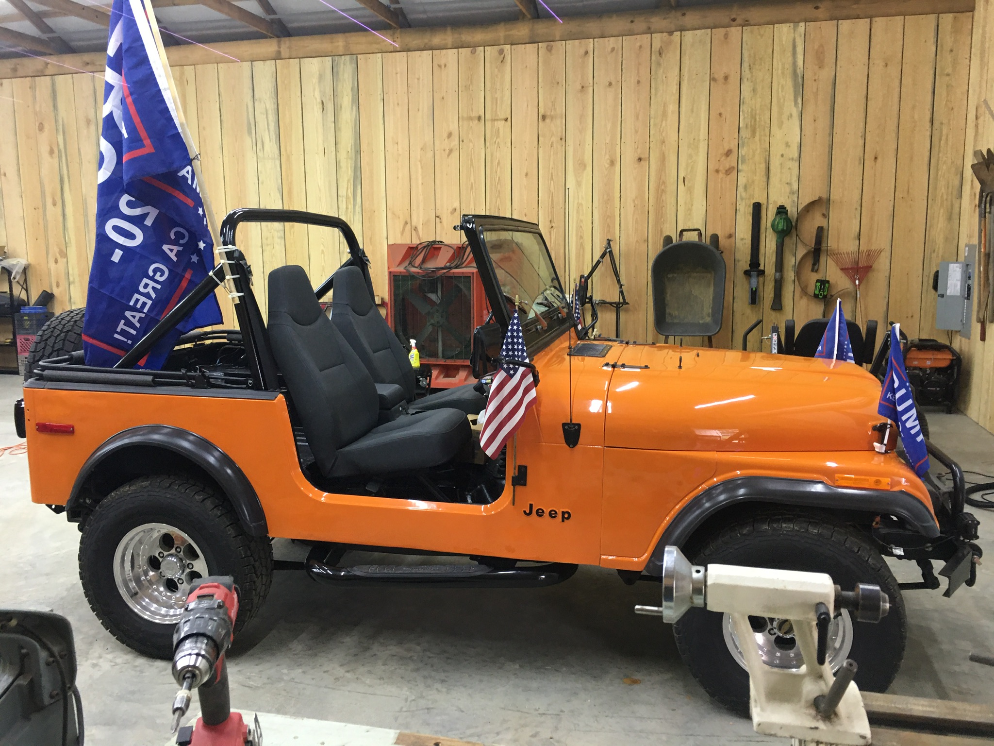

So I put my cj7 in a Trump parade last November. Made the 10mile drive, but at around mile 7 Big “O” died. How embarrassing! I pulled over and after cooling it started back up. I finished the parade and went home uneventful. Since then I haven’t been able to drive it more than 3 miles before it begins jerking and popping then dies. Same deal cools down and go again for short distances. Yesterday I checked timing, spot on but when I connected the vacuum advance back directly to the manifold the timing advanced off the indicator scale at idle. I moved it to the ported pickup on the carb. At idle timing remained at 8* BTDC and advances to around 15*BTDC when throttle opens. I feel confident it’s right now, what are your thoughts? I haven’t been ableto test it after making the change. Hopefully, tomorrow or Friday.
