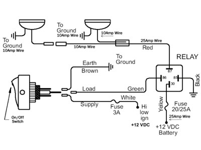

I’ve got a 17 year old who keeps leaving the headlights on, can anyone tell me how to tie the lights to the “on” position of the ignition so when he turns the Jeep off, the lights (any everything else for that matter) goes off too? 1995 YJ 4 cylinder engine. Thanks!

You could splice a relay into the headlights where ign power supplies the switch. This way ign off lights off.
