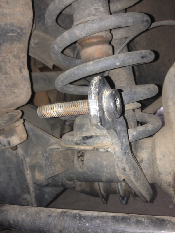

Though so do they come in bigger sizes(probably a very stupid question.) and this is a picture if my exact problem which you also probably figure I took the sway bar completely off hoping for it to be easier which it makes no difference

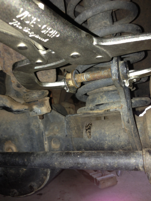

And I stuck a jack in between it and cranked it pretty far didn't want to damage anything and I can't get a vice grip to get on the end of the bolt and something else
I know it's crazy this vice thing is really tight and isn't doing anything not even a little
And is it supposed to look like that I assume so but just wondering

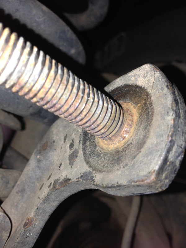

It will allow you to hit the end of the bolt and not destroy the threads...
From the looks of your last picture it has a spline ike a wheel stud, take a hammer and hit it....
