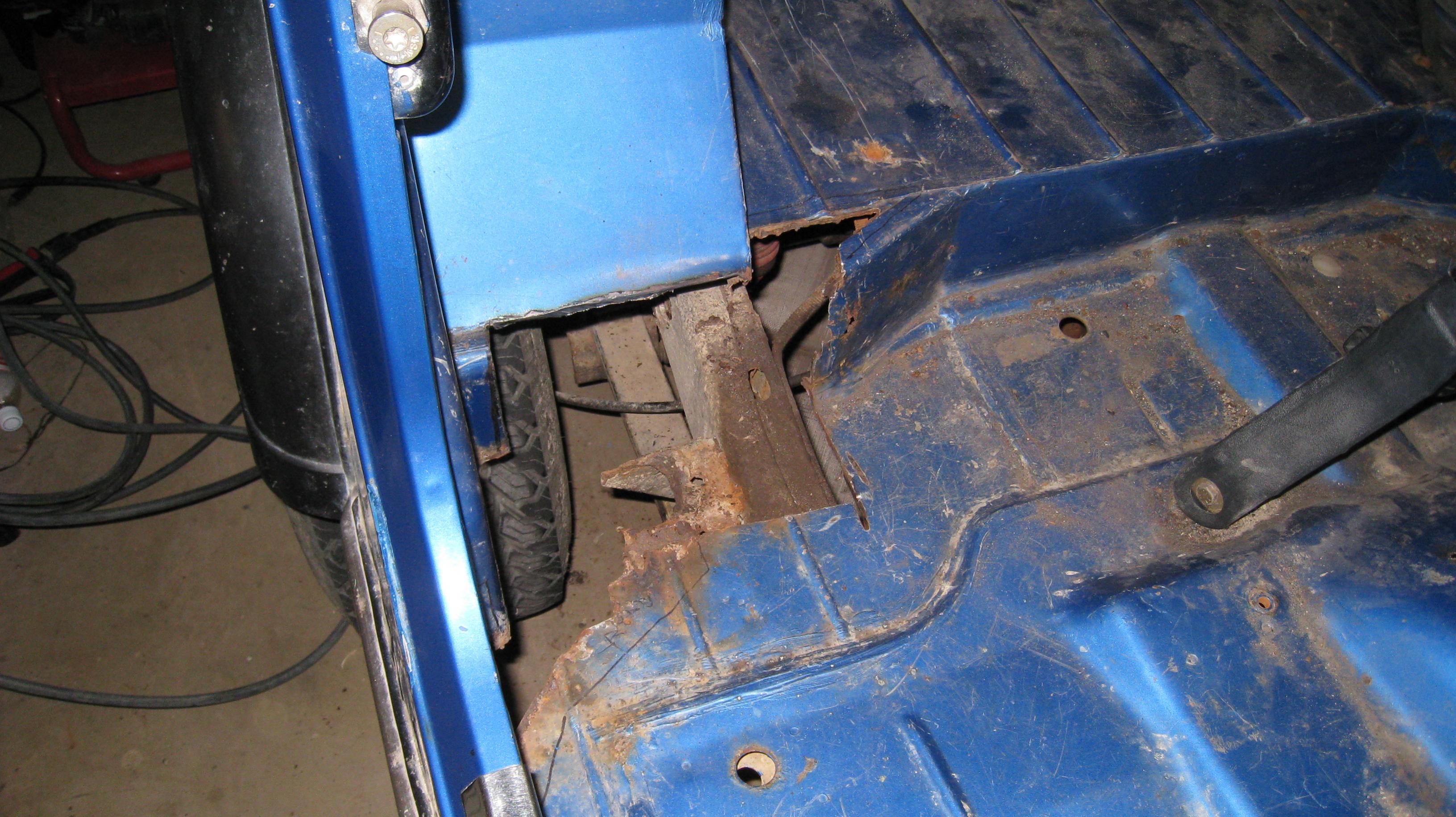

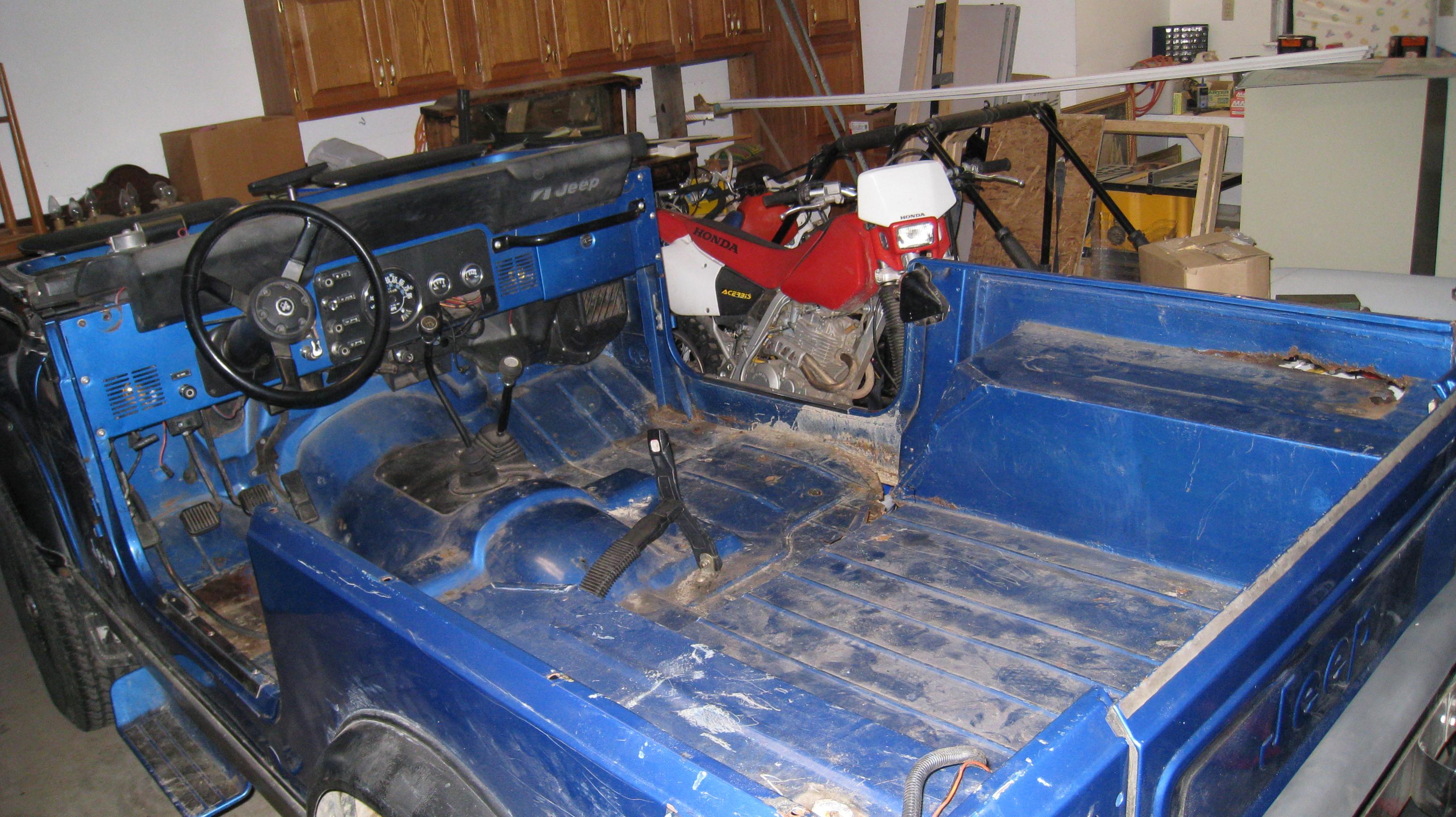

Here's a couple pics of mine right now. I'll put some more up when I get my roll bar mount in (and find the camera). Hang on, it's going to be heavy duty :shades:
Any advise? :mrgreen: I'm open to any comments or questions about my naked Jeep.
