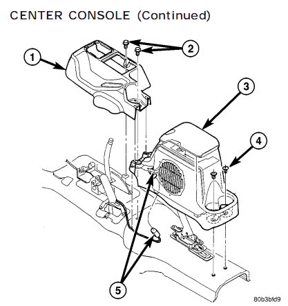

You'll be limited in choices for subs that size that's why I went with the one in that link. (nice replacement sub). It is not a direct replacement and some cutting on the inside is involved. It will also have to be powered by an amp. Getting to the sub should be pretty straight forward. You have to remove the center console.

Turns out my dad had an extra 10" just sitting in his truck so I can use that. My only problem now is disconnecting my old woofer. I have a huge Bundle of wires that are connected to another that goes deeper into my console and my dad thinks that all of that is for all my other speakers to the amp in the woofer box. If you understand what I'm talking about can you help me disconnect my old woofer. My dad already knows how to connect the new one. Thanks for all the help so far!

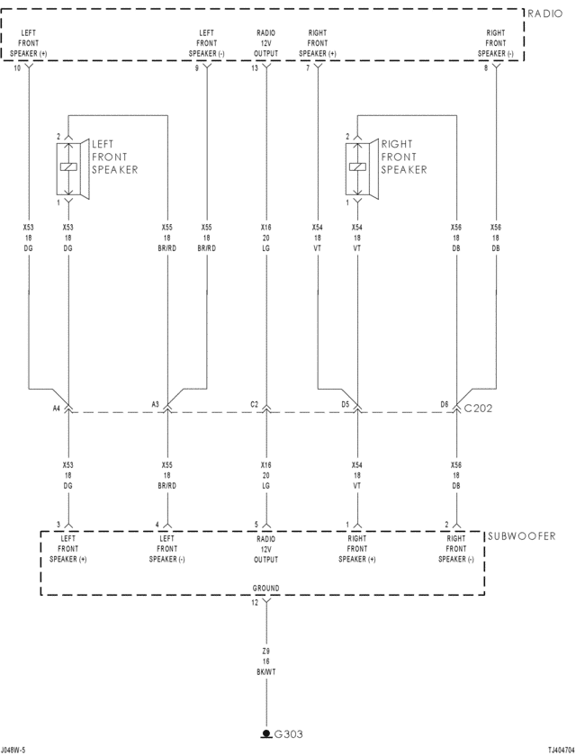

The factory subwoofer has the built in amp. Here.s the connector pin out's.SUBWOOFER - 12 WAY
CAVCIRCUITFUNCTION1X54 18VTRIGHT FRONT SPEAKER (+)2X56 18DBRIGHT FRONT SPEAKER (-)3X53 18DGLEFT FRONT SPEAKER (+)4X55 18BR/RDLEFT FRONT SPEAKER (-)5X16 20LGRADIO 12V OUTPUT6X13 16BK/RDFUSED IGNITION SWITCH OUTPUT7X52 18GY/DBRIGHT REAR SPEAKER (+)8X58 18DB/PKRIGHT REAR SPEAKER (-)9X51 18BR/YLLEFT REAR SPEAKER (+)10X57 18BR/LBLEFT REAR SPEAKER (-)11--12Z9 16BK/WTGROUND

Since you've got a kenwood stereo, and not a factory one, it's hard to say how the last guy wired up the stereo, but normally there is just a plug on the factory subwoofer that you can unplug - thus disabling it. Take out the existing sub and you should see a plug on it.
There is a plug that has a huge bundle of wires and my dad believes that it is all of the speakers are routed to the amp in the sub then back out to the speakers. I think I just need to cut a wire or to to the actual sub, then I can disconnect it, but I dnt know if im correct, or if I should do it differently.
I would hesitate before cutting any wires (you should not have to cut wires to replace a speaker). Are you trying to replace the stock sub, or simply disable it? If you want to just disable the sub (so it won't rattle) just unplug the connection on the sub itself.

I'm trying to disconnect that one, and replace it with one that is going to be behind my seat. I also would like to be able to pull out the old speaker, as I want to disassemble it to look at the parts.
You don't need to cut anything - just remove the sub and enclosure from your console. There is a plug that you unplug to remove it (i believe it's #5 in SouthTJ's post)
