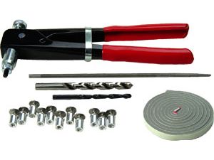

I would just drill and replace the worn rivets out. There really is not much changes you can do except finding a rivet of the same diameter but a larger stud spread when its pulled.
Rnventions JO141 - Soft Top Reinforcing Kit for 76-95 Jeep® CJ-5, CJ-7, CJ-8 Scrambler & Wrangler YJ - Quadratec
Install this and it should keep.
