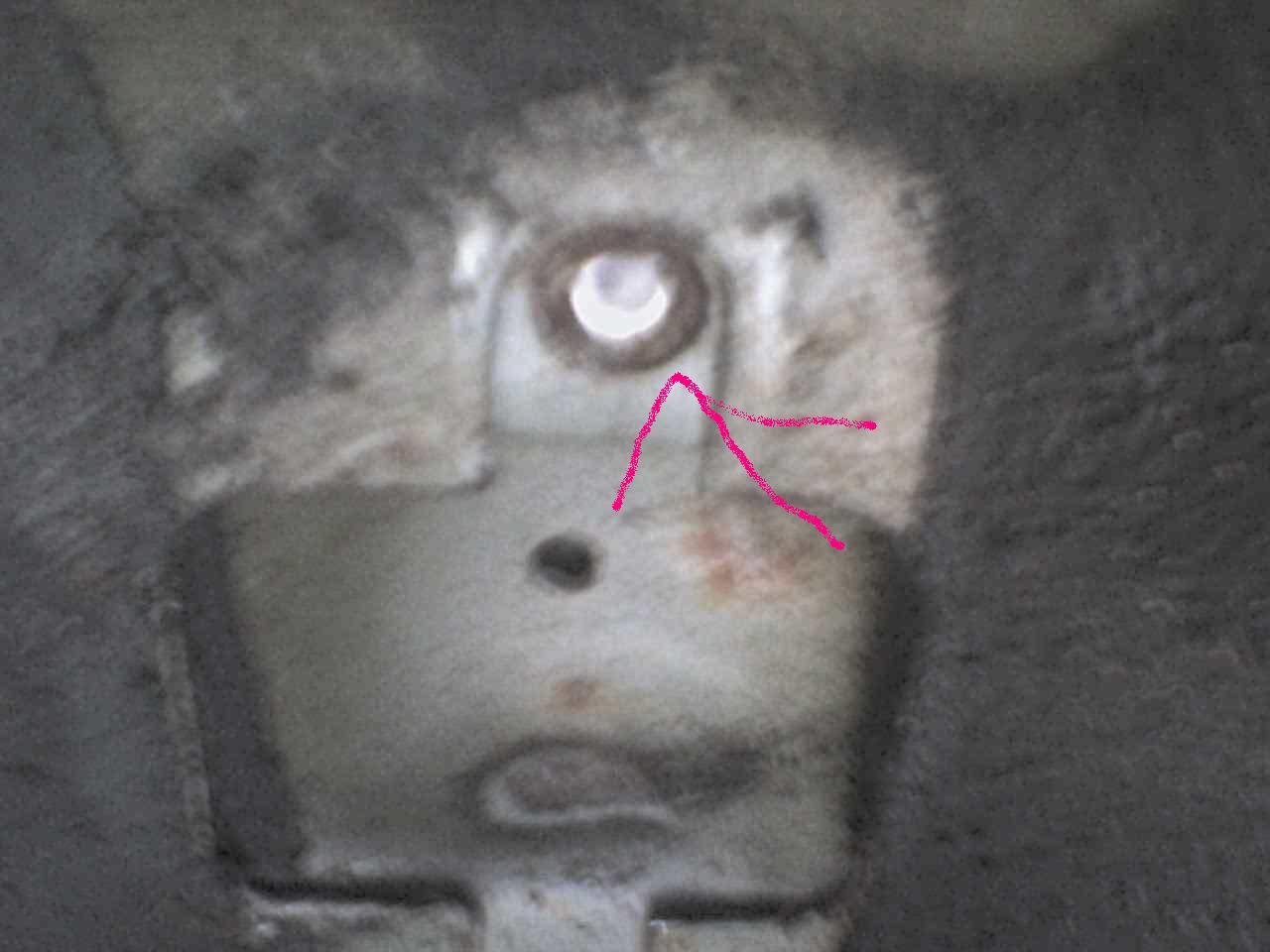

I just had my shocks replaced on my Jeep. After two weeks I started hearing a clunking sound every once in a while. I finally tracked it down to the top mount on the rear shocks.
The top mounting bracket has slid off of the bushing. It appears that the bracket the shock mounts to is too wide for the mount of the shock. I attached a picture in case my terminology is lacking.
The shocks are warranted so I will be taking them back to get them fixed but I was wondering if anyone else had experienced a similar problem. If you have, is there some way to permanently fix it? I am sure the installer can correct the problem but I don't want it to happen again. I can just imagine them saying that it is no problem, slipping the shock back on the bushing and calling it good.

The only time i've seen that happen is when the suspension has been subjected to an extreme offroad flexing. Other than that, i would ask for a new one rather than slipping on the old bushing back into the shock.
looks like a bad bushing was installed when it was made, Just ask for the new one and replace it...
You may want to consider JKS bar pin eliminators.
Those bushings usually have an hourglass shape to prevent that from happening, and they're often difficult to install. Looks like somebody substituted straight bushings for ease of install.

Awesome! Thanks for the help and the pictures.
I wish it had been subjected to "extreme offroad flexing"! I could have felt good about it failing then.
Thanks everyone. I took the Jeep back to the shop and they readily admitted that the wrong bushings had been installed. 30 minutes later they had replaced the bushings with ones that look like they will work. Shop stated that if it happened again they would try a different brand of shock. I really appreciate the advice.
