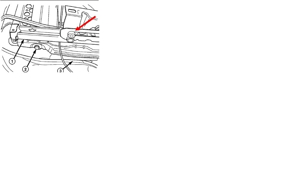

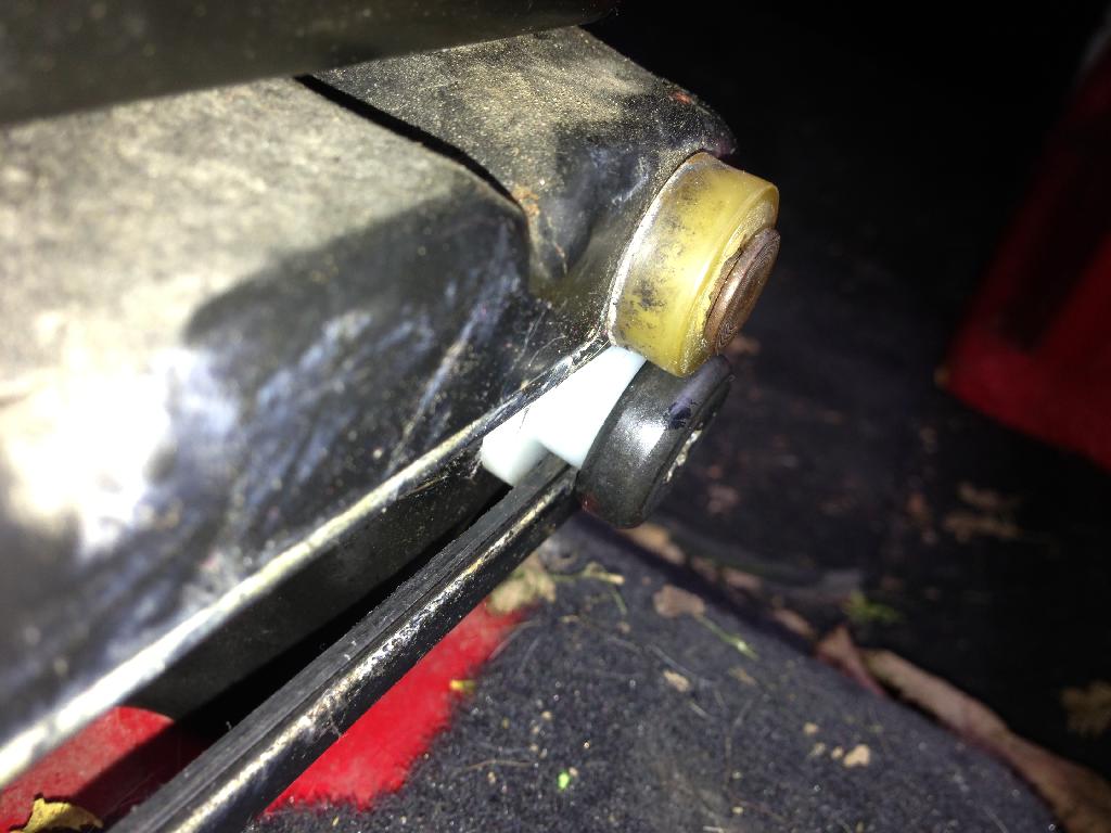

Check these. Two per seat
[/URL]
The white bushing is not oem it came from a hardware store and has to be thinned on both sides

Due to those bushing failing on mine I was shoving the seat really hard to move it. If you rock the seat and see play at that bushing it is worn. The hard part is there is another at the console that is hard to see and access. Hard but possible. If you swap the bushing the seat will be aligned and move easier. You may try a little lithium grease on the inside where the bushing rides and other moving parts.
Ps if you ever find where or if they sell that bushing let me know. As said I used one from a hardware shop that needed to be thinned to lign up properly.

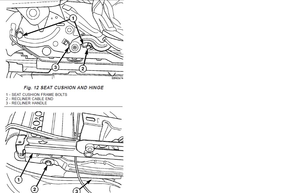

Ok sorry my images are all of a TJ. It may not apply.
