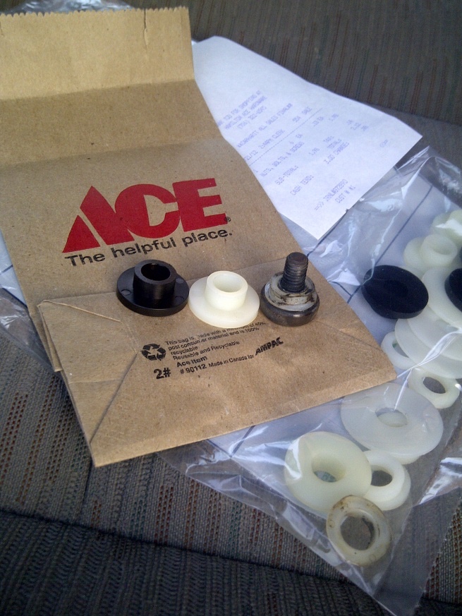

Old:
Yep is almost locks the seat in place. I bought Teflon shoulder bushings from true value. They needed some modification to fit. Was considering brass but I need a shop to thin them.
Having them in makes a world of difference when flipping the seat up and back.
