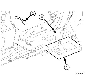

Thanks Mikey, any chance for a pic or diagram? I'm looking there but can't find what you describe. Either it isn't there or I simply don't know what I'm looking for. One is just as likely as the other. ;)
1 - Satellite Receiver 2 - Electrical Connector 3 - Mounting Bolts
It is mounted behind the glove box.
Thanks, I found it under the steering wheel. Looks to be all connected up right so i guess I'll be taking it to a dealership to figure out why it doesn't work.
