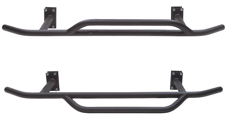

I'm looking for a pair of rock sliders that look cool, but offer a step for the wife. I don't really like the look of traditional 3" nerf bars, and have found these from Rugged Ridge:
What else is out there that wouldn't requre me to drill holes in the body?

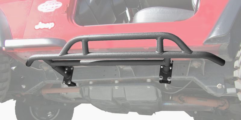

Terry, I think olympic 4x4 makes ones similar to the pic you posted, but they can be taken off, flipped up or down so you don't loose clearance off road.
If you hit a link to my web page you can see I have a set just like them, but I made mine with a little bit heavier tubing. The biggest problem is that rocks still slide in between them and hit the tub. I had to go with a set of rocker knockers to hide one bad hit from the wife, I would recommend that you all take a look at something along the lines like Poison Spyders Rocker Knockers A step and a rocker knocker built in.
I looked up the olympic ones, and I really like them. They just sandwich on the frame (no drilling, which I like). I may order the cheaper ones.
Cheap version:
and the expensive ones:
I don't think I'll give up too much ground clearance with these (with the loop up that is). I'll probably run with the loop down around town (to keep Erin happy).

If your going to ride with the step down for the wife, looks like you would be better with the more expensive ones. They have two bolts you remove to flip it over.

well, I went ahead and bought the rapid reverse steps (the more expensive ones). I'll post some photos when they get here. I'm sure they won't protect as well as the bolt on sliders, but I think they are better suited for what I want.
