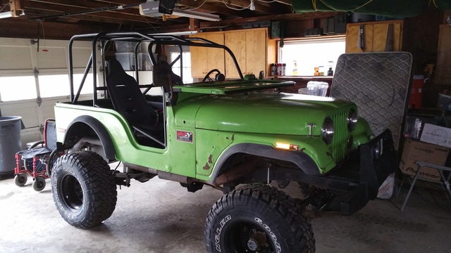

Got my new (to me) 1979 Jeep CJ5 Thursday. This is my 3rd CJ5, but the last one I had was when Regan was in office. I decided to start my build thread on the same day I took delivery, but please do not expect a complete build in a short time. You see I'm poor. Well, OK, maybe not poor poor, but I'm U.S. Army retired living off my VA disability, so there's not a lot of cash raining down on me.
My starting point is rough not only due it being a 38 year old vehicle, but the jurry rigged stuff done by others. Oh, I'll jurry rig stuff too, but there are some things I need to address. This thing was modified into a sand toy a couple of owners ago. Here's the good: She has a strong 360 under the hood with a 4 barrel, headers, a mild cam, and MSD ignition. Trans is a Torqueflite 727. Transfer case is supposed to be a Dana 20. Axles are from a full size Dodge truck, 4.88 geared and mounted SOA on 33x12.50s. They are Dana 44 in front, with lockouts, and 9.25 rear with a Detroit locker. They have 4 wheel discs brakes. Here's the not-so-good: No top, no doors, no heater or defrost, rusty spots to fix, and plenty of the aforementioned jurry rigged stuff.
She will not be a daily driver. I will use her as a weekend wheeling vehicle, but I do want to make enough changes to her to be able to take her on longer trips. I have visions of Black Bear Pass, MOAB, Drummond Island MI, and even Alaska... in 2019. Most of the time she ventures off the beaten path will be right here in good old Indiana. The Badlands Off Road Park is just an hr south of me. I'm going to do her up as a copy of an M38A1, but in desert colors like the vehicles I drove in Iraq. She'll probably get a soft top one of these days, but the plastic racing seats are going away by spring. My spine is too mangled up for anything other than good suspension seats. She is not intended to be anything other than a fun vehicle to go exploring in, and I'm not a good welder or fabricator, so don't expect to see top notch workmanship.

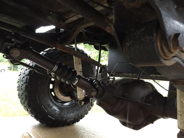

One more plus is the torque arms added to control axle wrap, and the rear end rotated to keep driveline angles down.
One more not-so-good is the transfer case was lowered what looks to be 6 or 7 inches in a custom built crossmember to limit front driveline angles, and not runs the risk of hitting everything. (I guess it don't matter in sand.) The crossmember for the front mounts to the torque arms is on top of the T-case, so that has to be changed too.

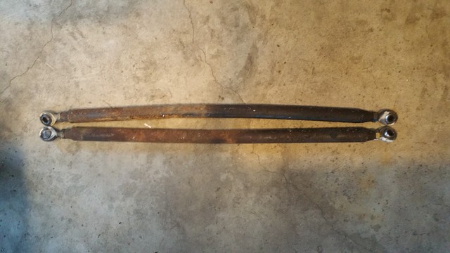

Hate to tell you this but the "torque arm" is marginal at best. There are several companies who make them, see how they design them, then compare to yours. I do love the Jeep though but you can expect some bad work done on these old Jeeps after so many years of different owners. My old Jeep is a '61. My last one was a '62. I have seen marginal work ! lol Good luck, keep going. One thing I really like about these old Jeeps is the lack of electronics. I've tried to keep mine that way and so far, just have electronic ignition.
The torque arms will be coming off later this summer. The transfer case has been dropped way too low, and the arms are mounted on a crossmember above the transfer case. Marginal is better than none I guess. I'm sure they help a bit, but I won't be blasting this thing like the kid I got it from. Just some slow trail riding. Not sure I'll even need them. Hopefully looking at a coilover swap if I can swing it, but that is just to soften up the ride a bit on my back. I don't need a shitload of flex for the wheeling I have in mind. I have several things to address.

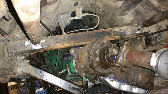

So I got the traction bars off. You can tell that the lack of a front shackle put them under stress by the fact that they are no longer straight...

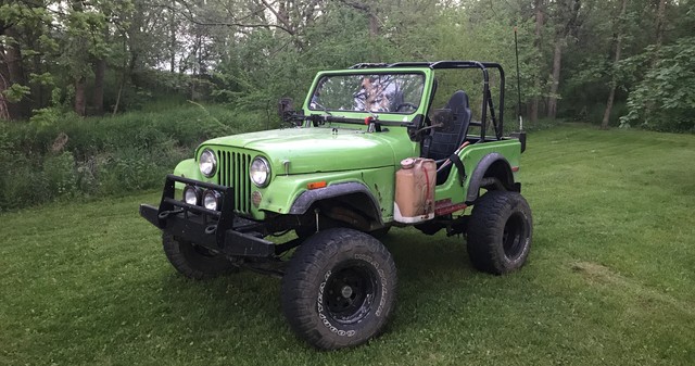

Here's a shot of my constant shadow Brandy and I last week on our first trip off roading in over a year. She is my 98 pound German Shepherd. (more like German Shedder) She is a service dog and is with me 24/7. The passenger seat will be replaced by a custom made platform for Brandy as she's too big to lay down on a bucket seat.

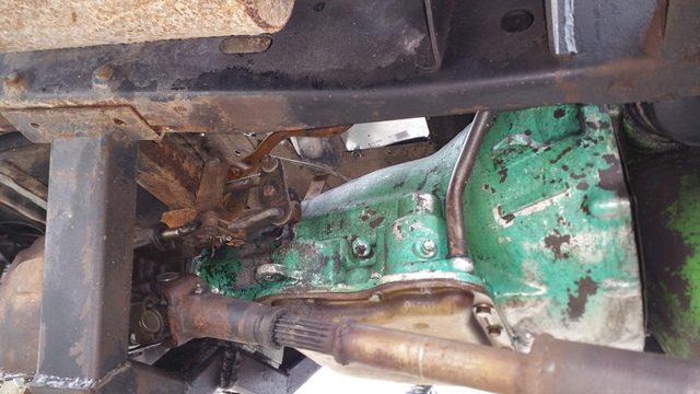

Got the JB twin stick cable shifter mounted, but can't get the transfer case to move out of neutral in the front drive. Shifter is good, T-case is messed up somehow. Worked 2 weeks ago... ???

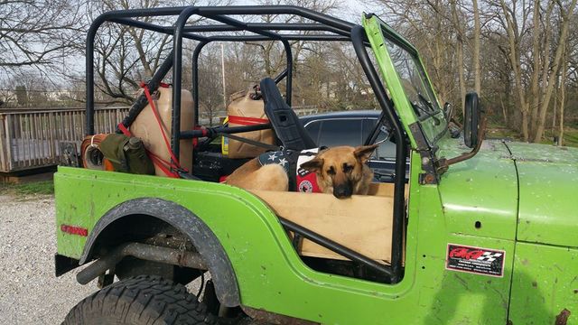

Took the front passenger seat out, and built Brandy a temporary front seat dog bed. I'll have to re do it later when I get my suspension seat and build the center console for the shifters, but it's good enough for this summer.

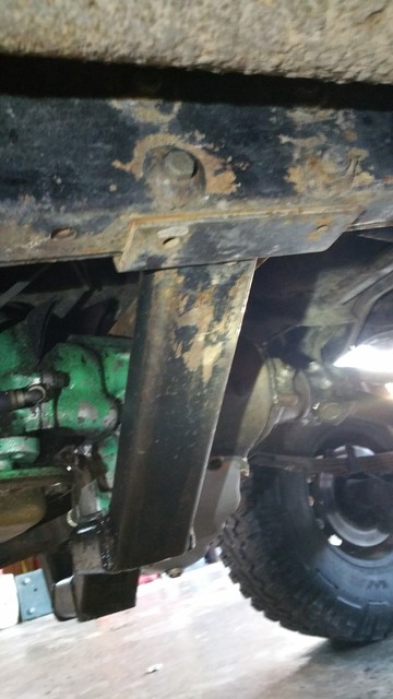

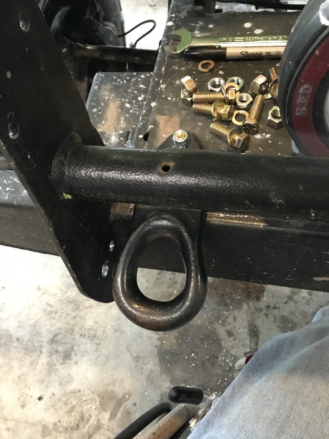

New front recovery points are off my old F250.

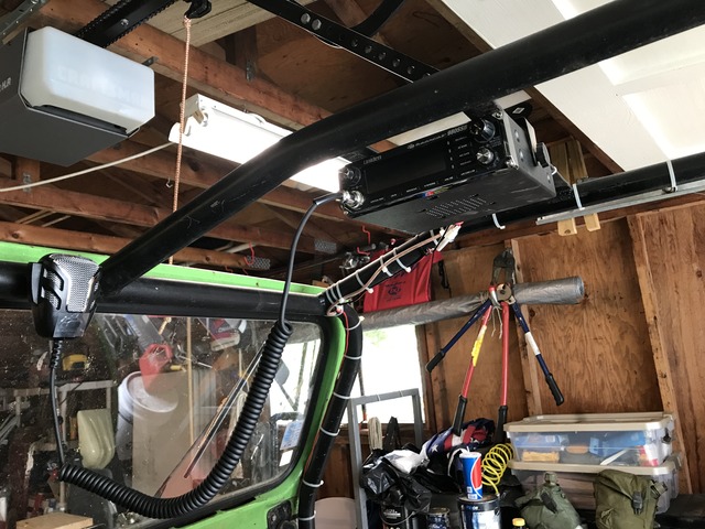

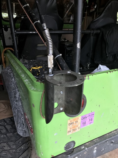

Put in a CB. Not many places to fit a full size radio in a CJ5. I welded a couple bars between the top runners on the roll cage. I used an old bracket from a military vehicle radio antenna.

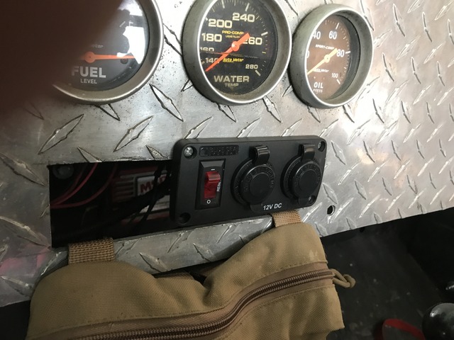

Installed a Blue Sea charging port in the radio hole in the dash. Can't wait to get rid of the diamond plate.

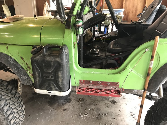

Steps make it easier to get in and don't cost any ground clearance. Jerry cans go mounted on the side. They can't hit anything as the tires stick out with the full width axles.
