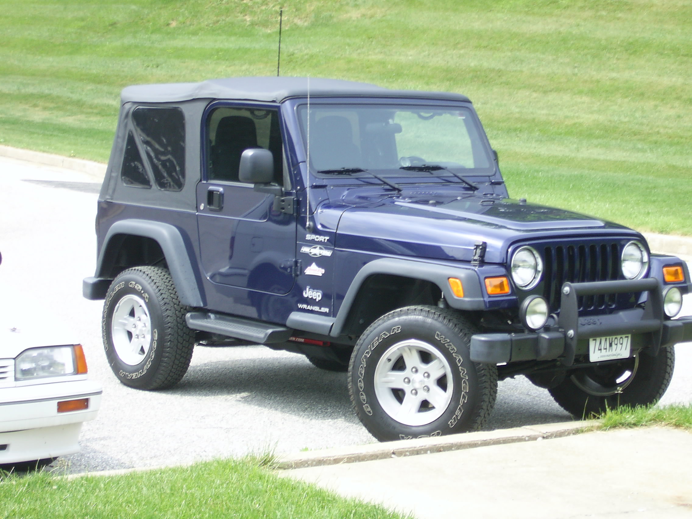

BTW, here's a picture of my '06 TJ with a 2" spacer lift on the stock 30" tires to give you an idea of what it might look like with smaller tires and keeping the lift.

2" lift with 31" tires does not look too bad.Also if or when you do go off road you will have no issue with rubbing then.

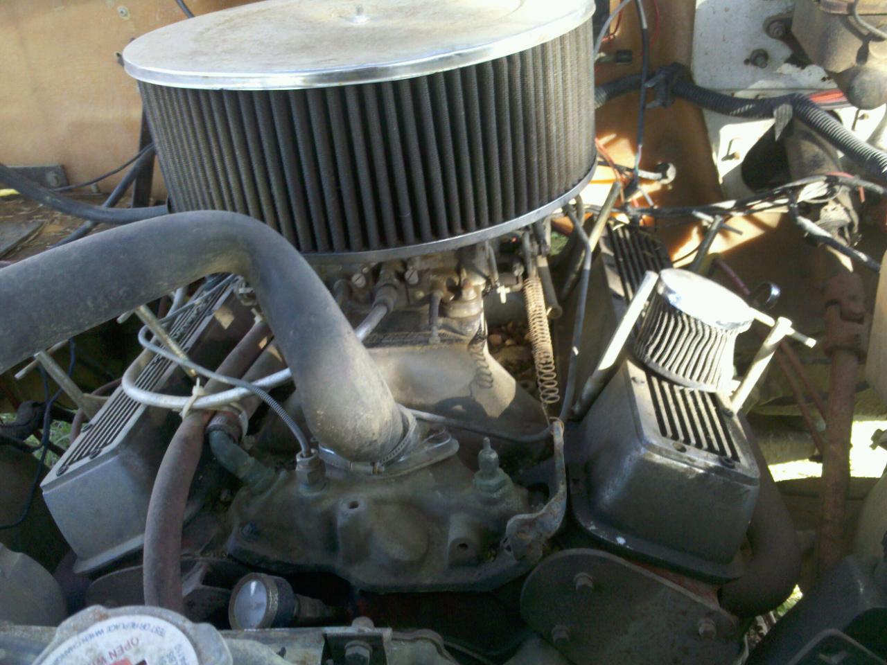

whatas gas mileage in a jeep i threw mine out the window the min i put the 383 in to it lol and 35's not to sound like a jerk but if i want gas mileage i wouldnt have baought my jeep thats what i got the buick for my jeep is a daily driver it sucks the fuell but it will go where ever i point it and not complain about it for the mileage differance between 33's and 31's i would personally leave the 33's on it when was the last time your jeep had a complete tune up
