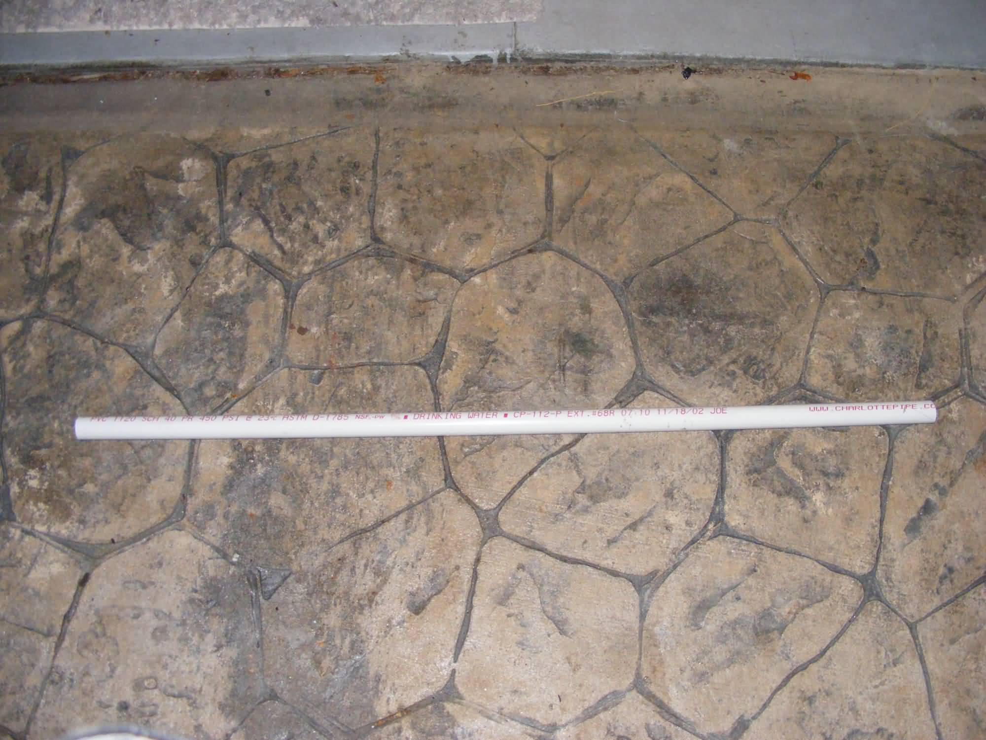

One foot of PVC pipe
A handsaw to cut the pipe

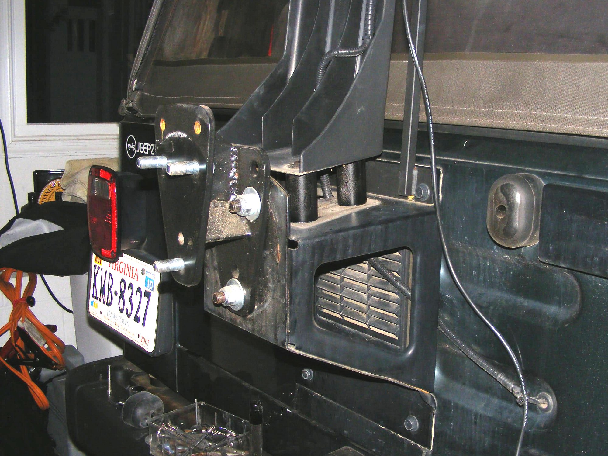

First measure how high you'd like to raise your third brake light. Most likely you'll need another 1 or 2 inches (for a 33" tire).

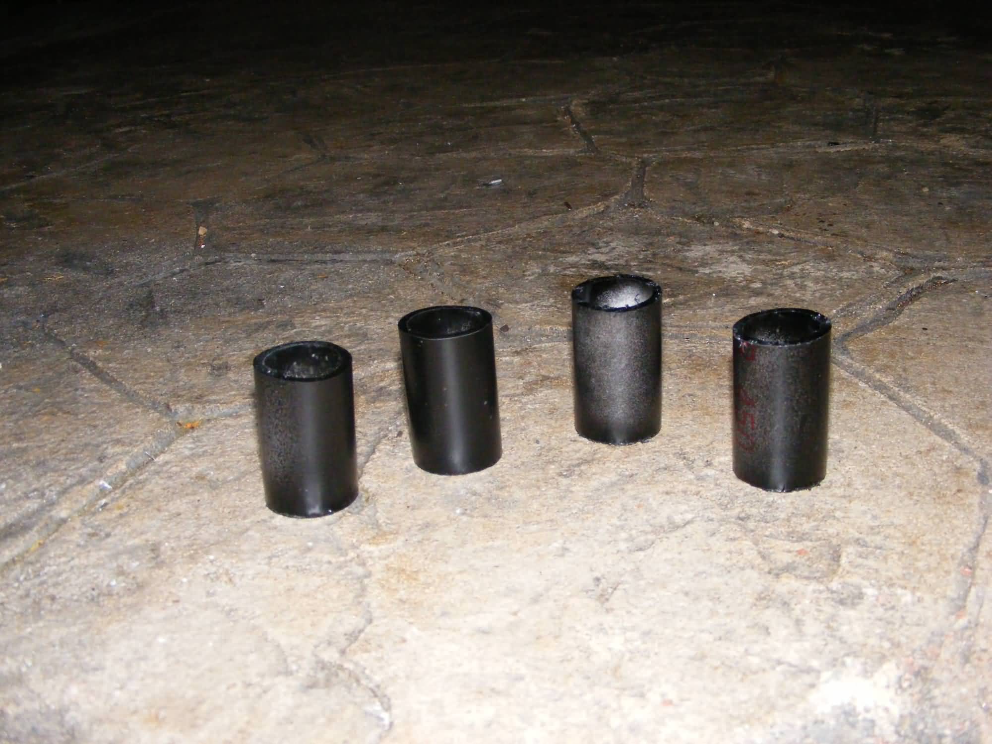

Then cut your PVC pipe to length
Spray the pieces black (or any other color).

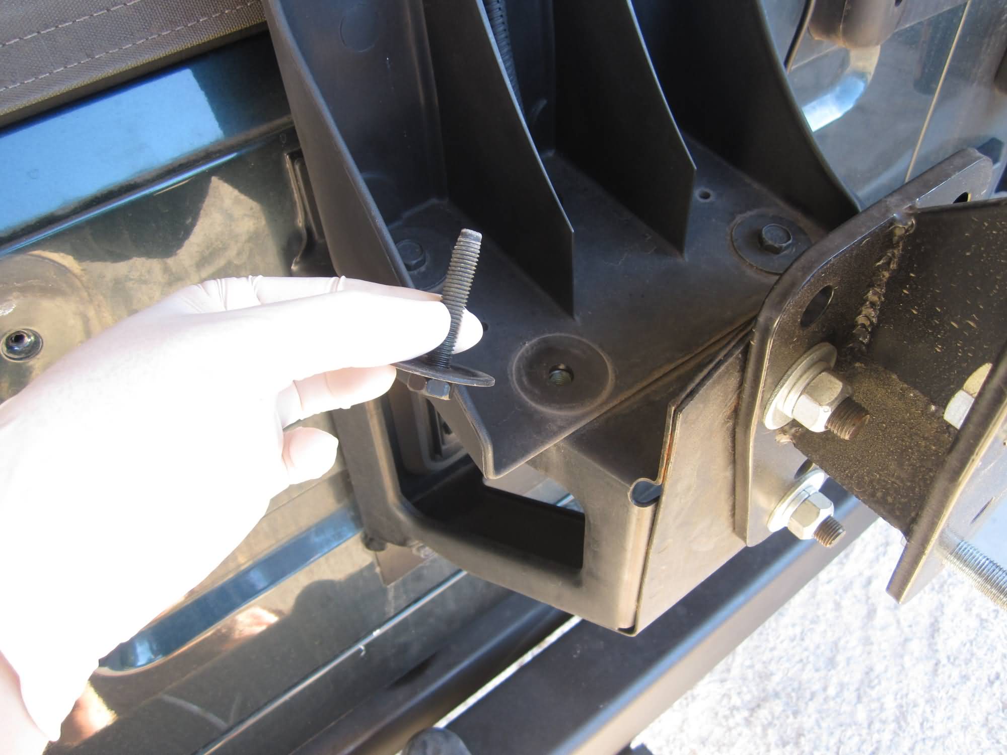

Now, unbolt your brake light
And install the new spacers, bolting it up with the new bolts.
