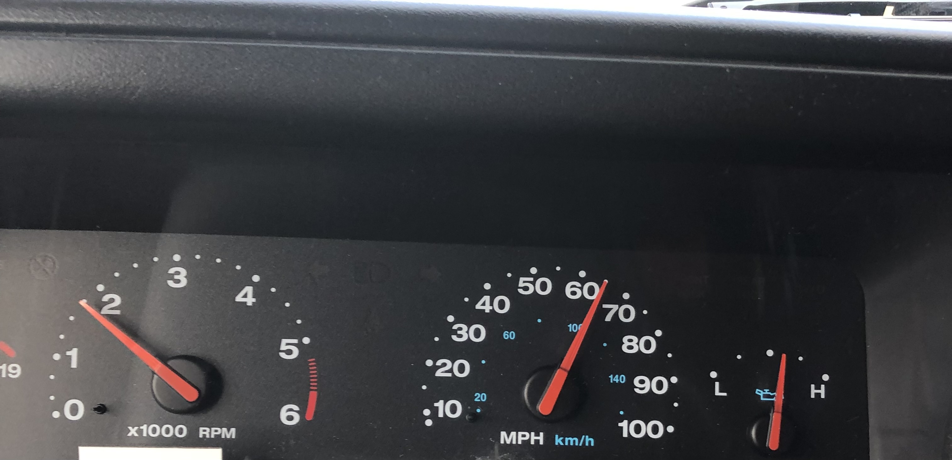

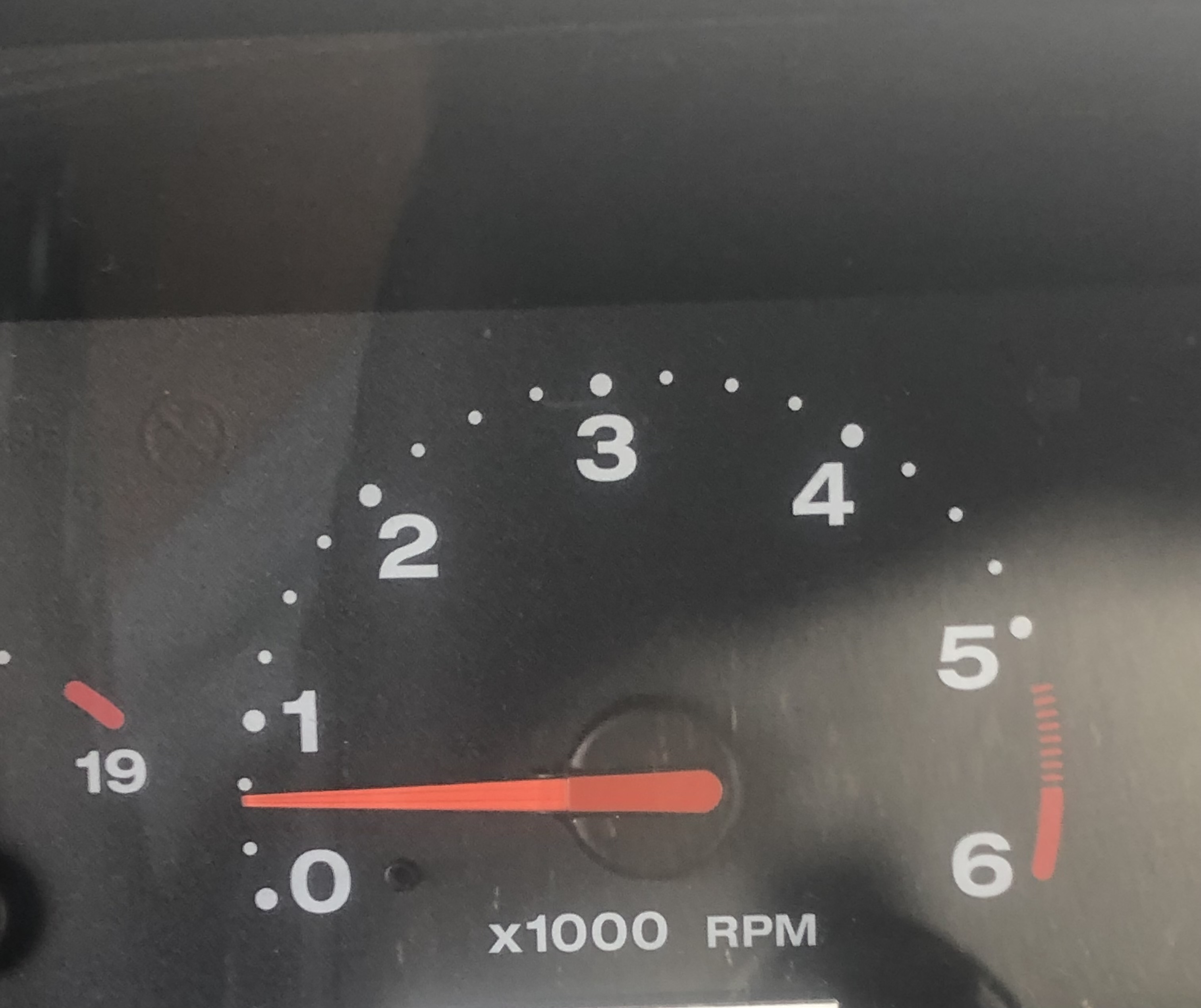

Hope it goes well! That is where you should idle 750rpm.

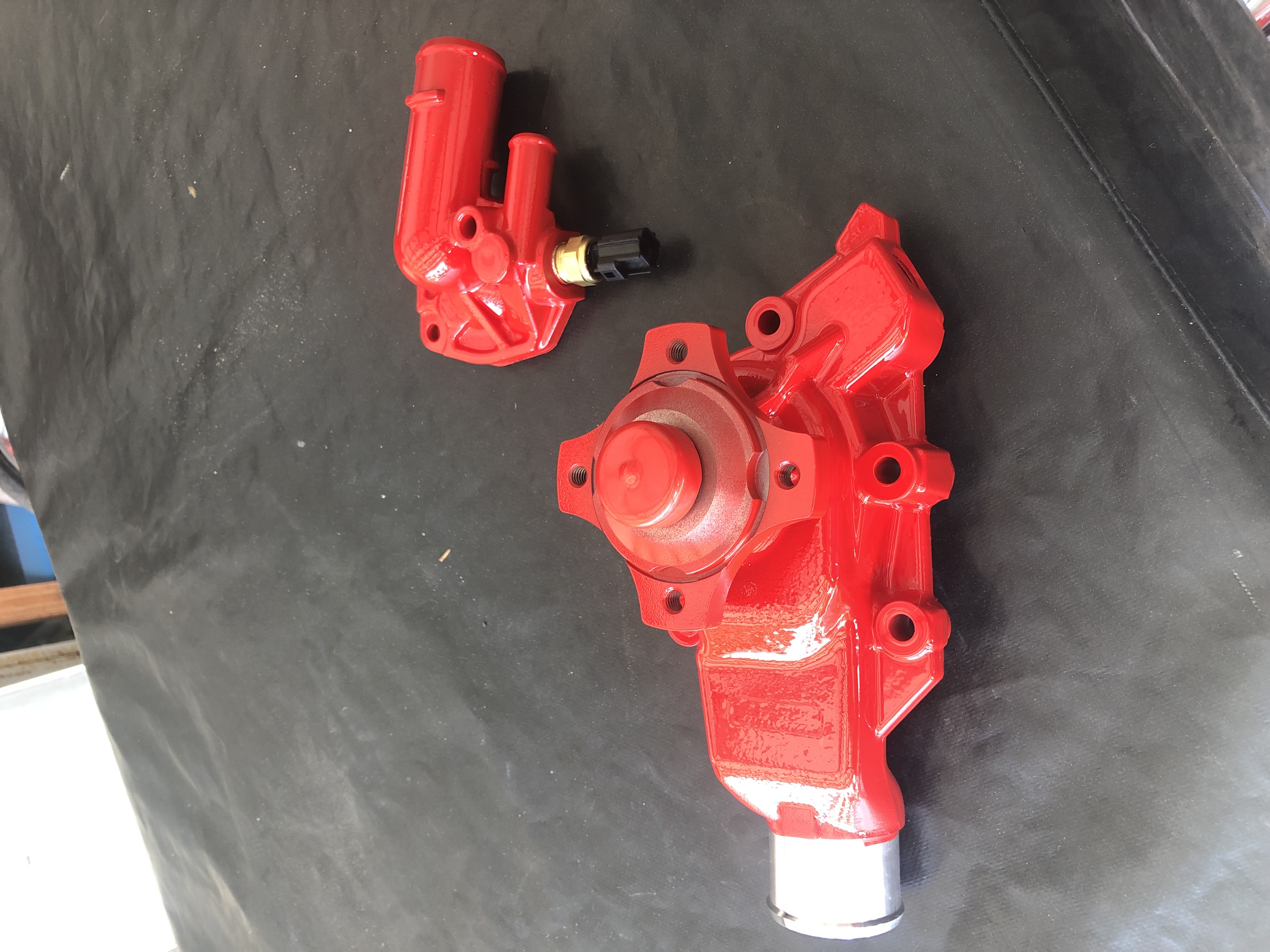

68858399154__2961FB06-EA34-4FFD-9CB0-59676EBA373E.jpegI will be tearing into the project Tuesday. I have been prepping everything before hand. (painting thermostat cover, water pump )
installed new temp probe into new thermostat housing.

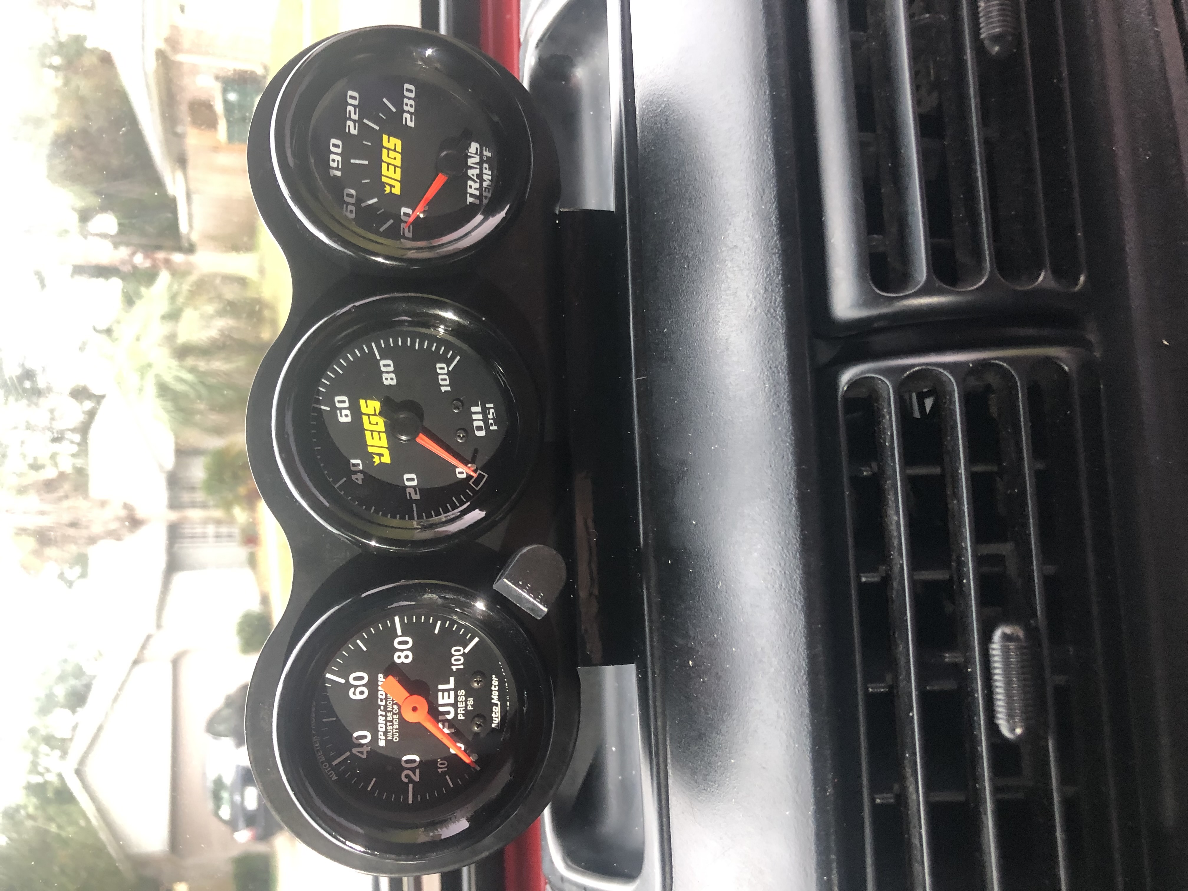

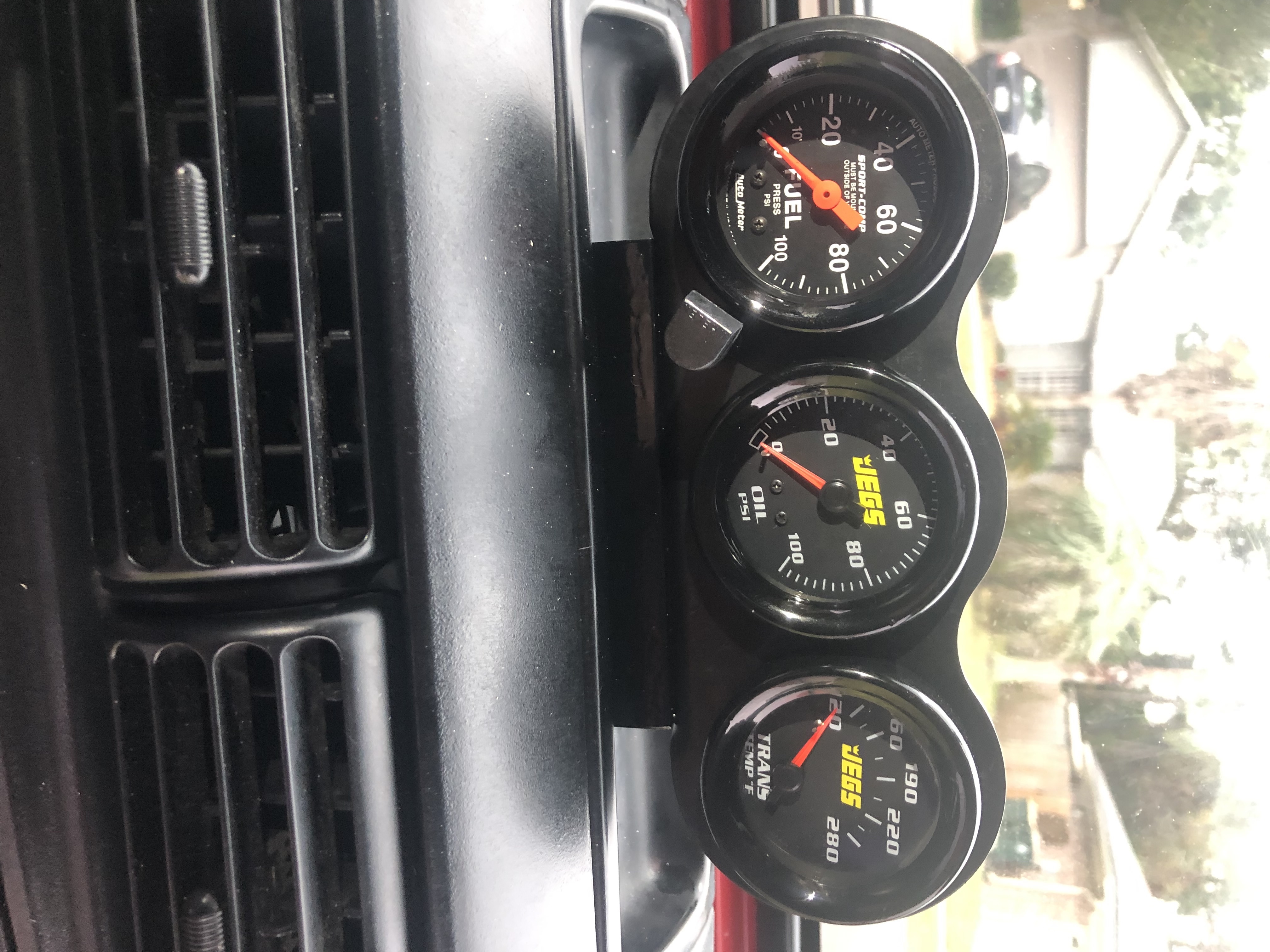

Adding this instrument cluster as well. Will be adding a large capacity Transmission sump cover with a temp probe. As well as a hard line engine oil pressure gauge.

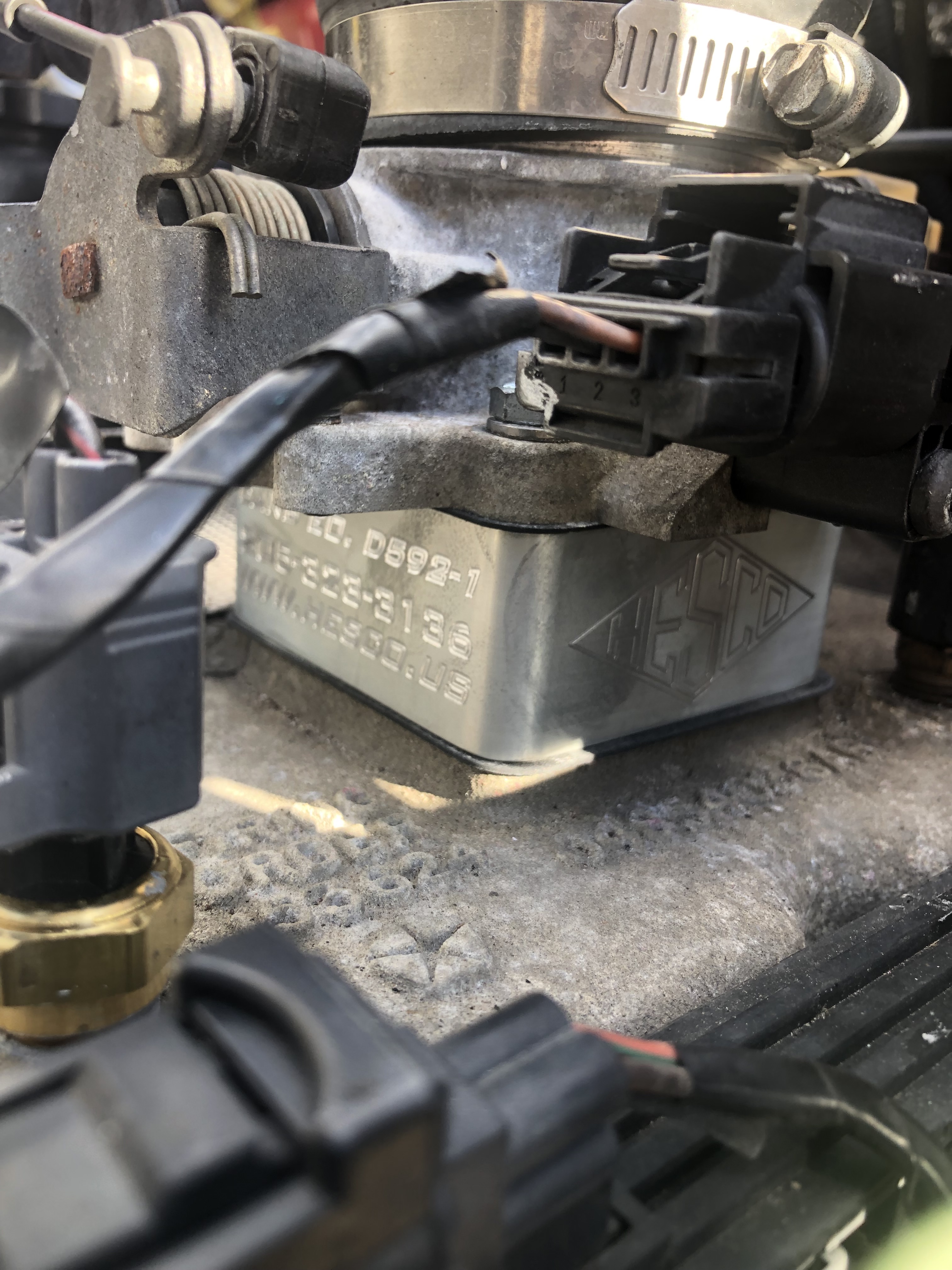

Have installed this 60mm Throttle Body Spacer. Will be installing Harland Sharpe Roller Rockers, P/N: S40196 this week as well along with the new Flex - A - Light Fan

Return the TB spacer. It does nothing
Nice
Sent from my SM-G965U using Tapatalk
Just being honest. In 05 I bought one. Did nothing for the 4.0 engine. There are several threads and dyno research on this.
While it still could be returned, I recommend that and spend money elsewhere.
The extra wide makes no difference because the intake opening is smaller and the TB opening is smaller and tapered.
Same doesn’t apply to carbureted engines.

Removed the Throttle Body spacer.

I'm still chasing potential issues. As I noted, I've added a hard line oil pressure gauge. When the engine has warmed up, the pressure drops to below 10 psi at idle. I have a high volume pump to install this week. While I have to Oil Pan removed I will check the main and rod bearings as well as the timing chain assembly.

The spec for oil pressure for the 4.0 is as follows:
*Not less than 13 psi at HOT idle
*Between 37-75 psi over 1600 rpms

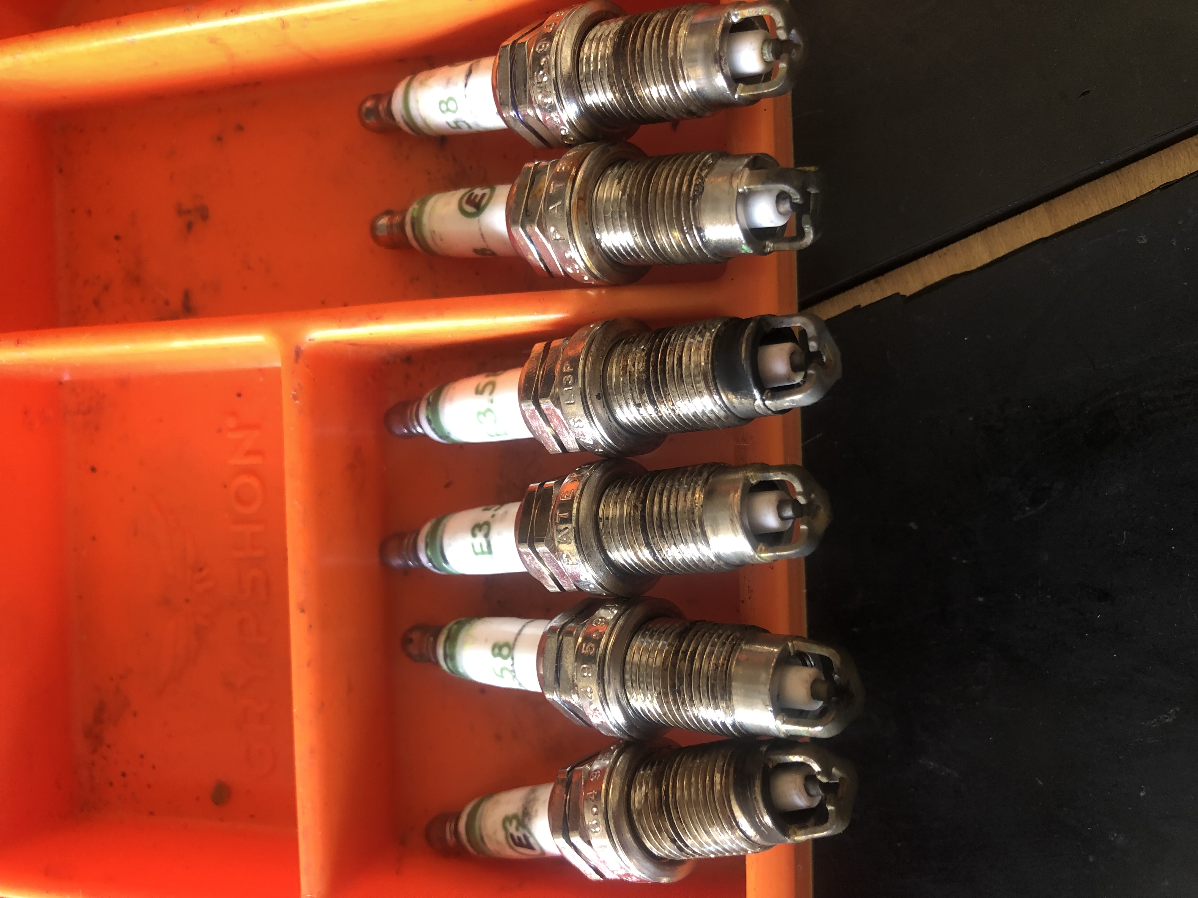

Removed spark plugs. The ones I removed all look good. less than 1000 miles on them, installed New.

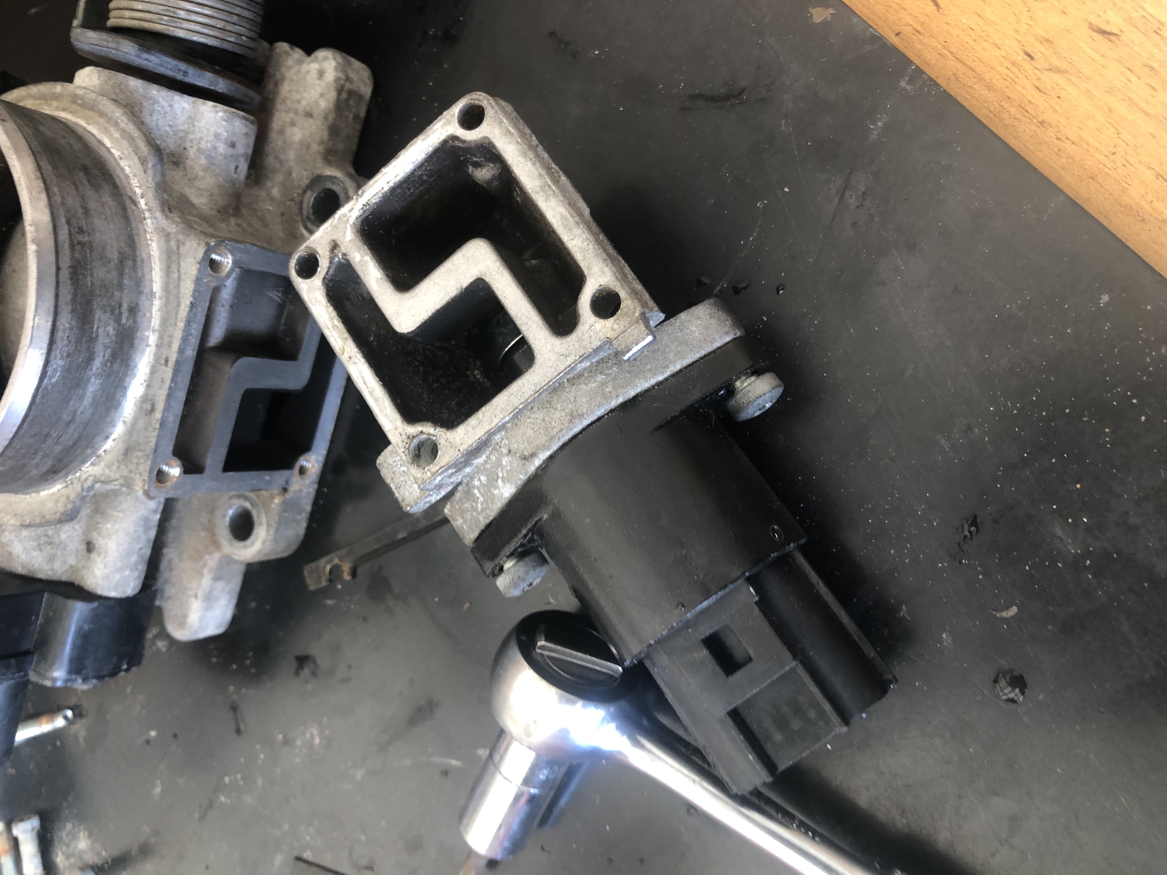

Plugs can show if you are burning rich, oil, or water. That is why I asked.
From the top the 3rd and 6 th are a bit sooty on the outside. Not on the ceramic.
So #3 is not burning water. If it were it would be steam clean.
