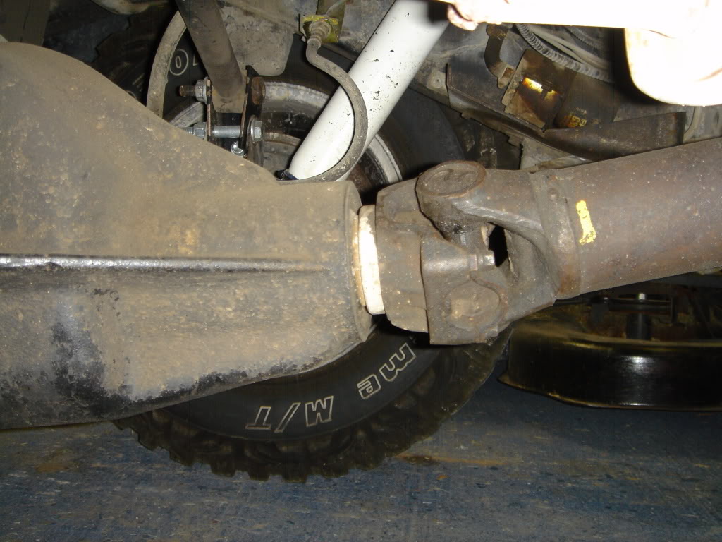

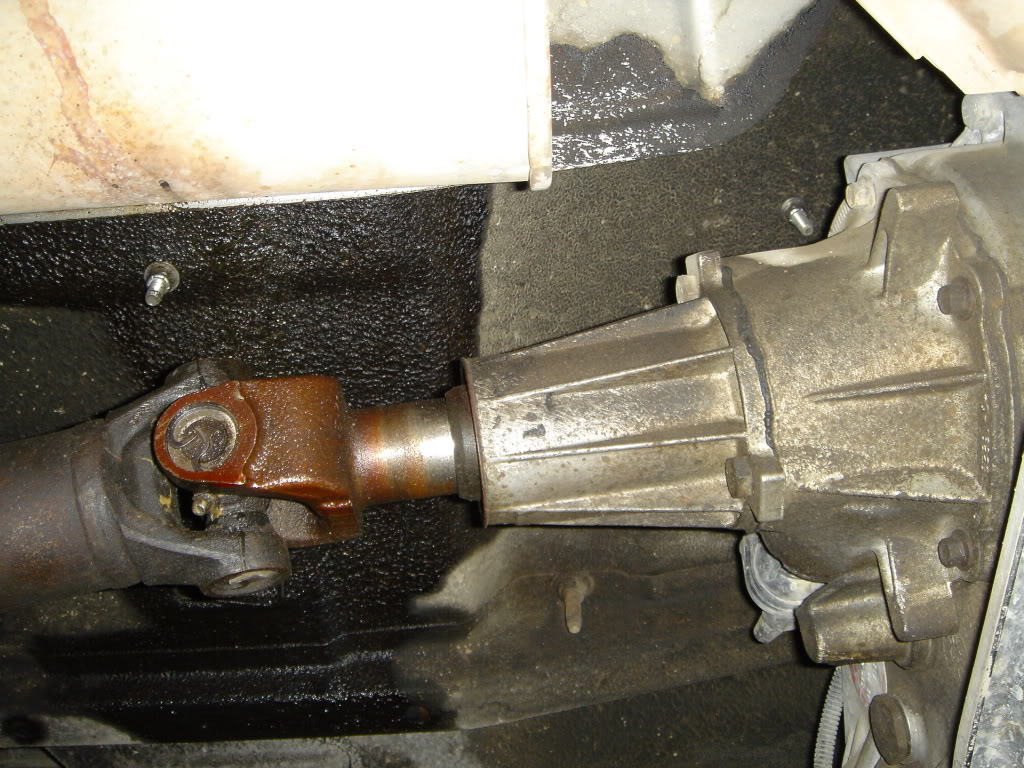

Ok I checked the u bolts and all is with in spec so I took some pictures to show the angle of the drive shaft. Does everyone still believe its axle wrap? If so what is the cheapest fix? Will the traction bar that Buckshoot500 mentioned fix this?

Pinion angle is everything. After looking at your pictures I have to ask, was the leak there before the lift? If not, driveline vibration caused it. If this were my rig, the first thing I'd do is a slip yoke eliminator kit and a constant volocity driveline. This will lengthen your driveline for a better angle. YJs have tiny little drivelines. Generally, axle wrap or hop isn't a problem with spring under axle lift kits, unless you have 6" mono springs. I'm not saying it's impossible, just not probable. Skyjacker yj5lk is a nice traction bar, if you're leaning that direction. It's about $383 and requires minimal amount welding. SYE, CV driveline. Hope these sugestions help.

He sees it at the tail shaft where the slip yoke is...but it doesn't look like a couple inches to me. The bright metal is where the seal normally rode. The shaft is about 1-1/2 or 1 3/4. Compare shaft diameter to bright spot gives him about 1/2 - 3/4 shorter. Same as when I did my 4" lift. I had no problems with axle hop. Drive line angles bad enough to get wheel hop would be some EXTREME vibration and highway speeds. The angle coming off the pumpkin looks (from the pic) a little more than the angle at the slip yoke, but not enough to bind up in my opinion. I think he's got a different problem here. Why does it only do it after being driven for a couple of miles? I'm gonna take a wild guess here. Are you sure you got the alignment pins on the springs right? Maybe the u-bolts are tight but the springpack is not sandwiched down tight to the axle (alignment pins holding a gap) and your torqued right, but the spring pack is still loose. Still doesn't explain why it only does it after a few miles though. Good luck!
