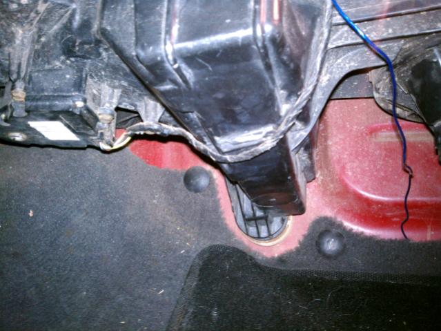

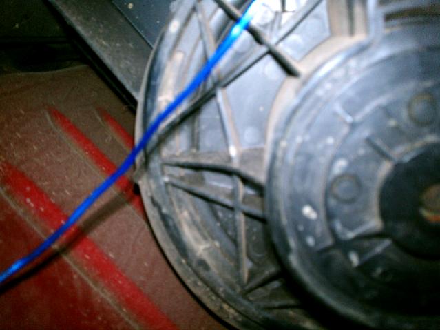

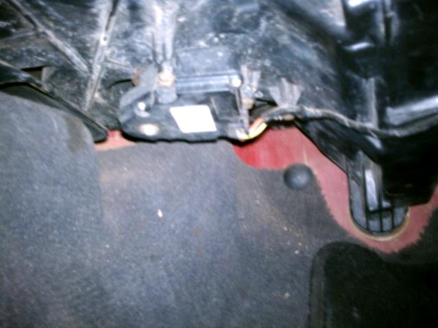

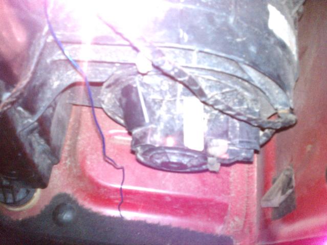

Sorry about the quality, these were taken with my phone in the dark parking lot while I am at work. I hope what you need to see is captured in Tue photos. If not let me know and I can retake them with my digital camera when I get home.

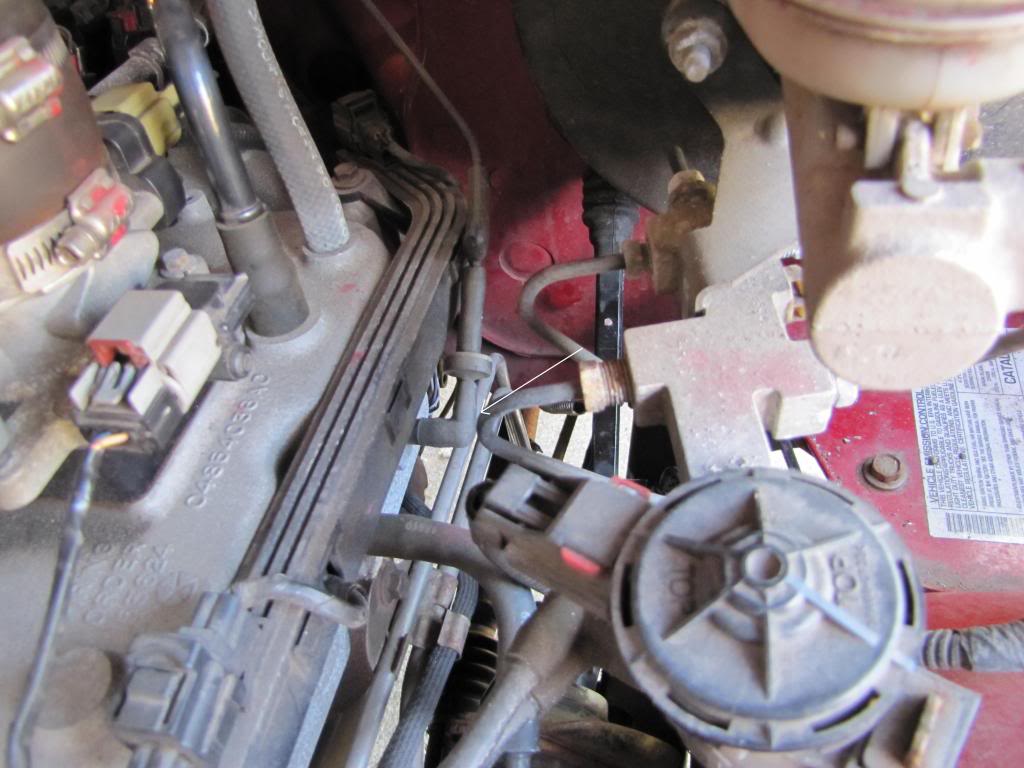

This is the vacuum line they are referring to. The line comes out of the intake across the firewall and enters the cab near the PCM. The rubber connecors are usually what fails. Although, I would think you would only have one vent output no matter what vent setting you selected, if the vacuum line failed. Worth looking into though.
your jeep is set up different then mine. so i cannot help with those pics. i don't even see any doors

It appears from this picture that the door actuator is electronic, not a vacuum controled actuator. there's 2 or maybe 3 screws holding this to the HVAC housing. If you remove this, you should be able to move the door open and close manually by hand. If there's any obstruction or binding, you will feel it.
