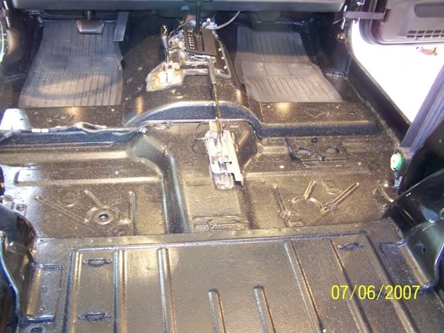

That is the same liner I used. I originally bought mine at walmart to put on my boat trailer. Worked great for that, so i decided to give it a try in the jeep. Mine didn't have carpet when I bought it anyways, but if it did, it would have came out and the liner would have went in. I only put one coat in for now, but I am going to put 2 or 3 more layers in it when I get the time. I a very satisfied with it and especially for the price. You may want to get you an extra few of those small rollers because they are one use with that stuff.
I used some fine grit sandpaper and scuffed up the surface. (Mine was factory gloss black) so I was afraid it wouldn't stick. it's been over a year since I put it on and no compaints at all. It's not chipping up anywhere either.

It's not soft at all. Once it dries. It is really "Gritty" and strong. I've never seen the Rhino on anything so I can't judge between the two. One coat did pretty good. I would like to put at least two more on there sometime, but it is sealed pretty decent just for the one coat. It would scrape your elbows if you where to rub againts it.
For the money I've saved on the price of 1 Gallon of the Duplicolor bed liner. I've been able to paint my boat trailer and the inside of my jeep and I've still got 1/4 of a gallon left. I think it's good stuff.
