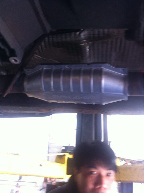

I checked the o2s all seemed fine but I detected a leak coming right from the cat was welded (before the cat)! Could that be the reason?
