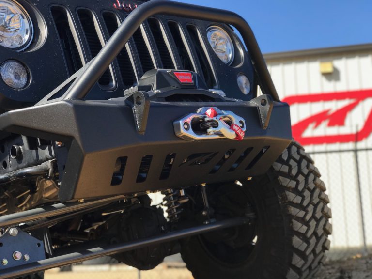

The factory steel bumpers that come on the Rubicon Recon are pretty nice for a stock Jeep but no where near what this Jeep deserved. Tim’s first decision was to remove the factory front and rear bumpers in lieu of some HD Motobilt Crusher series bumpers. Tim not only chose the new Crusher series of bumpers for its quality and strength but it’s many features.
The first was the ability to recess the winch down into between the frame rails yet keep it safe with a built in skid plate. Besides the killer look the recessed winch design allows for the grill to remain unobstructed and thus can help keep cool.
The cut out slots on the lower portion of the bumper not only look great they also function as lifting points for use with a high lift jack. With the multiple slots you can rest assured you will have a stable and safe location to use when you do need the assistance of a high lift jack. Tim also opted for the stinger version of the Crusher front bumper to help protect the front grill of his Jeep.

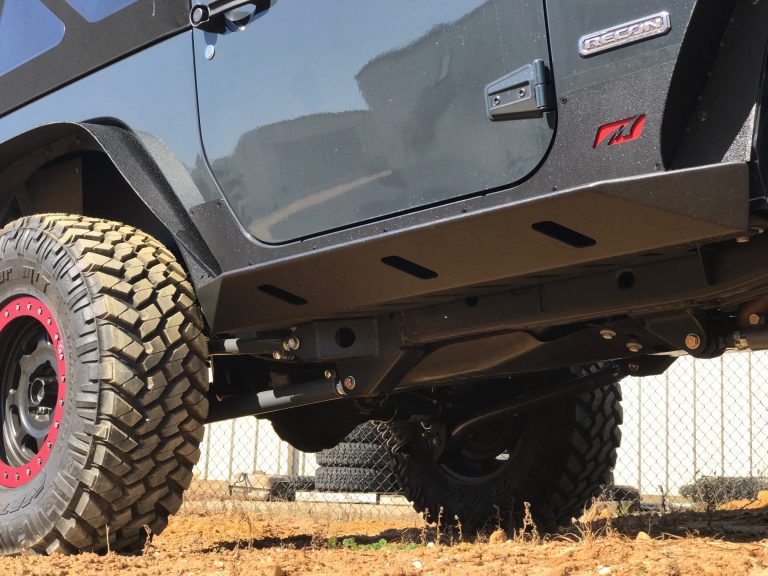

Tim and his wife who has a JKU her self like to adventure into the back woods quite often. Having a secure step to get in and out of a lifted Jeep is great but quite often is a sacrifice to ground clearance as they drop down and act as a grapple hook for the rocks and ground to hook onto. Tim new he needed a step for those slippery situations on the trail but didn’t want to loose any ground clearance or body protection. Therefore a set of Motobilt Jeep JK rocker guards with built in steps were installed. The Motobilt steps/guards provide complete protection from the side panels all the way underneath to the side of the frame. Just like the front Crusher bumper there are 3 lifting points for a high lift jack.

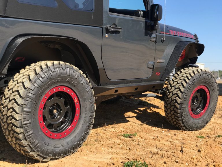

One key aspect of the build was the choice of tires and wheels. Tim new this recon needed some 35″ tall tires in order to tackle the types of trails he likes to hit. So he chose a set of 35″ Nitto Trail Grapplers for the excellent ride on the highway with plenty of off road capability. Operation Recon like any good mission has to be well planned out, so we knew a set of tires were no good if you had a flat. Therefore a set of American made Trail Ready HD beadlock wheels were chosen. These wheels are a 17×8.5 with 4.5″s of back spacing. The use of a true beadlock will ensure this Recon stays on mission.

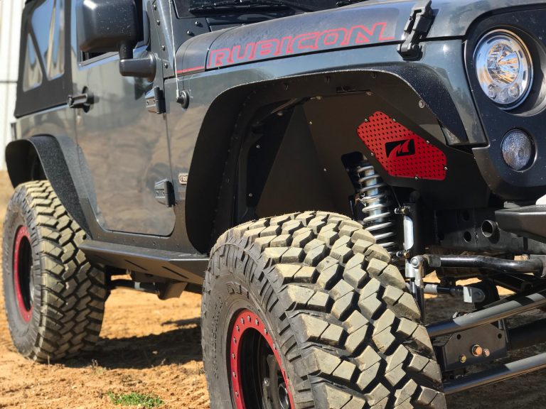

In order to clear 35″ tires and be able to have room to fit with them off road a 3.5″ lift was necessary. Tim also knew that one day he would eventually upgrade to a set of 37″ tires so a set of aftermarket fenders were installed to give that extra clearance needed. The only major issue with any aftermarket flare for the Jeep JK is that they leave the inside wheel wells in a less then desirable shape. Either the factory plastic liners have to be modified or completely removed leaving the engine compartment open. In order to combat this a set of custom Motobilt inner fenders were installed front and rear on Tim’s Recon.

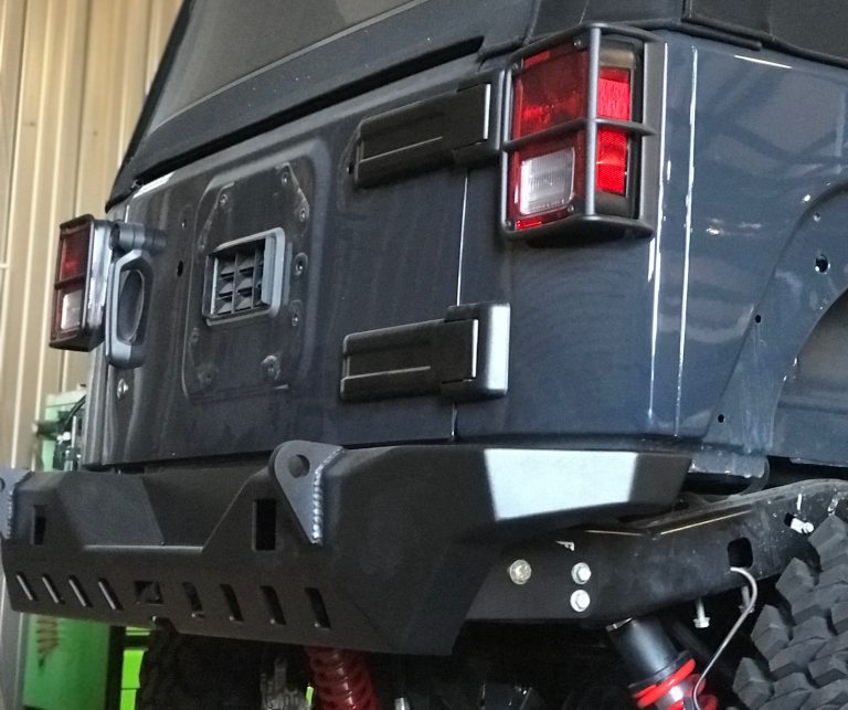

To finish out the protection and recovery aspects of Operation Recon a brand new Motobilt Jeep JK Crusher rear bumper was installed. The first of its lineage this Crusher not only matches the clean off road lines of the front bumper. The rear Crusher also wraps around and protects the full corner of the JK while maintaining the most ground clearance possible with its unique bumper ends.
Just like the front the rear Jeep JK Crusher bumper has 2 secure d ring mounts made from 3/4″ laser cut steel plate that pass through the bumper and are welded on both sides. Also there are 8 separate high lift jack points on the rear alone. The JK Crusher rear bumper features a drop down for mounting clearance of a large spare tire. Last of the many features are mounting locations for rear face led cube lights in the 3×3 square variety.
