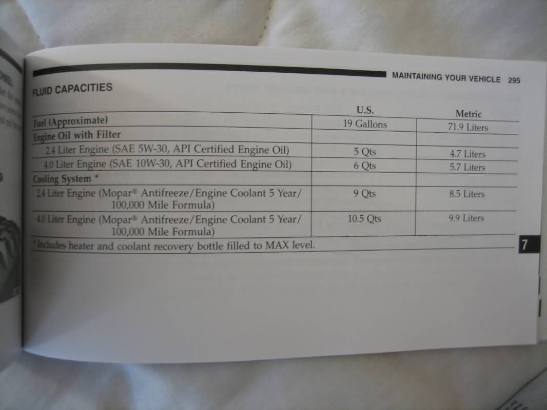

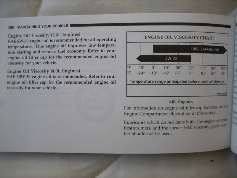

I run Mobil 1 full synthetic, and use the weight that my manual recomments:
