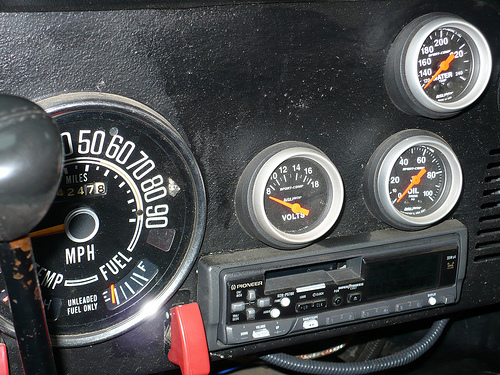

X2 to Dave's post, in all my rigs I've either added or swapped out for Auto Meter, VDO or other quality mechanical gauges, they may be more of a hassle to set up but nothings' more reliable.
once i figured out the sender was the issue and my factory one started working, i removed the mechanical one that was hanging below the ac vent. they read the same for a week because i wanted to make sure the factory one was reading properly.
