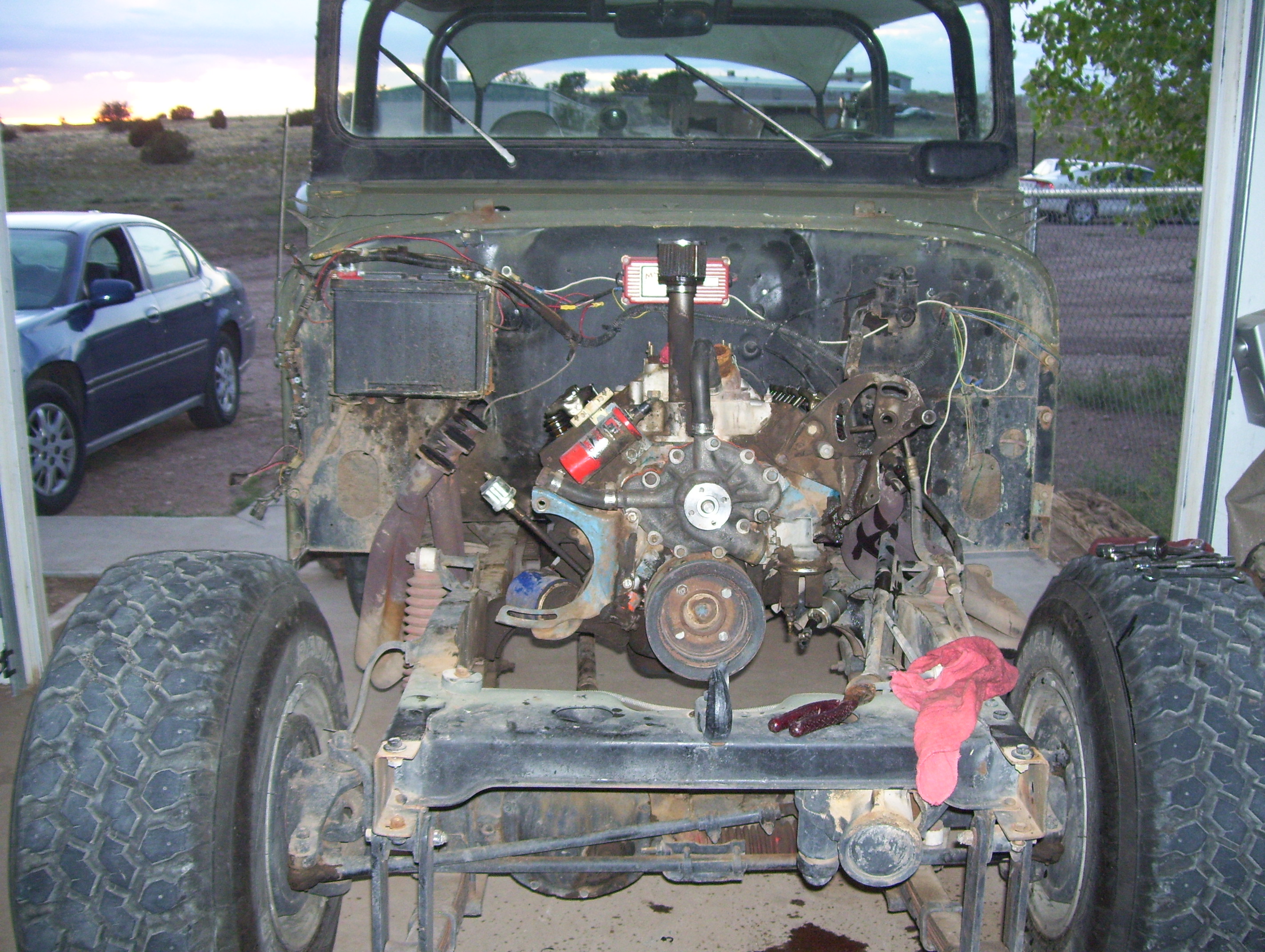

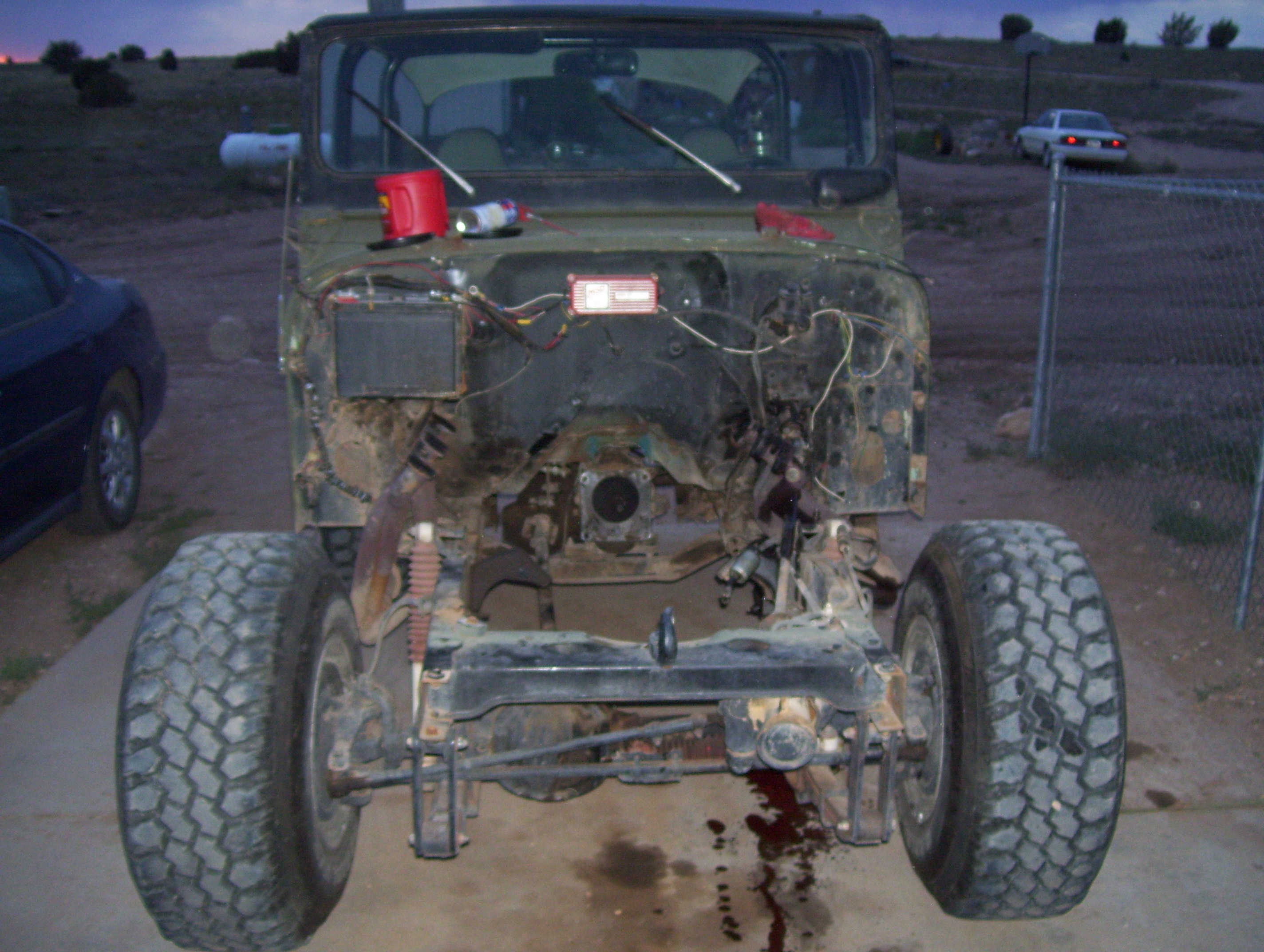

it's out now time to get busy..

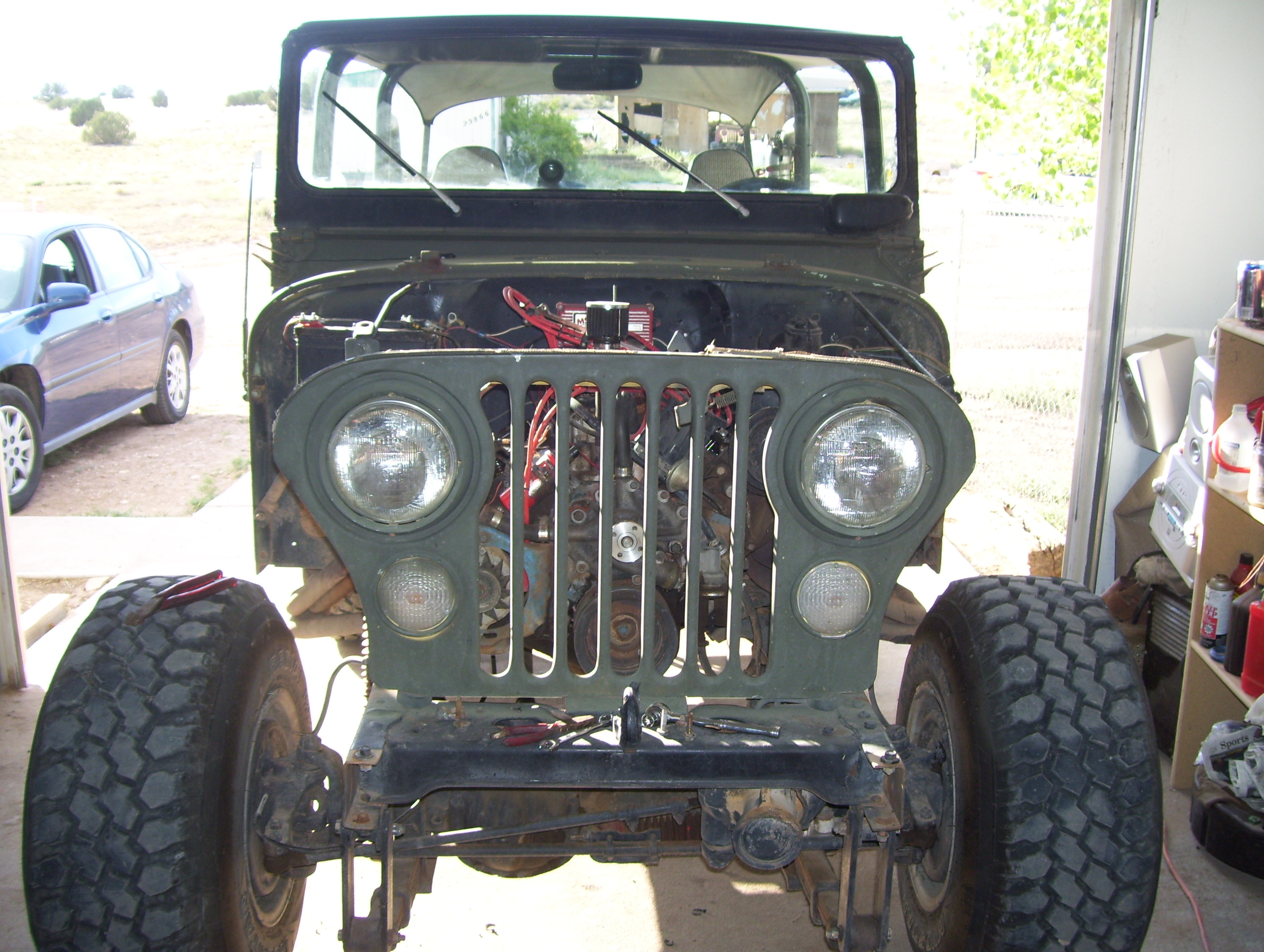

Nice to see pictures but I’m a little concerned about the long shackles on the front leaf springs; any troubles with the steering being sloppy?
Saddle Tramp,

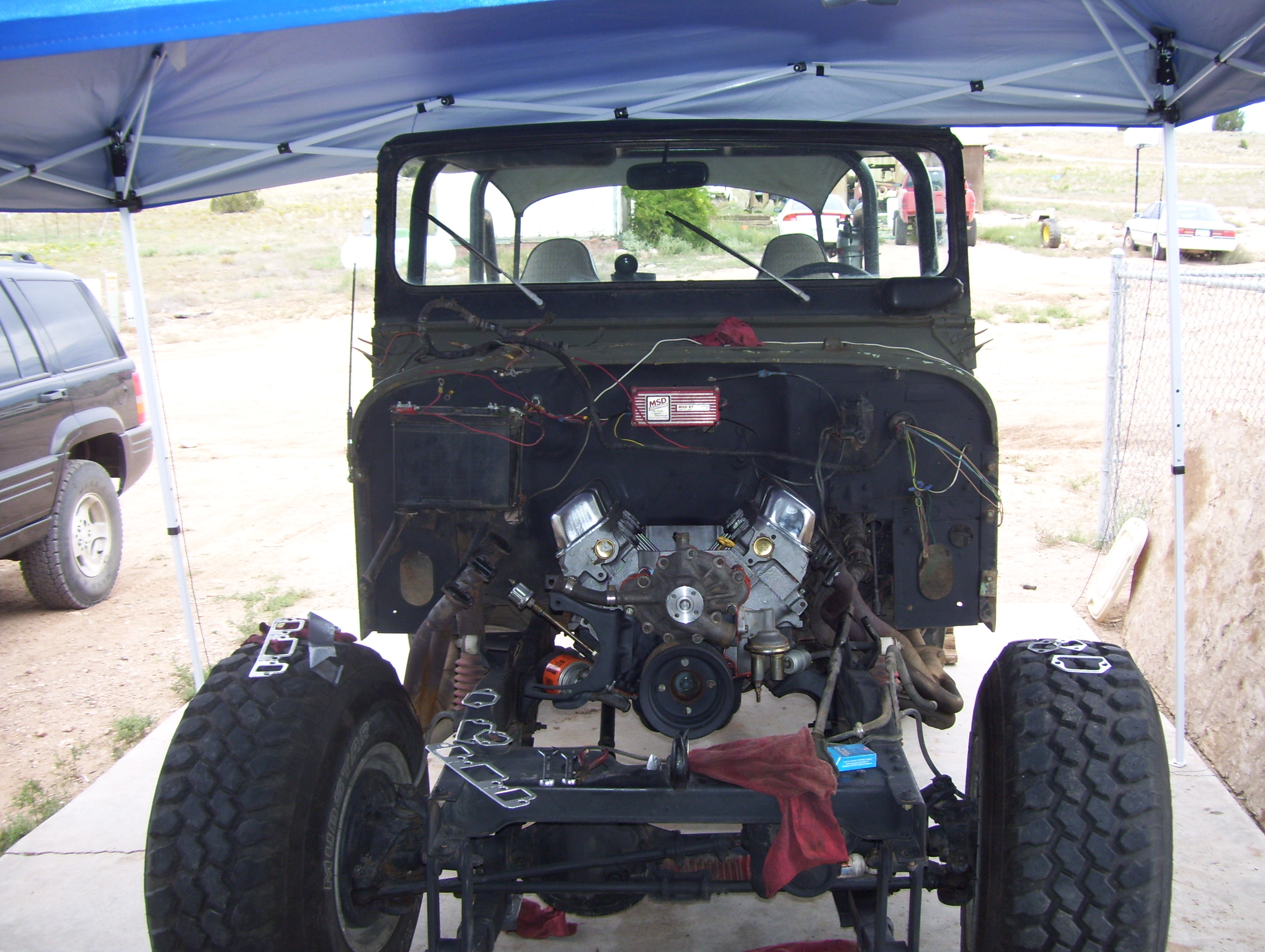

Actually the steering is not bad. but i will be changing the shackles soon I did get my new motor in and running.
