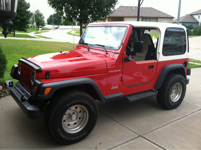

I'm running 30X9.5X15's on stock suspension with no rubbing at all. There is clearly room to go to 3X10X15's which will probably what I'll put on next time it needs tires.

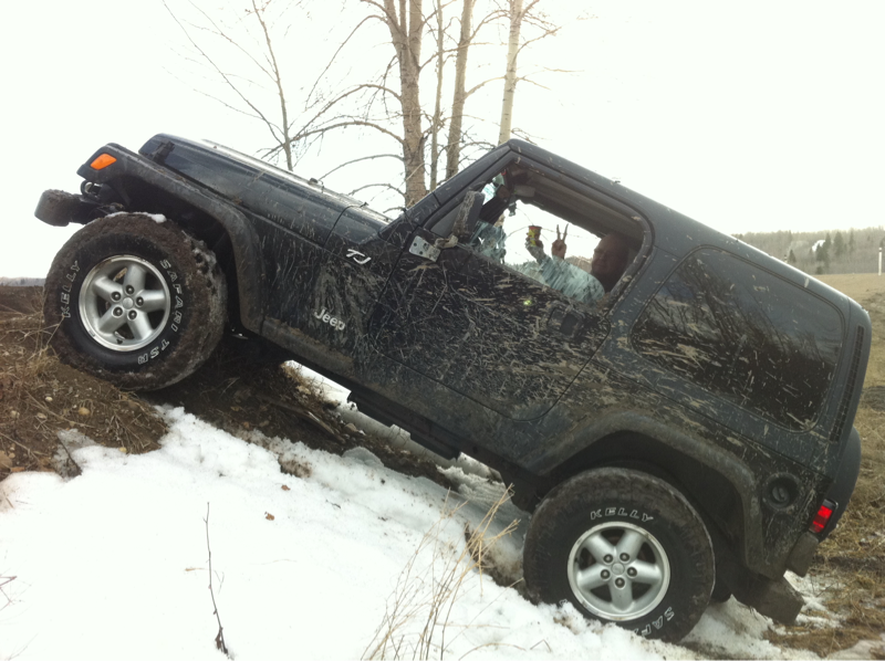

I just put Safari TSR 31-1050-15's on my TJ, the side tread rubs a little bit all full turn, but they fit just fine, and haul ass on the trails!
