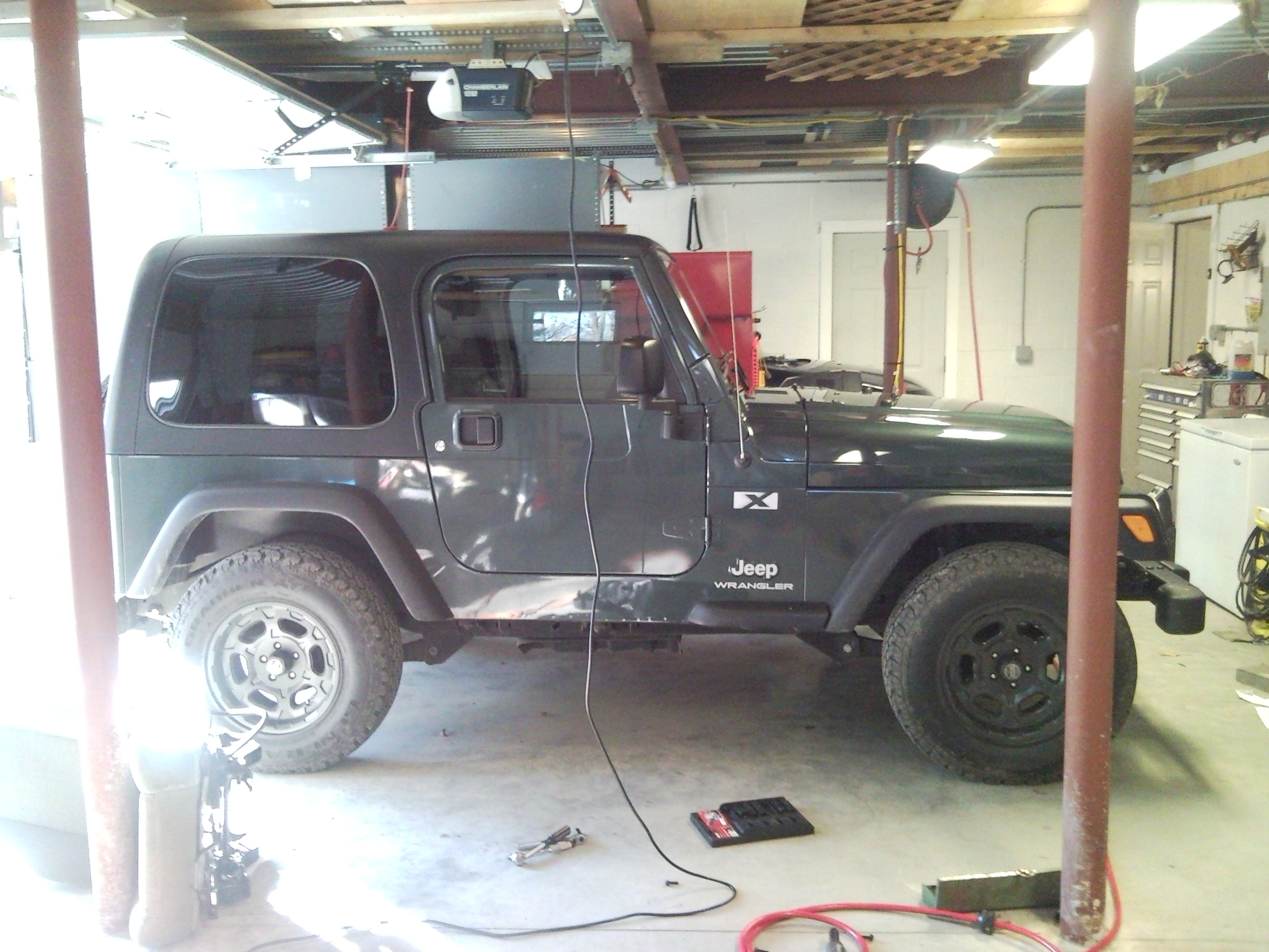

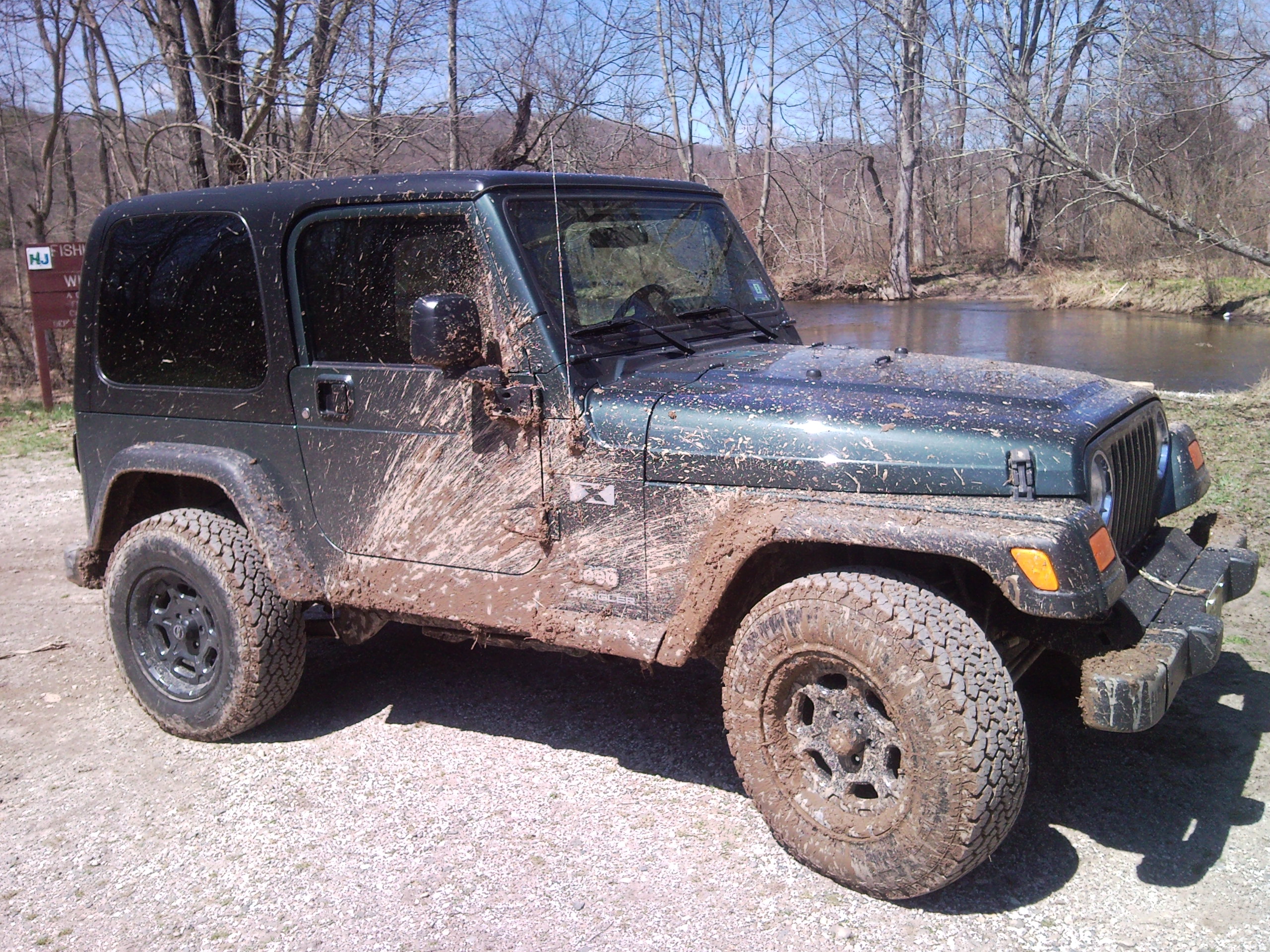

Hey i just put some 31 on my stock 04x. il try to upload some pics so you can see it. personally i want more but that's probably cause im young.
ha cool it worked!
yea thats just new tires and rims, no lift
It provides enough clearance for fun and is still good on the highway, at least as good as a jeep will be.
I did some research and found the rubicon express budget booster, its a 2" suspension lift that will not require brake line extentions or any extra work, at least not for me- it might for the older jeeps.
I like this look! My 92 is very similar to this color and this it pretty much the look i am looking for! Thanks for the pics! Jeep looks great!
