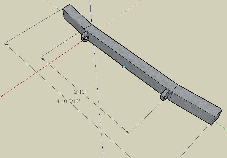

Hey guys probably never heard of me i haven't been on in a few years. The jeep has gotten bigger and i have been ading little things all the time.
But i thought you guys would be interested and i would like some input on the front bumper i am building this saturday

Looks like a good plan! Nice and simple is always a good thing for sure.
How thick and what size will it be? be sure to post up some pics as you go and when you're done
I wouldn't extend the sides much farther beyond the sides of the frame rail, will give your tires a better approach angle when going at obsticles at an angle
Hey guys thanks for the comments and yes, were the line is where the angle starts it goes back towards the jeep the angle is a 22 1/2 degree.
I am building it out of 3x4 tubing the tow points are 1" think and extend all the way through and are going to be welded on the back and front. They will stick out two inches past the bumper and have anglet cut .5" . I have been thinking about also making it an air tank but haven't decided if i do is there anything i should do or any advice?8)

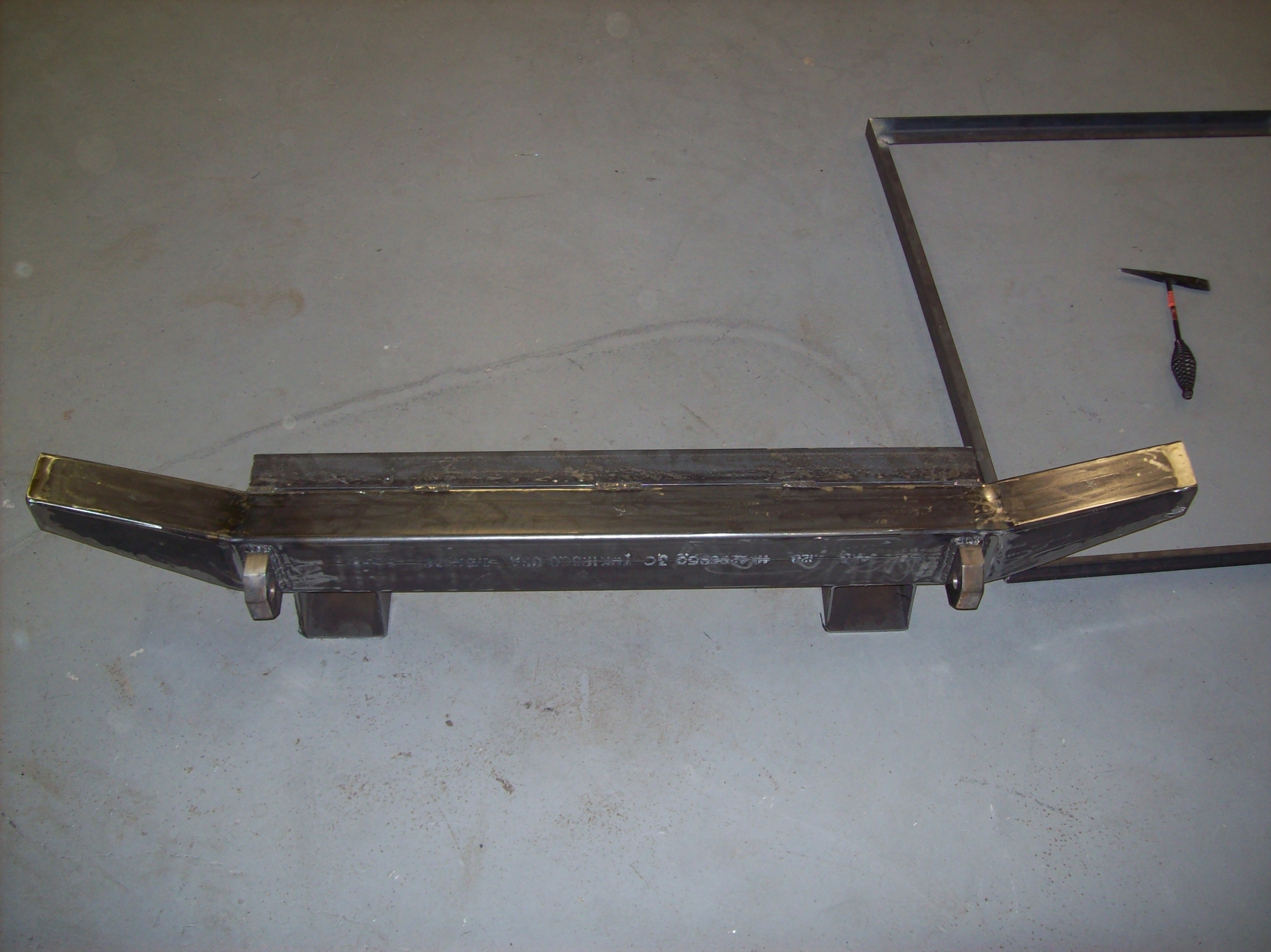

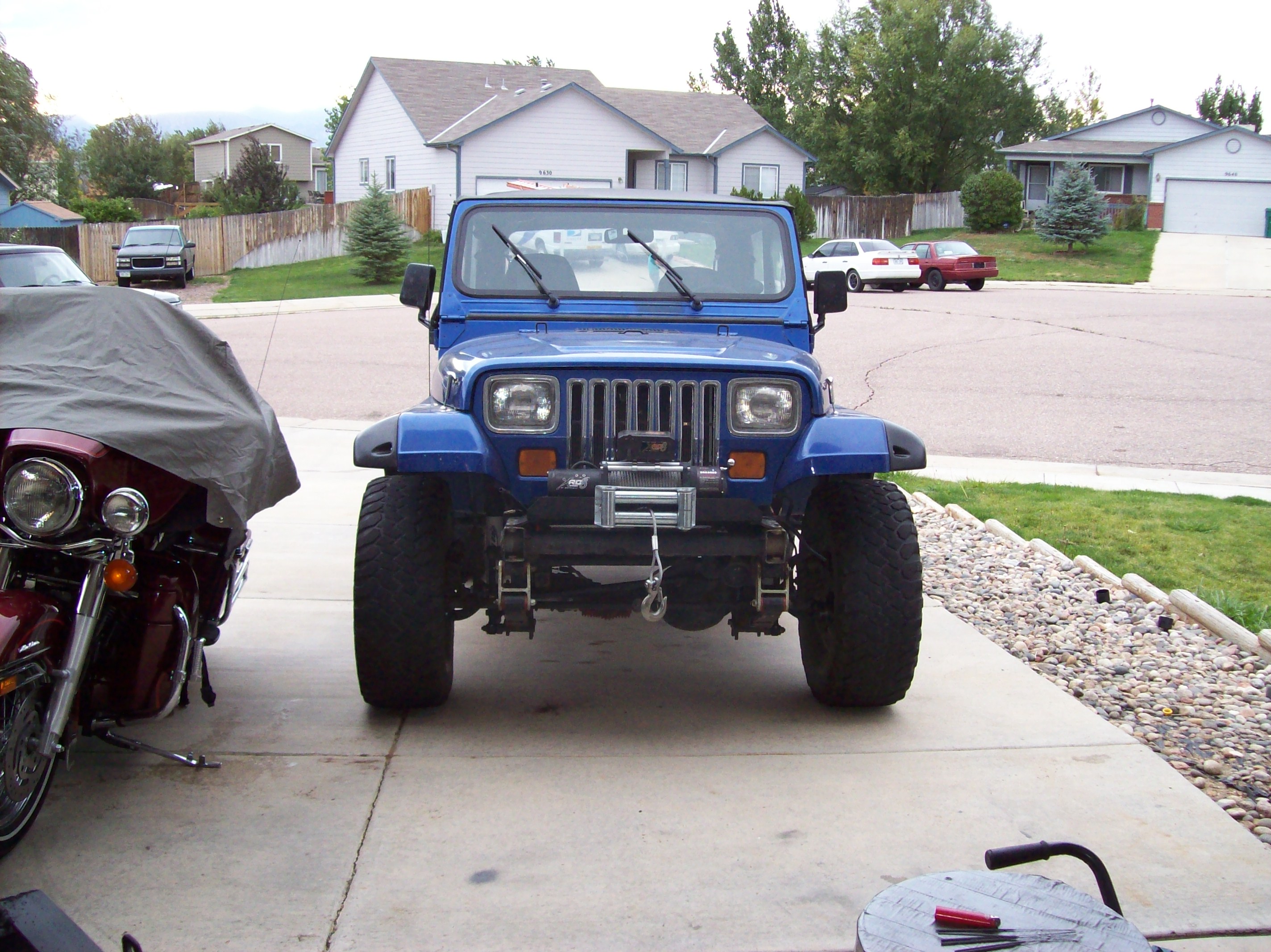

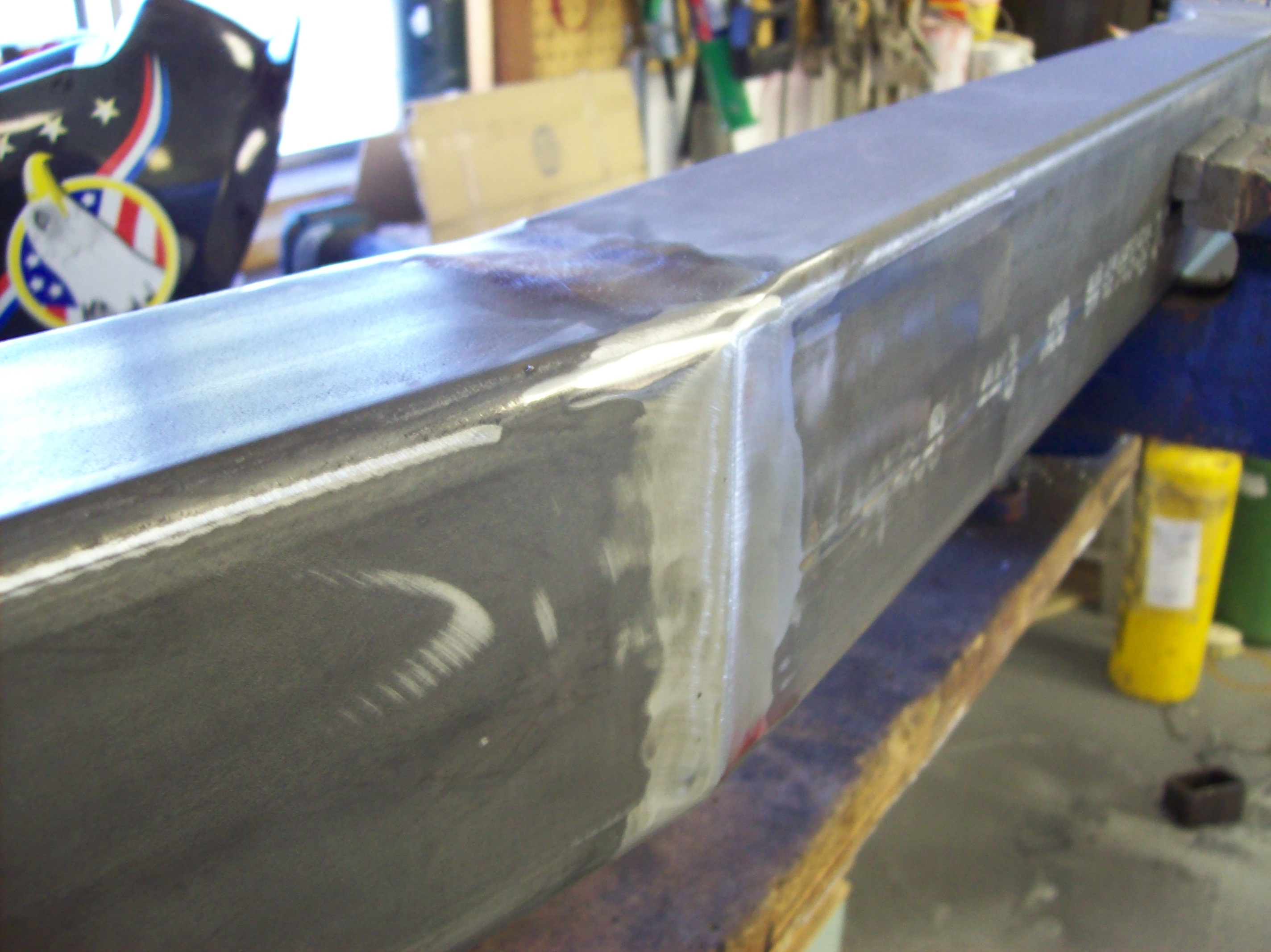

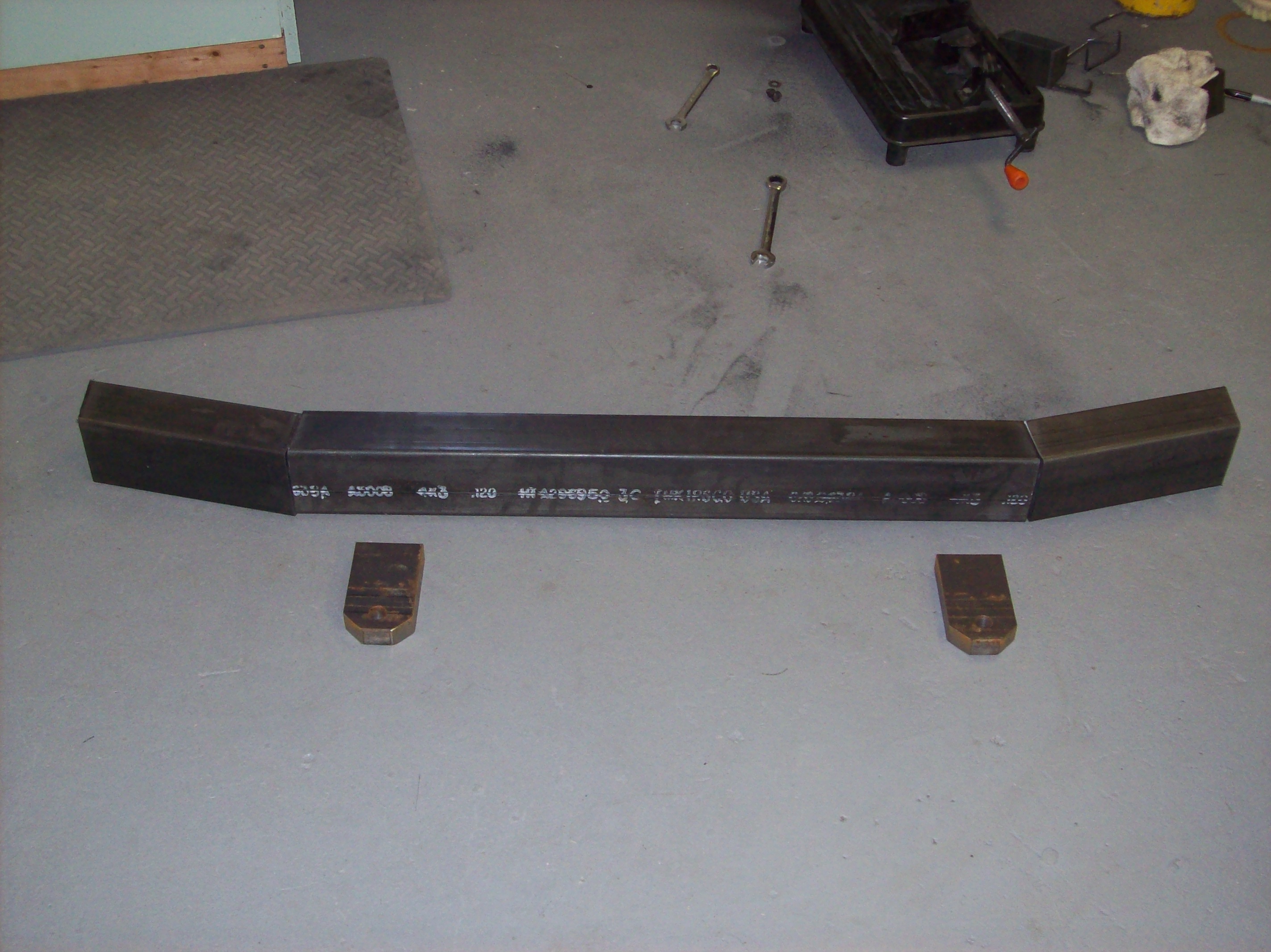

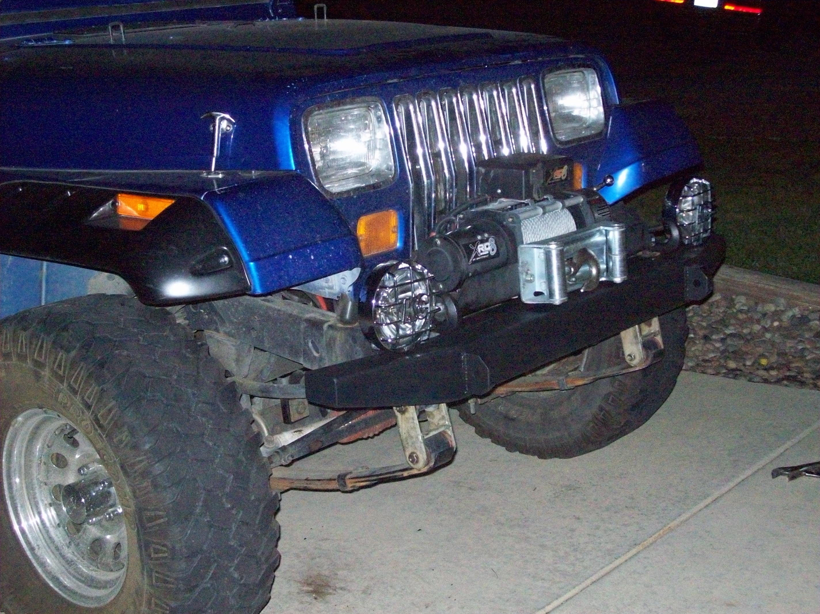

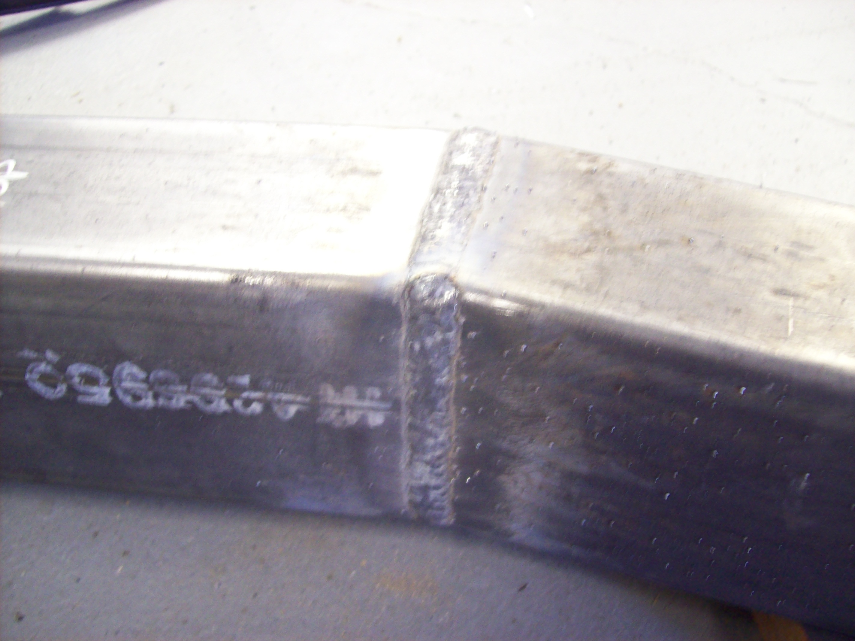

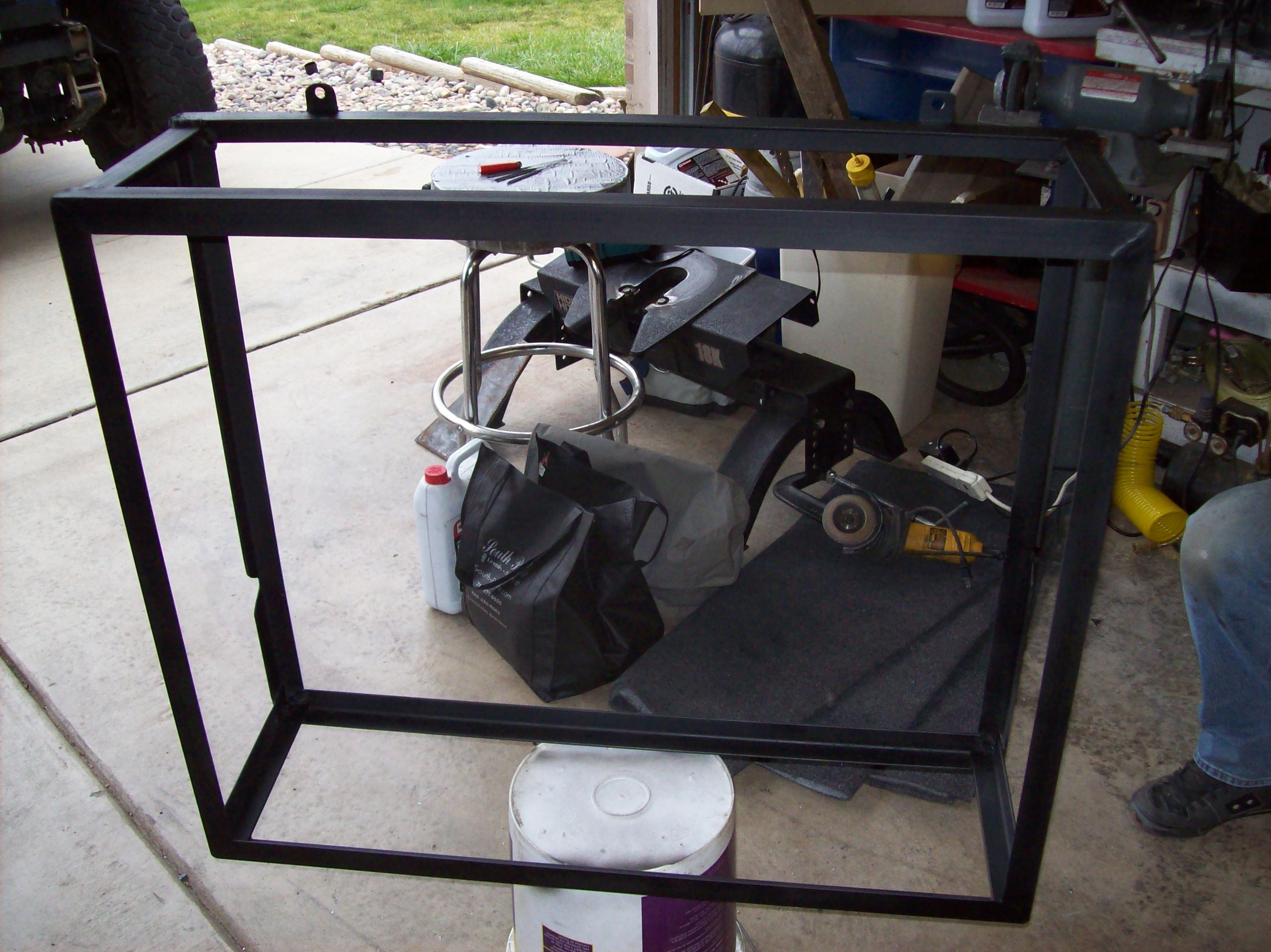

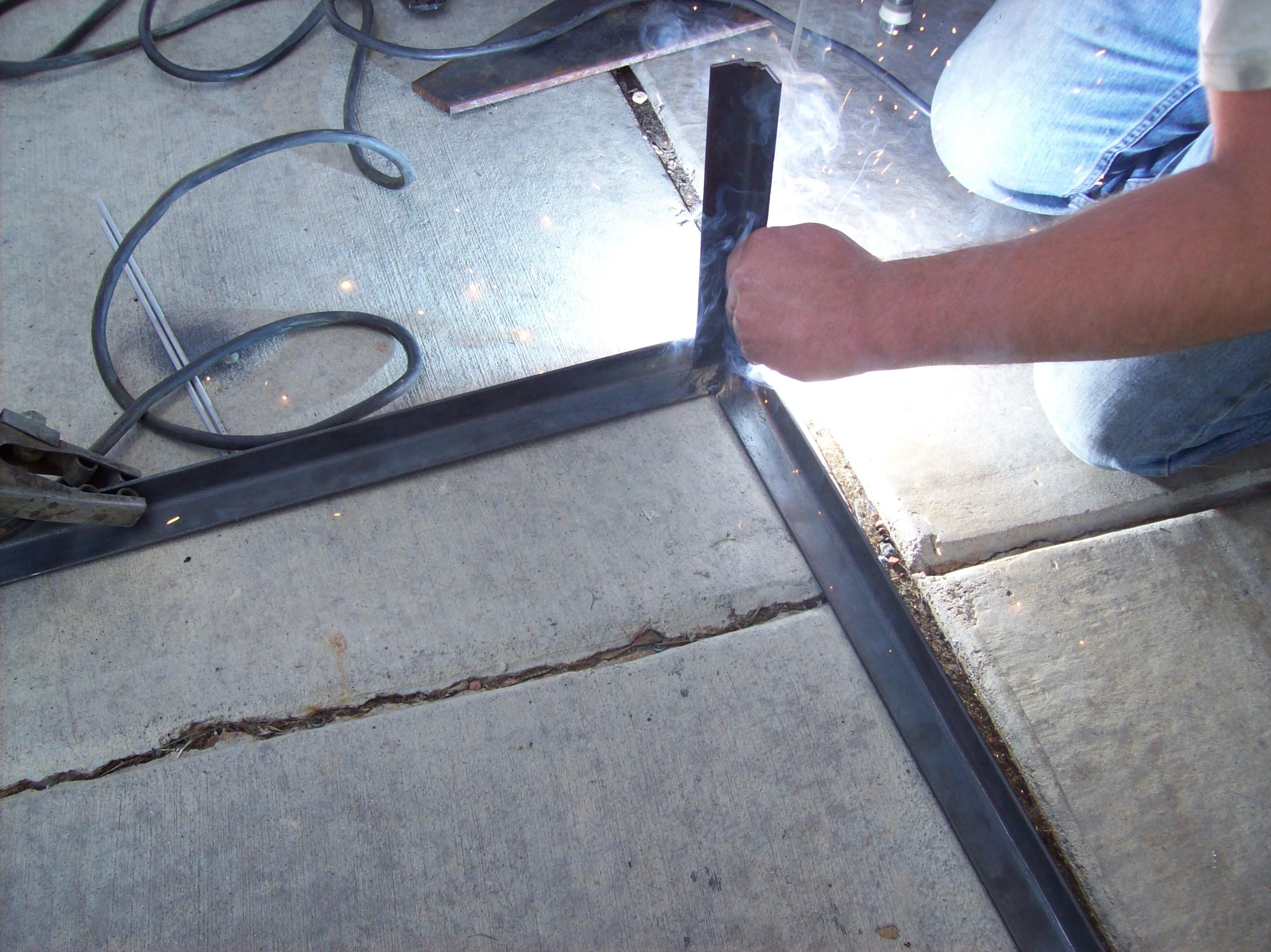

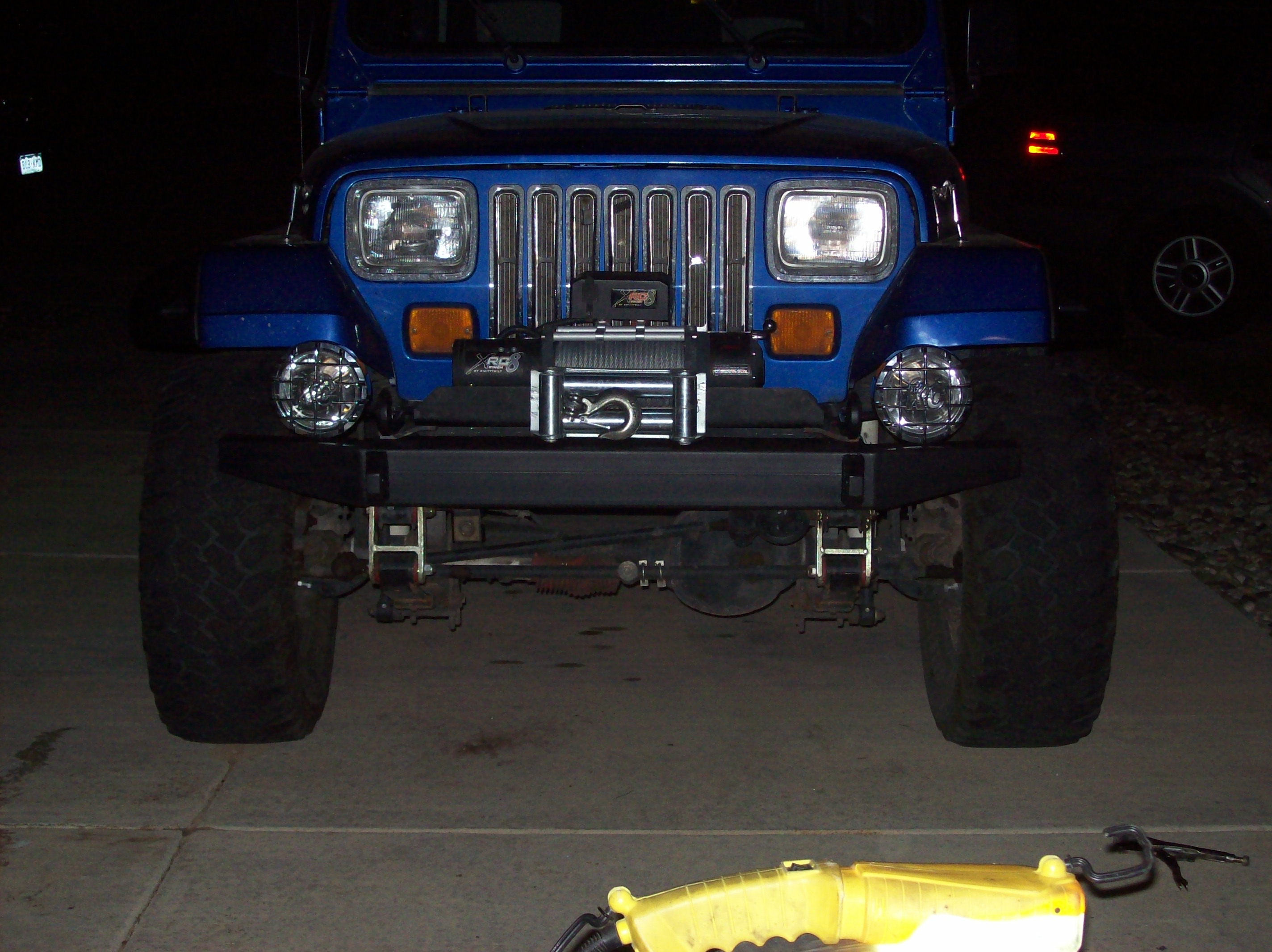

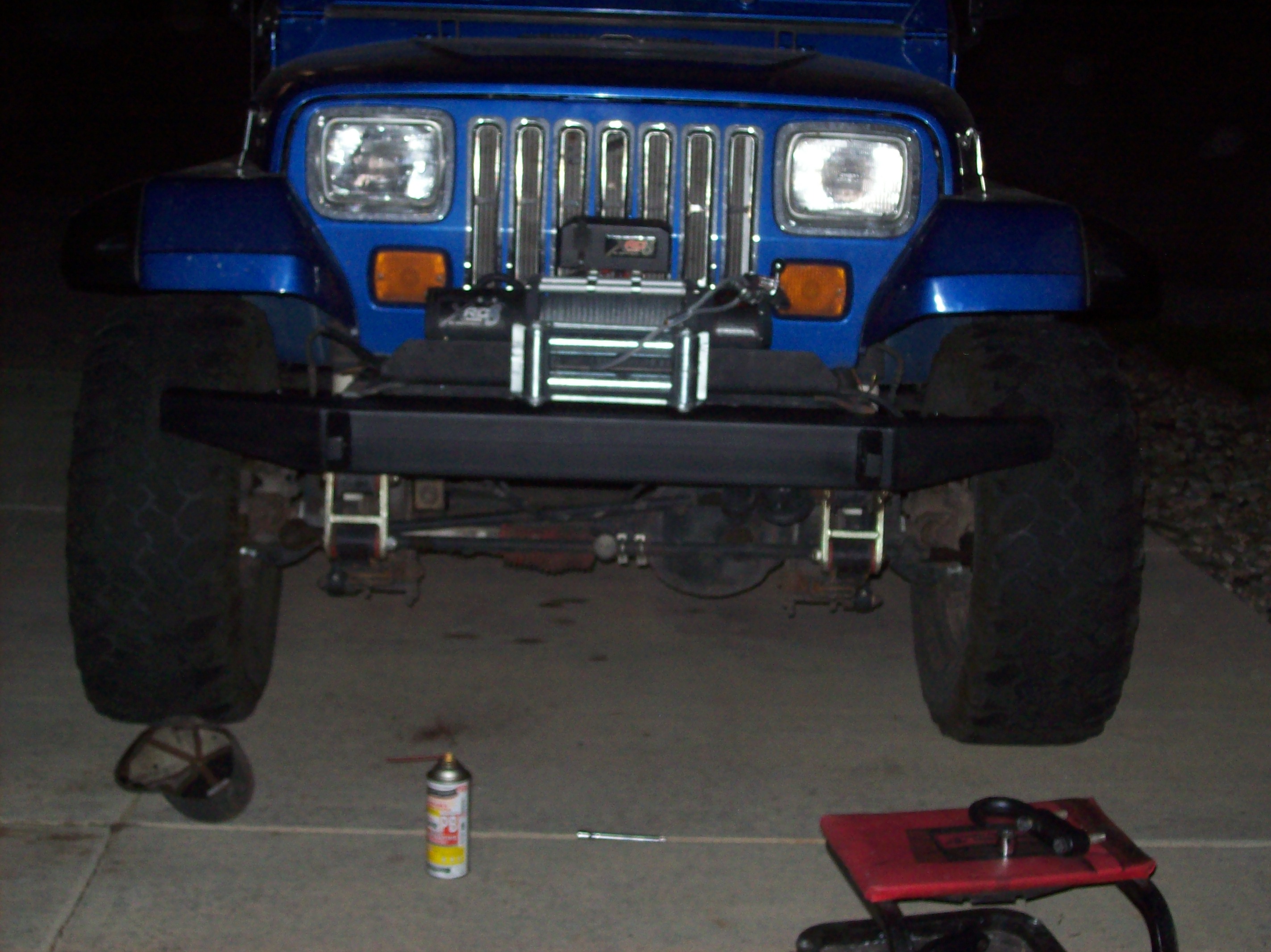

Ok guys after 2 days off and on i got my bumper built and the frame for my toolbox thing8). Here are a few pics.
