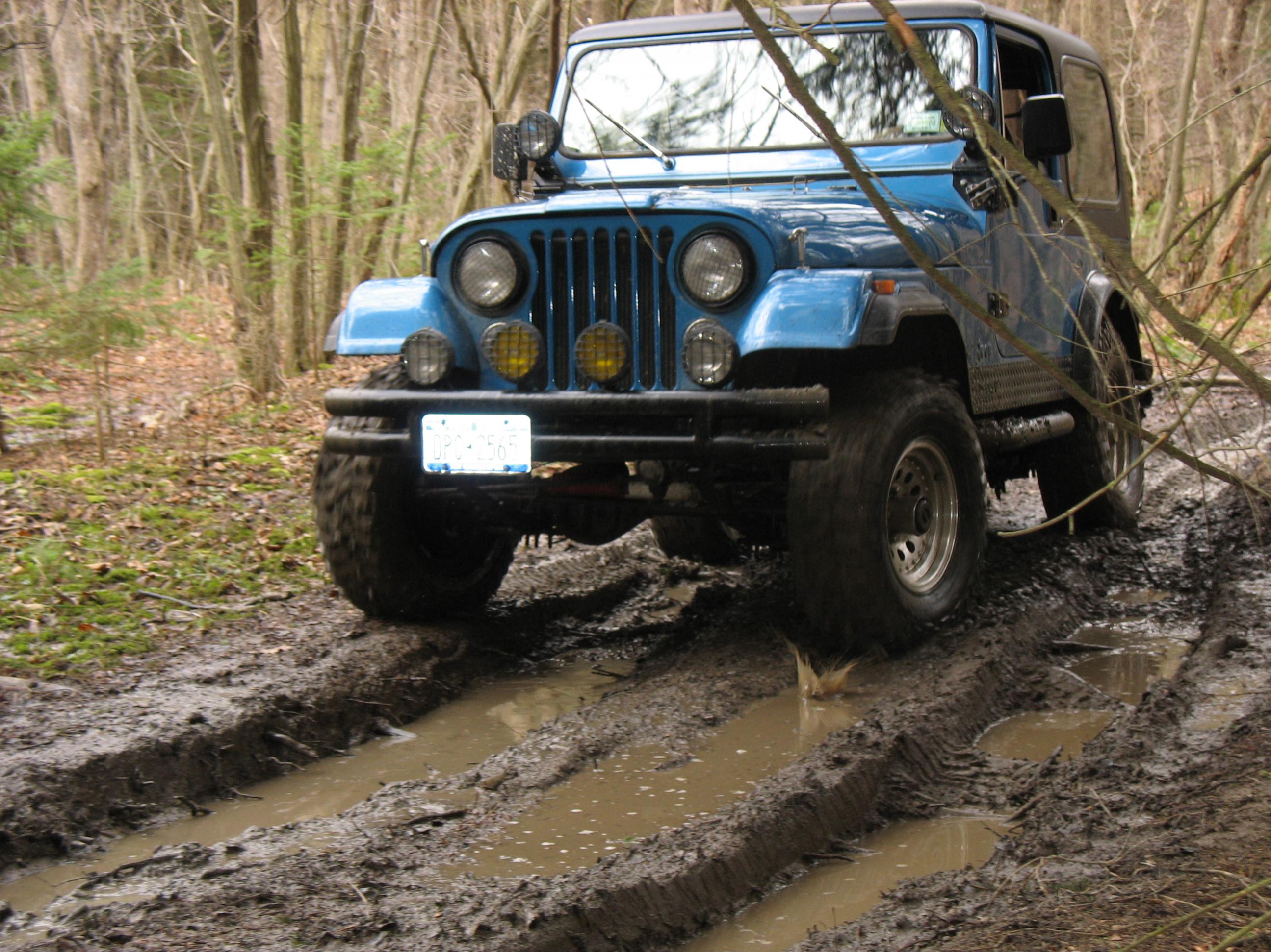

Hello everyone at Jeepz,
I joined last year but didn't log on very often. Joining in hopes of finding someone in my area that had a jeep. I didn't have much luck and then the old '85 started acting up. It's been layed up all winter and I am considering getting rid of it. Hope someone out there can talk me out of that. This is my third jeep and can't picture myself without one. Glad to be back.

Welcome Back to Jeepz..If you sell that Good looki'n Jeep , you will have NIghtmares of Oprah sitting on the hood of your next car., while she eats her Twinkies.:lol::lol:

Nice looking jeep. What going wrong with it? I wouldn't get rid of it, it's not very often one that clean is around anymore.
But post up whats wrong, and someone here will be able to point you in the right direction to get it fixed.
