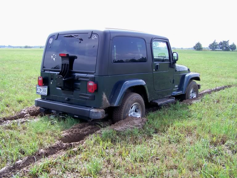

I need to be able to drive on lawn areas without tearing them up and yet be able to get through sloppy conditions without being stuck. After 15 months of using the Jeep for all of our needs, I've buried it three times. Twice I've been able to get out by lowering tire pressure to around 18 psi and rocking it free. Of course I don't want to drive the highway that way. The last time a month ago I had to go get the tractor to get out. The pastures where we hunt can turn to a "gumbo" after saturating rains for several days.

My solution for the sinking on mud was the larger and wider tires. I've had the same issues out in the ranch when certain areas get's saturated with continuous rainfall. It was so bad that the cedar machine(Barko) sank all 4 wheels and had to be yanked out with another 4wd caterpillar. Now i can just skim on top of the mud for the most part while slinging chunks to keep the sipes clean and maintain traction. A lot of the ranchers around here with a stock suspension would just replace the tires with a mud tire of the same size and works getting around in the mushy muddy pastures. That might be a solution for you with a very little sacrifice on fuel economy since the tire would be the same size but a little heavier due to the agressive threads. One word of advice though. As you go on a muddy pasture, if you notice that your starting to get bogged down and your starting to slip, you will need to goose it a little bit to keep it going, however, the down fall is that you'd be tearing up the ground. As a rule, the more contact surface(wider tire) on the ground, the easier it is to keep on top of the ground rather than digging in it(narrow tires).
1, if your only crossing a field like pictured, lower your tire pressure to at least 12 psi, lower if you feel comfortable
2. easy on the throttle, doesn't look like your throttling t, but try 4lo and even throttle.
3. might want to consider a good all terrain tire, I don't think a Mud terrain tire is needed, also, something a little wide, like mentioned, will help.
I'd go with the 31X10.50's and it looks like it's got a decent side biters as well.
the 31's will fit with out any other mods needed. If you can find them, BFG also/used to make a 33x10.5r15 or 33x9.5r15MT these will also fit with no mods.
Looks like it's a toss-up between the Goodrich 31X10.50R15/Cs 109QRWL00606 Mud terrains and Goodyear Wrangler Dura Tracs in the same size. ( Goodyear Wrangler DuraTrac Tire 31/1050-15 in Automotive - BizRate. Compare Prices and Read Consumer Reviews )
