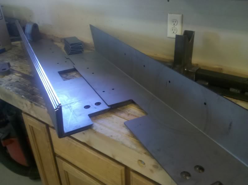

Oh I need to get bumpers and sliders as well:)
