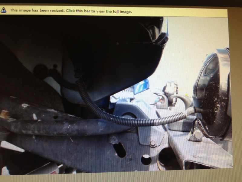

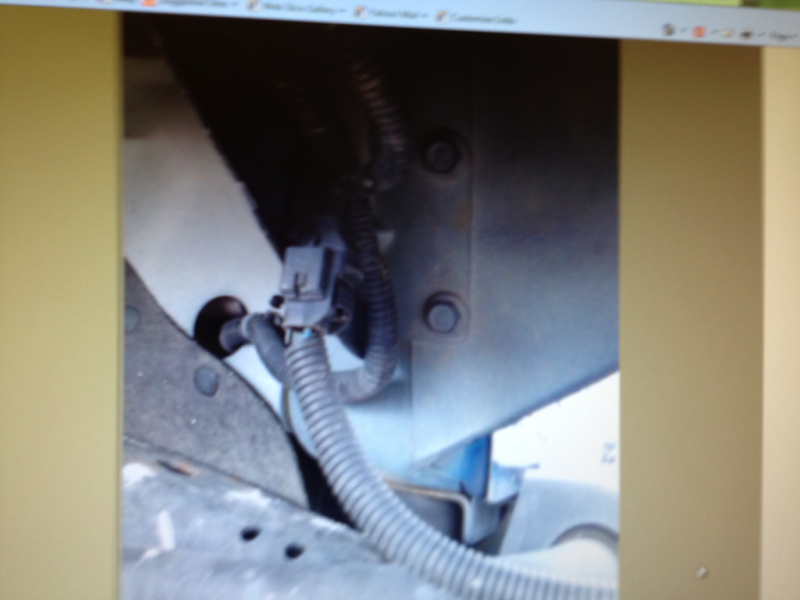

Are all 06 TJ's pre-wired for fog lights? I checked under the wheel well but not sure what I'm looking for. I will have to wire it to a dash switch. I would greatly appreciate a write-up.

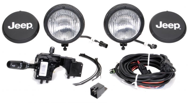

As a side note, Mopar sells some aftermarket kits to let you wire in Factory lights. It's more expensive than just getting some KC lights, but I bet you end up with much nicer looking wiring (heck, it even includes a new light switch for the steering column).
2003 2006 Wrangler TJ Fog Lights Kit Jeep New | eBay
I just went out and looked on my 2005, and there's a fog light connector in the wheel well. It looks the same as the ones in your photos.
I'm surprised that it's there - I've got the base model TJ without fog lights.
