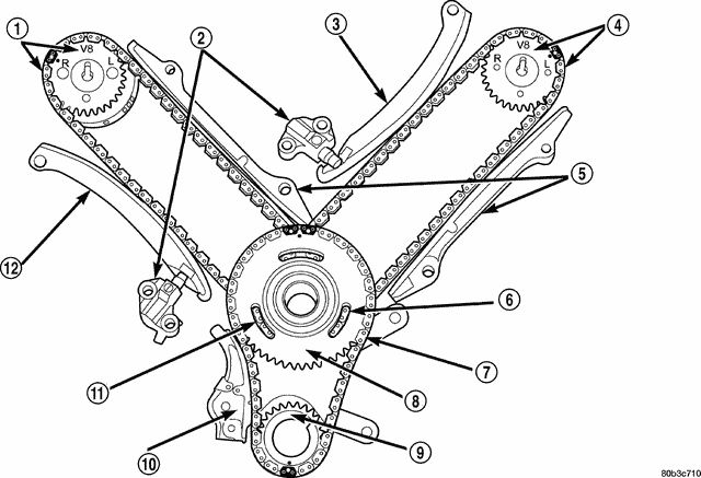

The timing drive system has been designed to provide quiet performance and reliability to support a non-free wheeling</B> engine. Specifically the intake valves are non-free wheeling and can be easily damaged with forceful engine rotation if camshaft-to-crankshaft timing is incorrect. The timing drive system consists of a primary chain and two secondary timing chain drives .
1 - RIGHT CAMSHAFT SPROCKET AND SECONDARY CHAIN 2 - SECONDARY TIMING CHAIN TENSIONER (LEFT AND RIGHT SIDE NOT COMMON) 3 - SECONDARY TENSIONER ARM 4 - LEFT CAMSHAFT SPROCKET AND SECONDARY CHAIN 5 - CHAIN GUIDE 6 - TWO PLATED LINKS ON RIGHT CAMSHAFT CHAIN 7 - PRIMARY CHAIN 8 - IDLER SPROCKET 9 - CRANKSHAFT SPROCKET 10 - PRIMARY CHAIN TENSIONER 11 - TWO PLATED LINKS ON LEFT CAMSHAFT CHAIN 12 - SECONDARY TENSIONER ARM
The primary timing chain is a single inverted tooth type. The primary chain drives the large fifty tooth idler sprocket directly from a 25 tooth crankshaft sprocket. Primary chain motion is controlled by a pivoting leaf spring tensioner arm and a fixed guide. The arm and the guide both use nylon plastic wear faces for low friction and long wear. The primary chain receives oil splash lubrication from the secondary chain drive and oil pump leakage. The idler sprocket assembly connects the primary and secondary chain drives. The idler sprocket assembly consists of two integral thirty tooth sprockets and a fifty tooth sprocket that is splined to the assembly. The spline joint is a non – serviceable press fit anti rattle type. The idler sprocket assembly spins on a stationary idler shaft. The idler shaft is press-fit into the cylinder block. A large washer on the idler shaft bolt and the rear flange of the idler shaft are used to control sprocket thrust movement. Pressurized oil is routed through the center of the idler shaft to provide lubrication for the two bushings used in the idler sprocket assembly.
There are two secondary drive chains, both are inverted tooth type, one to drive the camshaft in each SOHC cylinder head. There are no shaft speed changes in the secondary chain drive system. Each secondary chain drives a thirty tooth cam sprocket directly from the thirty tooth sprocket on the idler sprocket assembly. A fixed chain guide and a hydraulic oil damped tensioner are used to maintain tension in each secondary chain system. The hydraulic tensioners for the secondary chain systems are fed pressurized oil from oil reservoir pockets in the block. Each tensioner also has a mechanical ratchet system that limits chain slack if the tensioner piston bleeds down after engine shut down. The tensioner arms and guides also utilize nylon wear faces for low friction and long wear. The secondary timing chains receive lubrication from a small orifice in the tensioners. This orifice is protected from clogging by a fine mesh screen which is located on the back of the hydraulic tensioners.
NOTE: The blue link plates on the chains and the dots on the camshaft drive sprockets may not line up during the timing verification procedure. The blue link plates are lined up with the sprocket dots only when re-timing the complete timing drive. Once the timing drive is rotated blue link-to-dot alignment is no longer valid.
Engine base timing can be verified by the following procedure:
  1. Remove the cylinder head covers .
  2. Using a mirror, locate the TDC arrow on the front cover . Rotate the crankshaft until the mark on the crankshaft damper is aligned with the TDC arrow on the front cover. The engine is now at TDC.
  3. Note the location of the V8 mark stamped into the camshaft drive gears . If the V8 mark on each camshaft drive gear is at the twelve o'clock position, the engine is at TDC (cylinder #1) on the exhaust stroke. If the V8 mark on each gear is at the six o'clock position, the engine is at TDC (cylinder #1) on the compression stroke.
  4. If both of the camshaft drive gears are off in the same or opposite directions, the primary chain or both secondary chains are at fault. Refer to Timing Chain and Sprockets procedure in this section.
  5. If only one of the camshaft drive gears is off and the other is correct, the problem is confined to one secondary chain. Refer to Single camshaft timing, in this procedure.
  6. If both camshaft drive gear V8 marks are at the twelve o'clock or the six o' clock position the engine base timing is correct. Reinstall the cylinder head covers.

  7. Install both secondary chains onto the idler sprocket. Align two plated links on the secondary chains to be visible through the two lower openings on the idler sprocket (4 o'clock and 8 o'clock). Once the secondary timing chains are installed, position special tool 8515 to hold chains in place for installation .
  8. Align primary chain double plated links with the timing mark at 12 o'clock on the idler sprocket. Align the primary chain single plated link with the timing mark at 6 o'clock on the crankshaft sprocket.
  9. Lubricate idler shaft and bushings with clean engine oil.
  10. Install all chains, crankshaft sprocket, and idler sprocket as an assembly . After guiding both secondary chains through the block and cylinder head openings, affix chains with a elastic strap or the equivalent, This will maintain tension on chains to aid in installation. NOTE: It will be necessary to slightly rotate camshafts for sprocket installation.
  11. Align left camshaft sprocket “L” dot to plated link on chain.
  12. Align right camshaft sprocket “R” dot to plated link on chain. CAUTION: Remove excess oil from the camshaft sprocket bolt. Failure to do so can result in over-torque of bolt resulting in bolt failure.
  13. Remove Special Tool 8515, then attach both sprockets to camshafts. Remove excess oil from bolts, then Install sprocket bolts, but do not tighten at this time.
  14. Verify that all plated links are aligned with the marks on all sprockets and the “V8” marks on camshaft sprockets are at the 12 o'clock position . CAUTION: Ensure the plate between the left secondary chain tensioner and block is correctly installed.

  19. Rotate engine two full revolutions. Verify timing marks are at the following locations:
    • primary chain idler sprocket dot is at 12 o'clock
    • primary chain crankshaft sprocket dot is at 6 o'clock secondary chain camshaft sprockets “V8” marks are at 12 o'clock
