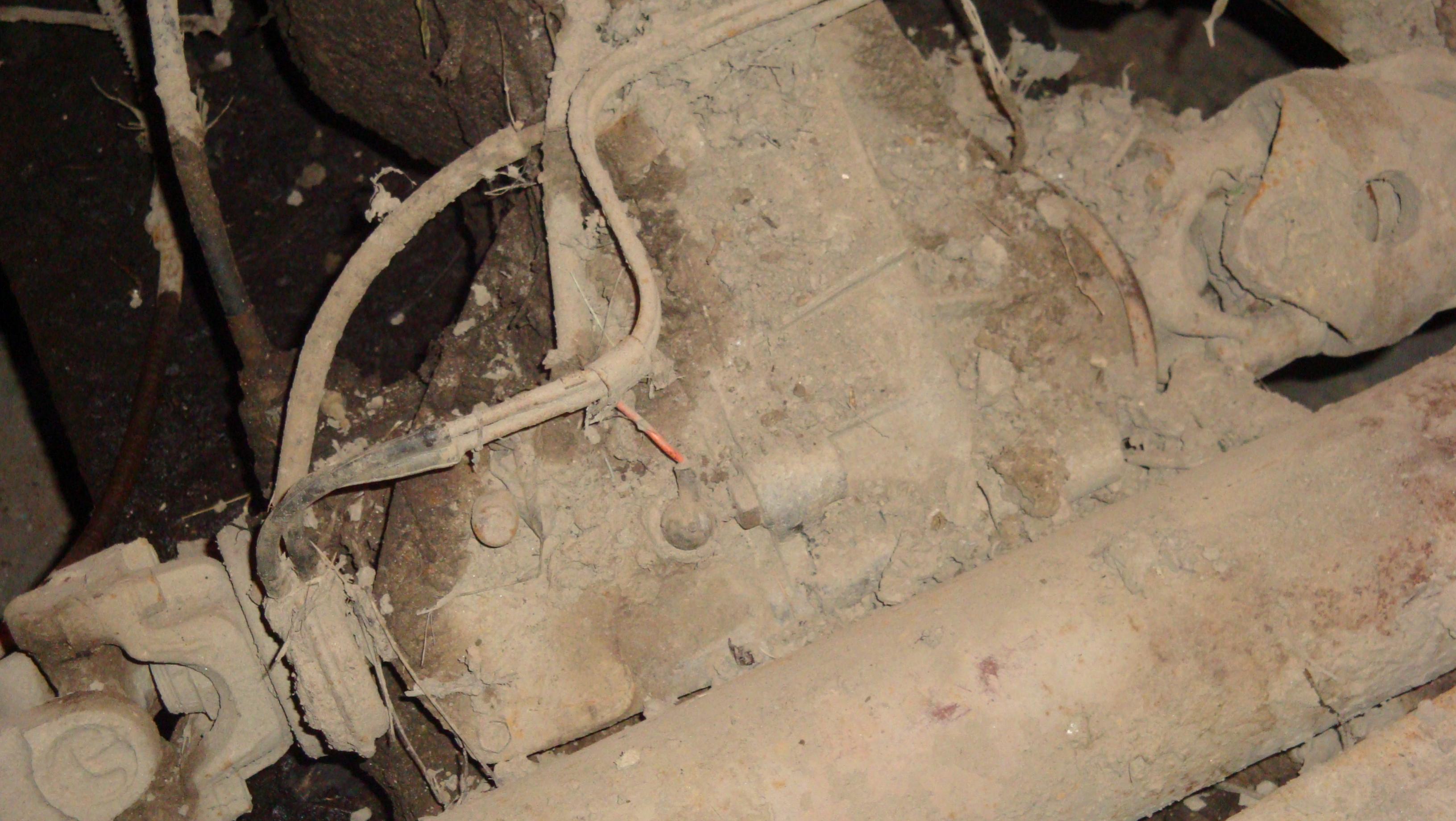

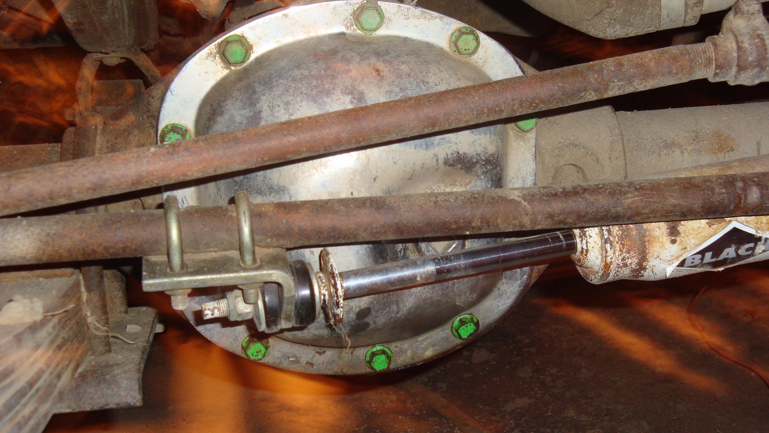

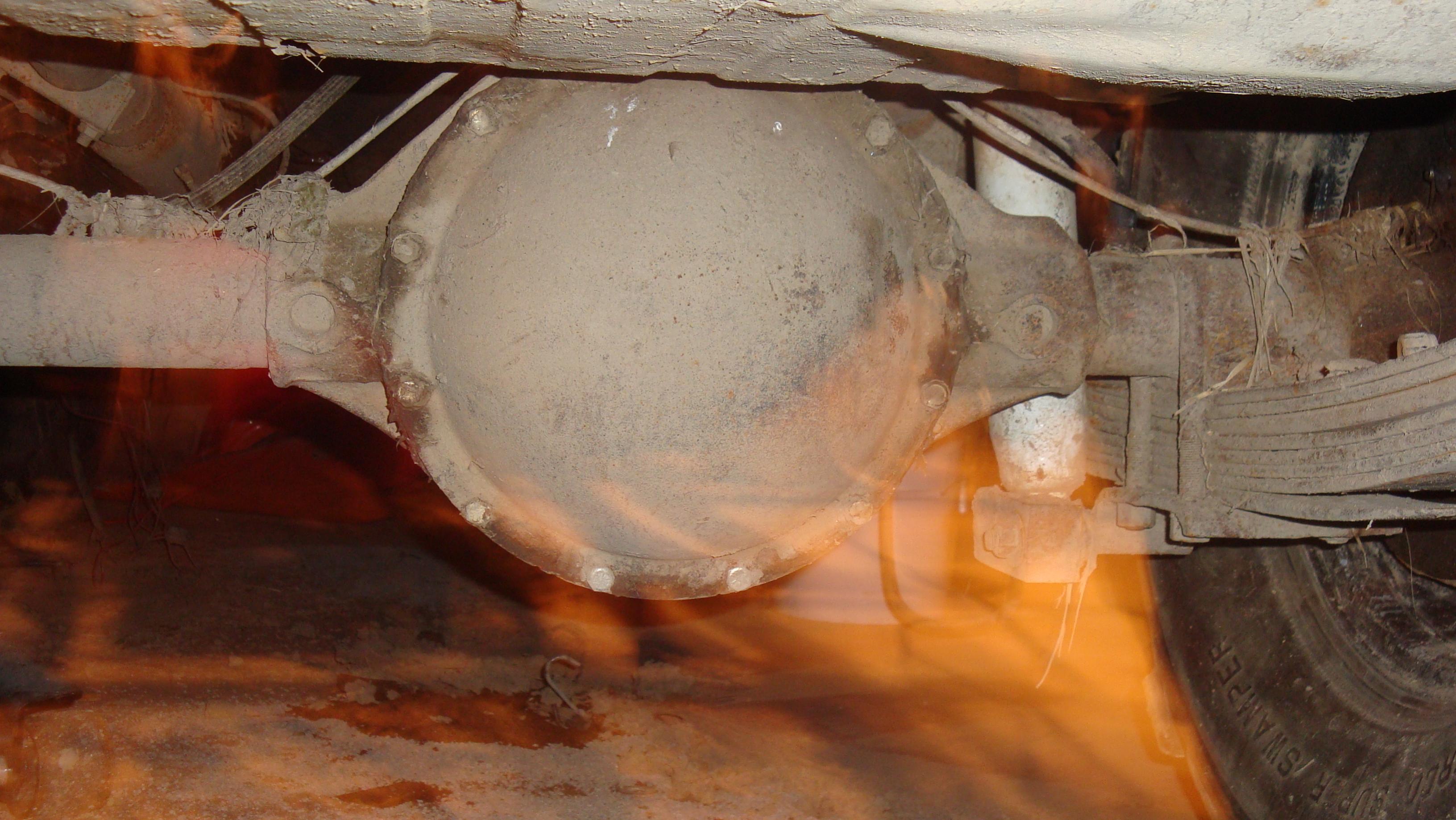

does any one know what kind of axels these are and how to identifiy the what kind of transfer case i have

AMC20 at the rear and a Dana30 mounted up front.
T/C no clue!
Then it won't be cheap much longer...
As to the T/C is it divorced or is it mounted directly to the trans?
i belive it bolted direct to the trans not sure what devorced means
Divorced would indicate that the T/Case would be separate and apart from the transmission. I can't make out the alignment in the image.
Best of luck to you with your build, and welcome to this forum. Great folks here. Someone will do better than I with it's ID.
Most Dana axles have the model number cast in the web at the top right of the diff case. So the front should have a 30 cast on it.
The Dana 300 was used from 80 to 86 so the TC may be a 300. (that's a good thing)
Rear axle is an offset AMC20 so you have the Quadratrac full-time transfer case.
OH, that's the one with the clutch assemblies in the TC. If you don't do a lot of wheeling it will start clunking in turns and you cure it by pulling figure 8's front and back until the clutches lube up and it stops clunking. I had to do that on my '77 J20 when I first bought it. It either has to be wheeled or figure 8'd about once every 6 mos or so. I got that truck in '79 at a steal because of it. Awesome system but poor fuel economy.
i guess i should have said this earlier but it has a 350 with a th400 trans not sure if this make a dif on the t/case but it appears to be bolted directly to the trans
