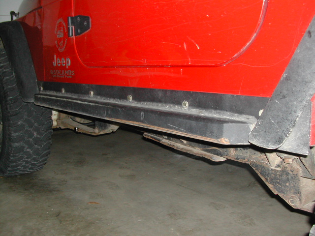

Here's mine built from the same material:

I mounted mine through the sides of the tub in 6 places and have 4 places through the bottom as well, It came with spacers and seemed to add quite a bit of strength over just the side mounts when encountering out and up forces

I havent had any problems though I dont use it as a pivot as some do, more of just body damage insurance. Seems that most of the rubing occurs closer to the edge or on the bars instead of closer to the frame. I got mine from 4X doctor (http://www.fourxdoctor.com/) and they seem to beat the crap out of em and dont have any problems. If it was a problem for ya you could go with a carriage bolts instead of hex heads, though I dunno what sort of equipment you would need to make the square hole.
