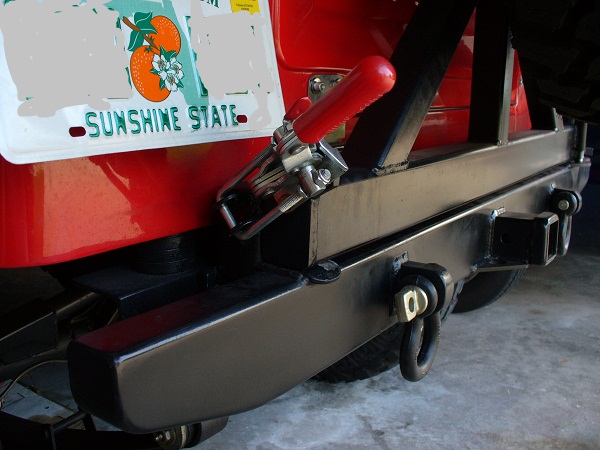

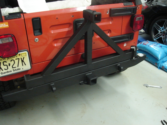

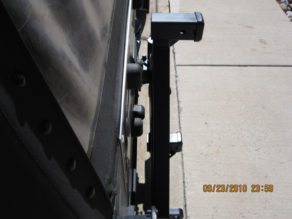

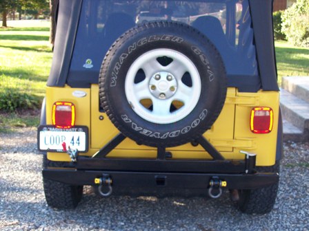

Here are some examples of a tire carrier:
