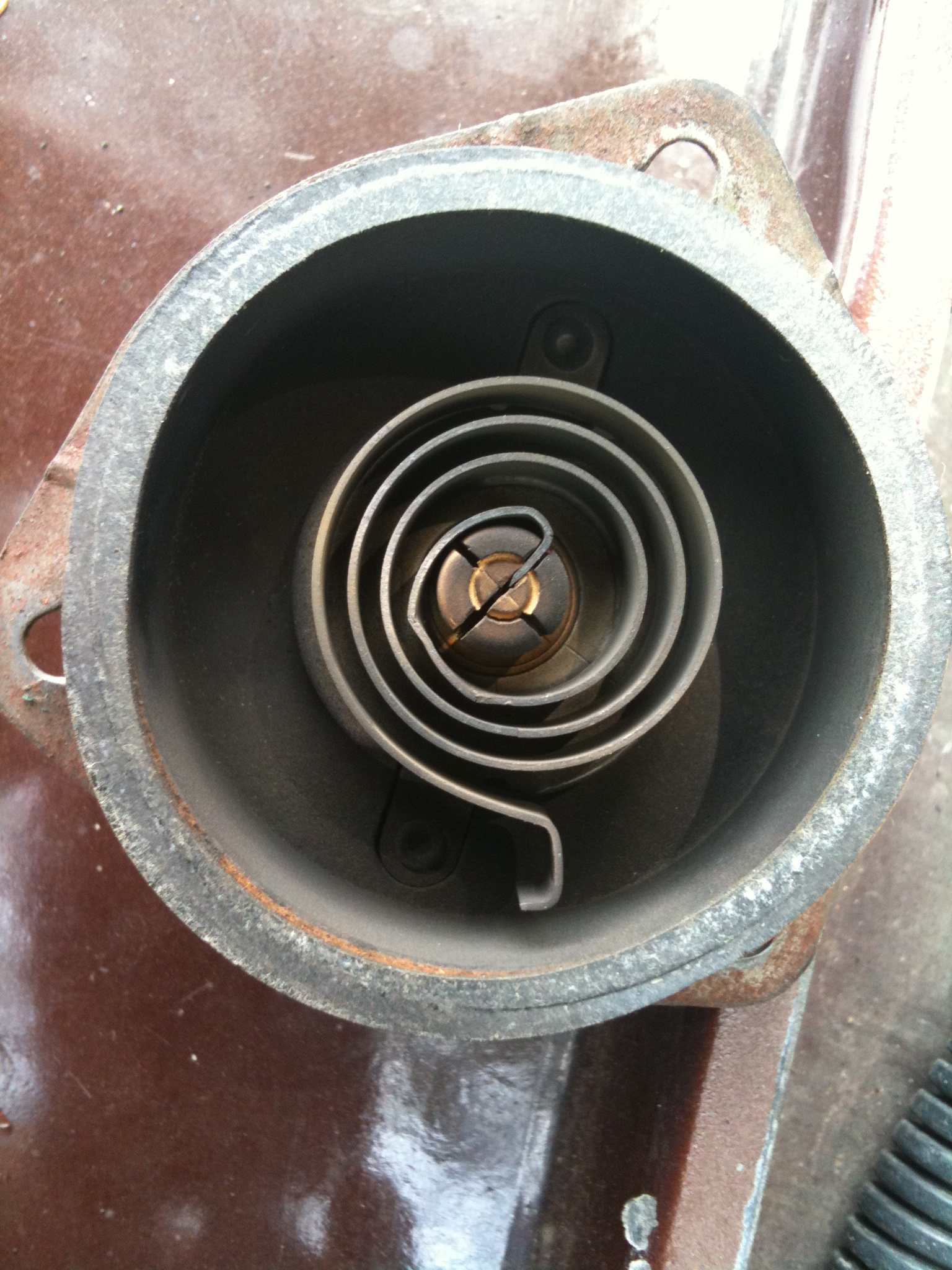

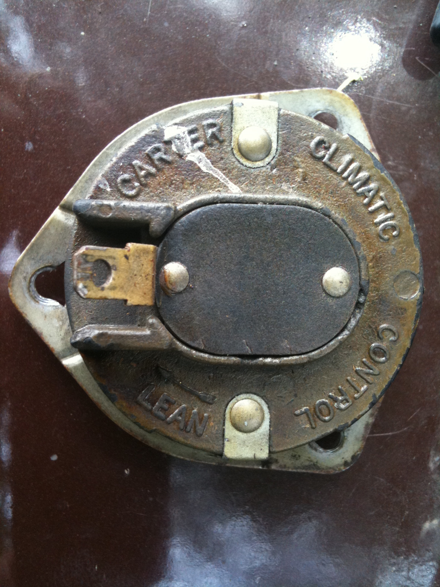

Here's a picture of my choke spring. It just has a hook bent on the end, but no fastener. That hook goes over the choke shaft and I guess the tension on the spring causes the choke to open and close.
I heated up the engine then removed the choke cover with spring and marked its position. Then I tossed the spring in the freezer and marked its position after it cooled off. So, I think I know the spring's range of motion.
Now that it is adjusted 'correctly', I need to see if the motion of the spring actually moves the choke plate. My guess is that the choke is sticking open and the spring tension is not able to close it. I hope to be able to tell when looking at the cold engine in the morning.
Sound right?

Let the Jeep cool. Loosen the the 3 screws that hold the choke bracket and rotate the choke housing until its at 1/8th or little less. After you twist it (not too much at a time a little equals a lot) flick the throttle so the choke will snap to it new setting. So its twist, flick, check gap. Also on the choke spring housing should be an indicator that lines up with graduated lines on the side where the housing mounts. And the most important step ( I found out the hard way) make sure you tighten the 3 screws. A little eng vibration may not be much to you but that housing dances to it....lo
